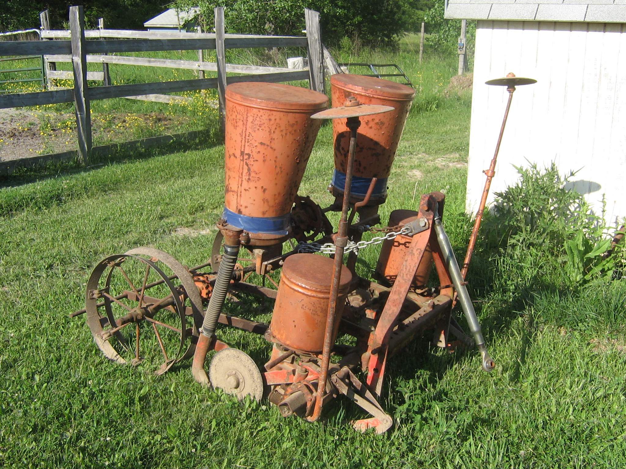

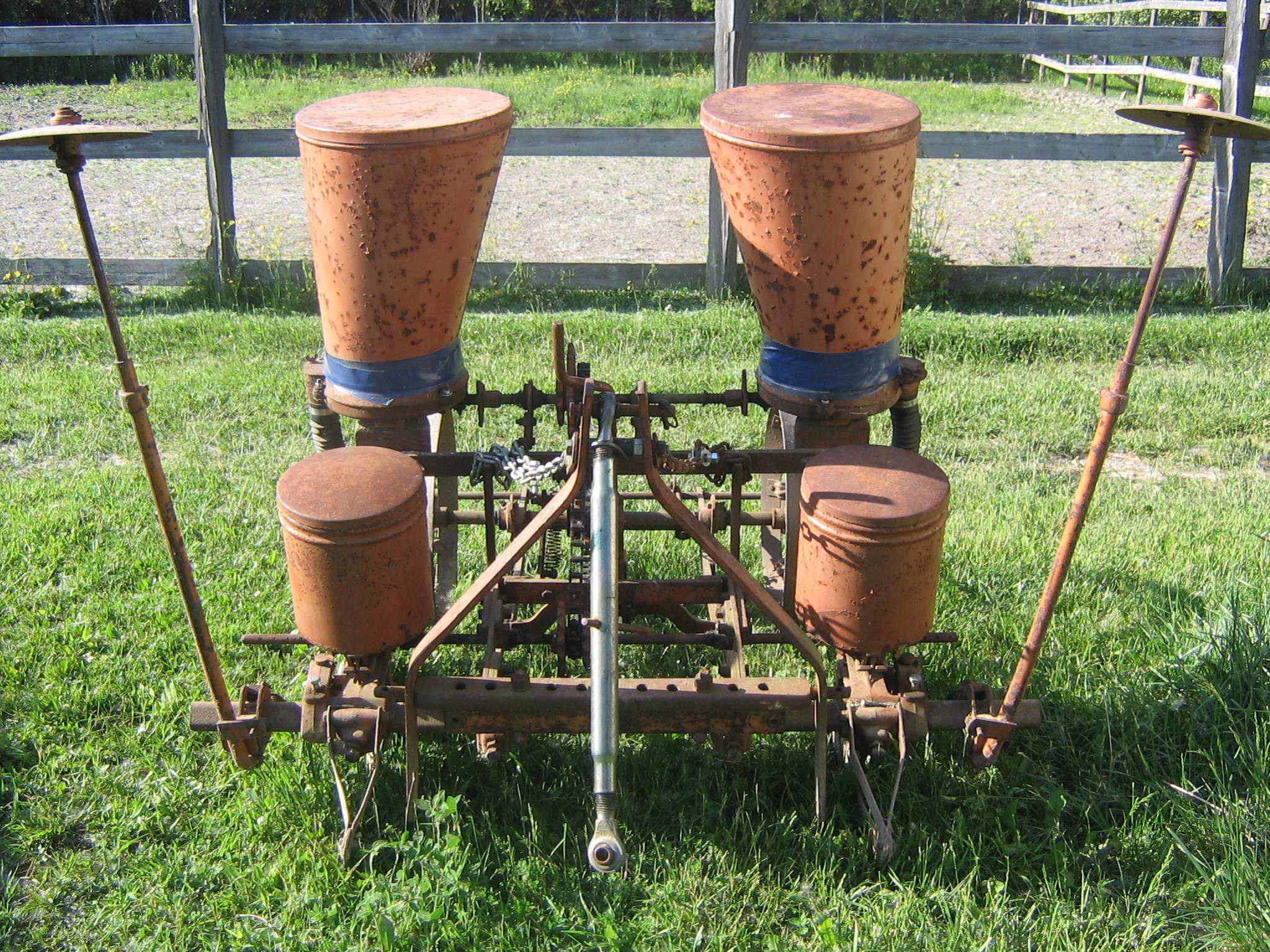

I have an Allis Chalmers 2 row snap coupler planter that looks different than yours. It has seperate fert opener disc that go along the seed row. It also has markers to follow the center of the row for the next pass. Didn't realize there were so many differences. I'll try to get a picture on here to show ya. Just used it to plant field corn yesterday. Trac
   / Allis Two Row Corn Planter #23
Excuse the rust and duct tape but this thing really gets used.
