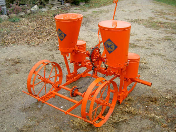

I just made an impulse purchase on an Allis Chalmers two row corn planter. I have had my eye out for quite some time for a planter in good condition at a reasonable price. I was really looking for a John Deere but I ran across this and the price seemed to be okay. Does anyone have experience with this planter?

We had 2 of them in the sixties that we eventually built a toolbar and made a four-row mounted planter out of them. You can aquire plastic 24 cell plates to put in inplace of the steel plates, if that's what is in the planter now. They are fairly accurate and stay in the ground well, but the runner-type opener is best used in conventionally tilled soil, meaning plowed with a bottom plow or rototilled. They will not work well at all with surface trash where the ground was chisel plowed or if you are trying to no-til. The fertilizer attachments were notorious for rusting out, even with end-of-planting cleanout with water and compressed air and applying diesel fuel or light oil to the inside. We solved that problem by switching to liquid fertilizer with saddle tanks on the tractor. We got plastic plates at the A-C dealer and seed dealers and amassed quite a collection, as I upgraded to the #71 disc opener unit on a no-til frame and did much custom work over the next 16 or so years. The #71 unit was similiar to these old units, but were the disc opener type. We were able to plant at about 3.5 MPH with that old planter and get a good consistent seeddrop. I see yours has already been converted to 3 point hitch. They were originally snap-coupler. If you were fortunate enough to get the owner's manual, it will tell you the different sprocket settings to determine planting population and fert. amounts per acre. They are a nice, simple planter to maintain and operate. Looks like you got one in excellent shape!

They are fertilizer boxes and not insecticide correct?
/ Allis Two Row Corn Planter #4
Yes, they are fertilizer. When the planter was built, insecticide boxes weren't available. The only ones you will see are add-on Gandy boxes, which are red, added on in the seventies and chain-driven off the main shaft with an added sprocket. My 1973 A-C planter had A-C insecticide boxes, but they were made for A-C by Gandy. We spent alot of time with the fertilizer boxes. Even with all the storage prep we did, we would still have to work to loosen them up before planting the next year. Be sure they'll turn over before you put fertilizer in them next Spring, or you'll have to empty them and loosen the mechanism up so it turns when the planter drive wheel turns. If you choose to wait til the soil temperature is over 50 degrees and not apply starter fertilizer, you could take off the pintle chain that drives the fertilizer attachment. That's how we disabled them when we converted to liquid starter.

The orange ones must not be all that much better than the green ones. There are not near as many of them around. I have a similar deere model 246 that I have used for the last 20 years or so, and the fertilizer attachments have never bound up. All I do is wash it out good with a hose when I am done planting and let it dry out good before putting it into storage. It sounds like the fertilizer attachment was far more trouble prone on the allis than the deere. I would never consider a 2-row planter without a functioning fertilizer attachment (dont get fooled by the insecticide applicaters passed of as fertilizer attachments on lots of model 71's. If the hopper is smaller than the seed hopper, it is not for fertilizer).

hello i just bought a allis planter just like this and i cant find a model number or anything to buy plates. can anybody give me a model number for this.
#11
I never found a model number either, but I believe it is just known as a snap coupler planter. I just ordered plates from Lincoln Ag Products, you can find them on the web. I sent them seeds I was planting and they picked the plates that were correct.

ITs prob a WD style rear mount. It might have a snap coupler hitch. Many were four row and cut down to two row models. .Lincoln Ag products should have the plates and adaptors. They are suppose to use thesame ones that old JOhn Deeres used. . I do have a manual for one I was given. I got mine for food plots for the deer and quail and am looking for some wheat , milo ., sunflower and turnip or sugar beet plates my self.
