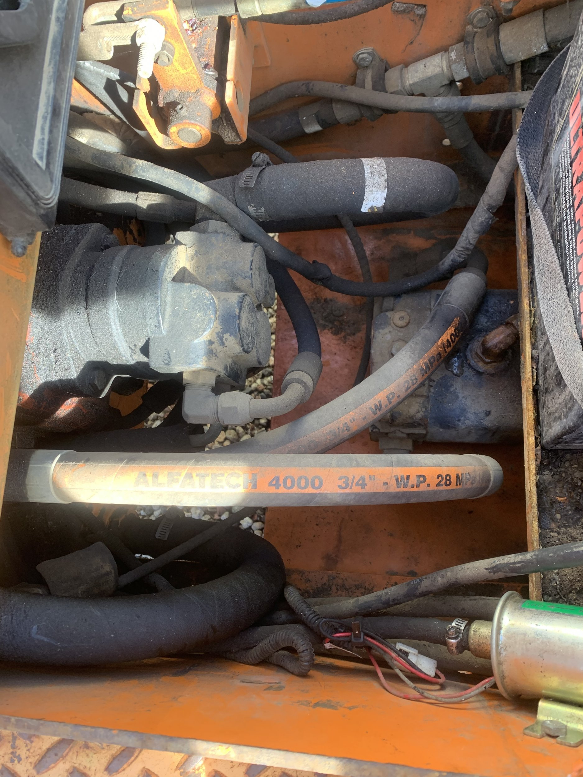

Anyone here with an Allmand 425 or 535 backhoe I'm looking for the Eaton number off the gear pump and maybe a picture or two.
I'm thinking someone installed the wrong pump in mine.

I'll check my 535 tomrw I think it's an Eaton 72400

Cant really get in there for better shots

That looks like it I'll order a seal kit and see if that helps my weak loader/hoe.

I drained the fluid and removed both strainers and installed new filters and replaced with new fluid.
It drives back and forth great. The steering works great but loader and backhoe work but are weak.

check that the relief valve isnt stuck. I dont know how to do that but it is one of the troubleshooting steps in the operaters manual

The seal kit is to arrive tomorrow and hopefully it has the Orings for the load sense valve in it.

When u pull that out is there any check balls or springs that come out with it.
   / Allmand TLB
#15
It came out as one piece but I can see inside it has what looks like a valve of some sort.
I found the oring seal kit for it but also found a complete valve so new valve is on it's way.

9900205-000 seal kit for the pump
Eaton 202914-921 SICV Accessories Seal kit
02-199283 Priority Flow Cartridge Valve

I installed the new parts but the loader and hoe are still weak so I installed the gauge at the loader and only getting about 1200 psi, I'm thinking it's the rear wear plate that is not part of the kit and maybe not obtainable. I have sent out an email to Applied to get more info.
