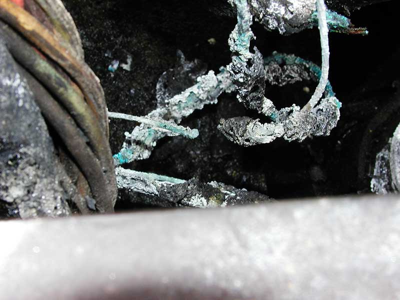

I know this thread is pretty old, but I just had a situation that could be related to the fire I had last year. Day before yesterday, my son and I were in the shop looking for something when the PT, that was sitting out in the yard, started to crank all by it's lonesome. Like some ghost wanted to go for a joy ride. Kind of scary having the rouge PT running around snapping at folks with the grapple bucket.Anyway, after the dumb stare my son and I gave each other for a couple seconds, I scrambled to find a wrench and disconnect the battery cable. I actually bought a disconnect switch last winter after the fire. It's hanging on a nail in the shop and I think I'm going to get it installed this time, right after I get the PT on my insurance policy which I have been meaning to do for some time.
I did a little on the spot trouble shooting and determined that the start relay was being energized from up stream toward the ignition switch. The tractor had been sitting out in the heave rain for a couple days and once I got things dried out there was no more problem, so I'm pretty sure short was caused by moisture , probably in the ignition switch. I wonder if that can be replaced with one that's more weather proof. I'll check right after I get that disconnect switch installed, lol.

That is strange that the fire has started from starter sol. I have a 1430 with 70 hours on it and when I shut it off to go to lunch it started all by itself and actually ran( I left key in it). Also the other morning i woke up and the starter solienod was trying to start the motor (No key in ) and drained the battery. When I leave it unattended I unplug battery leads. Did any of you have these problems before fire?

Wow, this is very interesting. The investigator who investigated the fire in my 1845 pointed out that the start wire to the solenoid was carrying current when it burned through (evidenced by a "blob" of copper at the severed ends). We never did figure out exactly why that wire would have been carrying current, at least not to my satisfaction. To this day I don't know definitively what caused the fire. I hadn't experienced the "self-starting" prior to the fire (I was out mowing when she took fire) and it just didn't seem reasonable that it would be "self-starting". I didn't hear anything over the noise of the engine any mower but your experience makes me wonder....
I haven't had this happen since I rebuilt the tractor after the fire but I most likely replaced whatever might have been causing the "self-starting" - the whole thing was rewired.
So, IF a 1430/1845 etc. can "self-start" while already running and IF that "self-starting" might have caused my fire, if I were you I would take this very seriously and try to find the exact cause ASAP.
I'd be very interested if hearing what you find.
Good luck,
Sedgewood

It is easy to check out your switch if you have the know how, and a meter,
I had starter problems, and fixed them by running a new start wire through the tunnel. It would be very difficult to visually check all those wires through the tunnel. If your switch is good, It would have to be a couple of wires in that wire bundle that are rubbing together.

Your right JJ,that electrical troubles can be easy to find if their in solid. The problem with this trouble is that it's very intermittent and when it happens, one is more worried about finding a wrench to remove battery cables than find a meter to shoot trouble. The latest self cranking trouble I did at least isolate to upstream from the start relay, probably in the switch or somewhere in the black box in the engine compartment.( I have to open that thing up some day and see what's in there.). I had left the tractor out in some very heavy rain so I figured it was water related.
