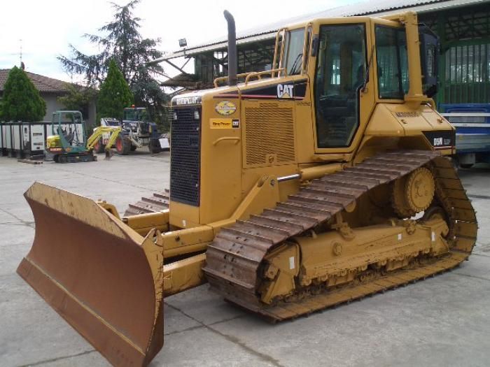

What you need is a skid loader for working that MC track. Low center of gravity and lots of weight.
   / Almost Rolled the New Holland Yesterday
#14
A skid steer would be nice but I was actually thinking that one of these would do the trick.
Mike
