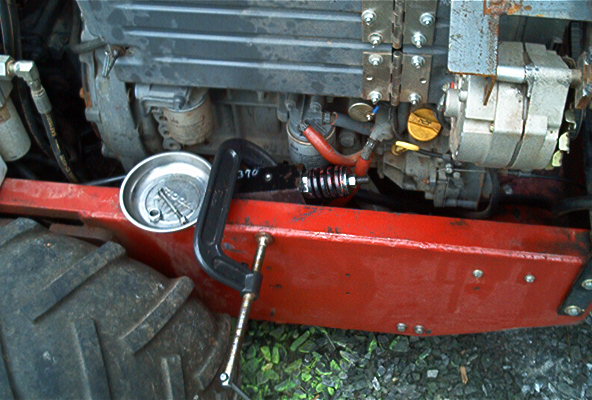

He may be refering to the machined aluminum "shuttle valve" that is unique to and probably made by PT. If so, not related to Brake Tender. Others (Charlie Iliff? Sedgewick? others?) have had problems with this item.... search postings past year or so. It is a tricky (to be polite) item!
If I were using for business, this is one case where I would get a complete new unit from PT and keep a spare on the shelf.

You are correct--the brakes are applied by springs and the hydraulic pressure--supplied by the engine turning the pump or by the manual brake tender pump--conteracts the springs to allow the wheels to turn.
In normal operation the hydraulic pressure keeps the brakes from being applied and the service brake is hydraulic--just like all other PT units. It is only when hydraulic pressure is lost (either because the engine quit or a hydraulic leak or the brake tender in the stop positon) that the spring acutated brakes are applied.
So--to tow a PT with the brake tender you must do two things--release the brake tender brakes by manually pumping up the brake tender pressure and open the tow valve on the variable displacement pump.

heres the part that I have the most trouble from..leaking. Theres a "piston" inside behind that big spring . it has a white plastic O-Ring, which usually goes bad every 50 to 100 hours. We can usually replace it and be good to go; but not this time. Black rubber o-rings don't even last a few hours.
In th epic u can see the bolt breather on top of the assmbly, this is where fluid seeps out when the o-ring leaks.
