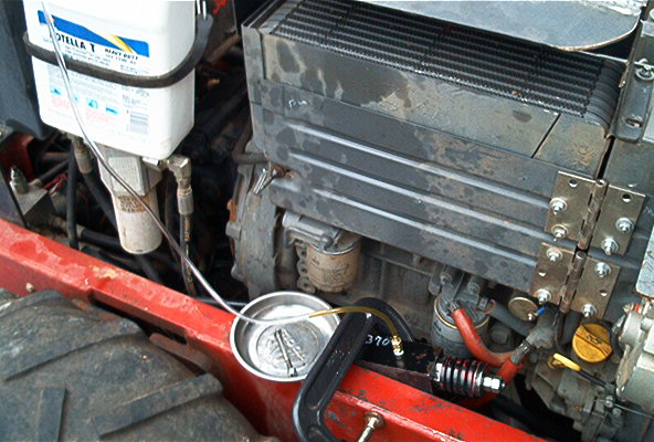

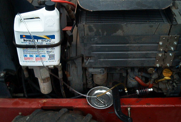

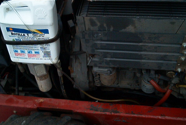

Heres my tempory fix to get it going to get our work done this week. I plumbed in a 1/4 inch tube to a home made "puke bottle"; got the parts from Lowes Sunday evening, and just finished it.

AltavistaLawn said:
heres the part that I have the most trouble from..leaking. Theres a "piston" inside behind that big spring . it has a white plastic O-Ring, which usually goes bad every 50 to 100 hours. We can usually replace it and be good to go; but not this time. Black rubber o-rings don't even last a few hours.
In th epic u can see the bolt breather on top of the assmbly, this is where fluid seeps out when the o-ring leaks.
You are the only user reporting problems with this particular part. It seems to me there must be a defect that is destroying the o-rings in such a short time--perhaps a surface imperfection or some other out of spec conditon.
Have you considered getting a replacement unit--so that you can keep the tractor in service--or sending the part to Tazwell for inspection and overhaul as necessary?
   / Altavista and the 1850 #23
Bob,
Yes getting ready to send the part back for an overhaul, as soon as possible. Terry said something about modifying one that uses 2 o-rings.
The peiece to the rear (accumulator , I think) also leaks a lot. It really seems like the hydro system is running too hot and with too much pressure.
The gauge always shows around 1500 psi; which should be normal.
But somethings definately wrong.

   / Altavista and the 1850 #25
WoodLand,
Yes, thats the gauge I'm talking about.
So far the "puke bottle" seems to be working.
