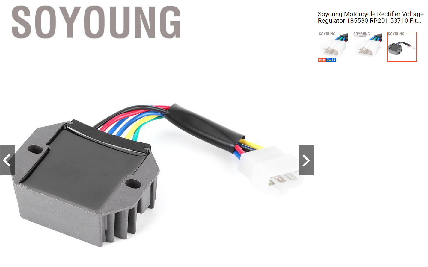

Oh, I see, just like a regular car. I think there's not enough space for me to mount additional pulley/mounting bracket because it is really tight space :-(
But thanks for the clarification. Much appreciated!
So, will voltage regulator from other non-subaru robin work? What if I swap & match up the wire colors even though they are configured differently like this one for motorcycle below ?

The function is probably the same but without a schematic of your ex and one of the Ford you're going to have a hard time matching the connections. The specs would be good too so you're not putting too much juice thru the RR.....M
Right, I see what you mean ... that's a headache ... I just posted a question whether I could safely match up the connections with a similar looking one for motorcycle :)

Dear all, just to close the loop on this issue we had : We managed to find a 6-wire rectifier/voltage regulator but with different wire pin configurations.
Our solution was to identify the 2 stator and the ignition switch/light wires. The +ve and ground was easy to identify, it the rest that's a bit tricky.
We tried finding a way to mount an alternator but it was impossible due to the way the mini excavator's solid steel chassis was weld-wrapped around the little engine :)
Again, thanks for all the inputs & ideas!
