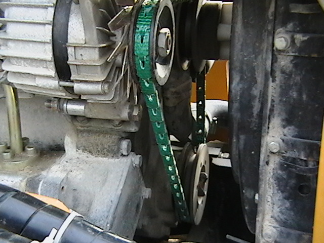

I'm going to have to replace the alternator belt soon. It looks like I have to remove the fan to do it. Is there a quicker way?

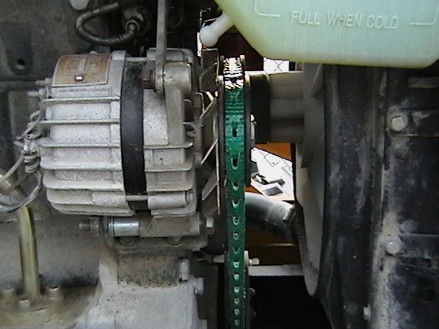

I'm very pleased with my Harbor Freight belt. It will last the lifetime of the tractor or me, whichever comes first.
And you can keep all OEM pulleys.

After personally using this type of belt for over 300 hours, and using them in an industrial environment for decades, I cannot see a valid reason to NOT switch to this type of belt in this application. Can people really be that set in their ways to not understand the advantages?
