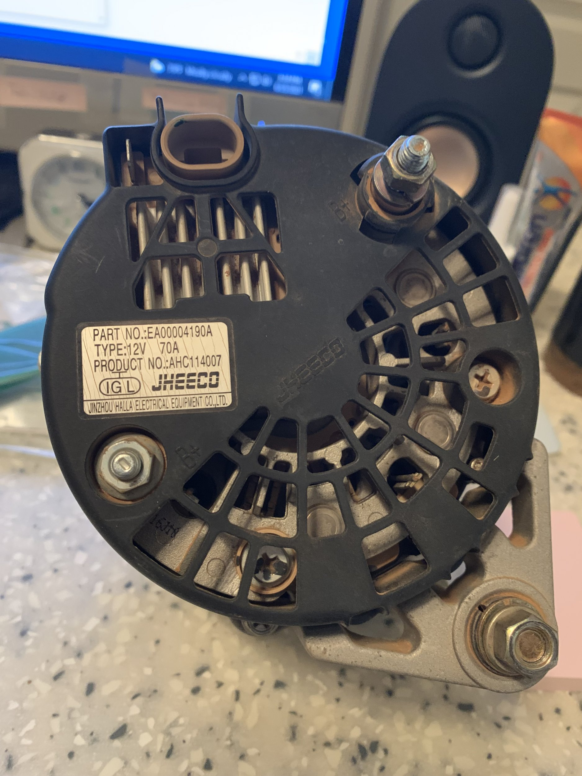

I have a 2018 4520C and it looks like the alternator has died. The tachometer stopped working but I still had work to do so I ran for two days. Then the tractor stalled and the battery didn't have the juice to start it. Never had a warning light but that's how it looks. Jump started and got it back to the house.
Now I'm searching for a replacement and can't find one anywhere. Anybody got any idea where to get one?

Yeah, the tach runs out of that single spade connector on the back of the alternator, so that was indeed an indicator. I've had alternators fail on me and never once saw the battery warning light on the dash either.

I agree, your warranty should cover it. 2nd choice, take it to an alternator shop and have it repaired. As the tach does depend on the alternator, getting something that "works" at a automotive parts house would be my last choice (pully gear ratios and electrical connections would have to be identical.)

It`s rare to have an alternator completely give up, usually one of the smaller components give up and are easily replaced or cheaply by a auto electrician. You say no warning light. it might be worth checking the lamp/bulb, if it gives up it would effect the charge and maybe the rev counter, might be worth checking the key switch.

With the tractor being that new I doubt it is the brushes worn. Probably more like a diode de-diodified.

So I checked with the dealer and it is not covered under warranty and a replacement is priced at $440. So the alternator is at an auto electric shop to see if they can get it squared away.

No Luck. The shop can't find parts and can't find a replacement. This Chinese crap is not available anywhere. So it's back to the dealer and their ungodly prices! :cry:

The only thing "special" is how and were the tach signal is picked up

The shop manual has a couple pages on diagnosis of the windings and rotor, but I don't know if the individual parts are available.
