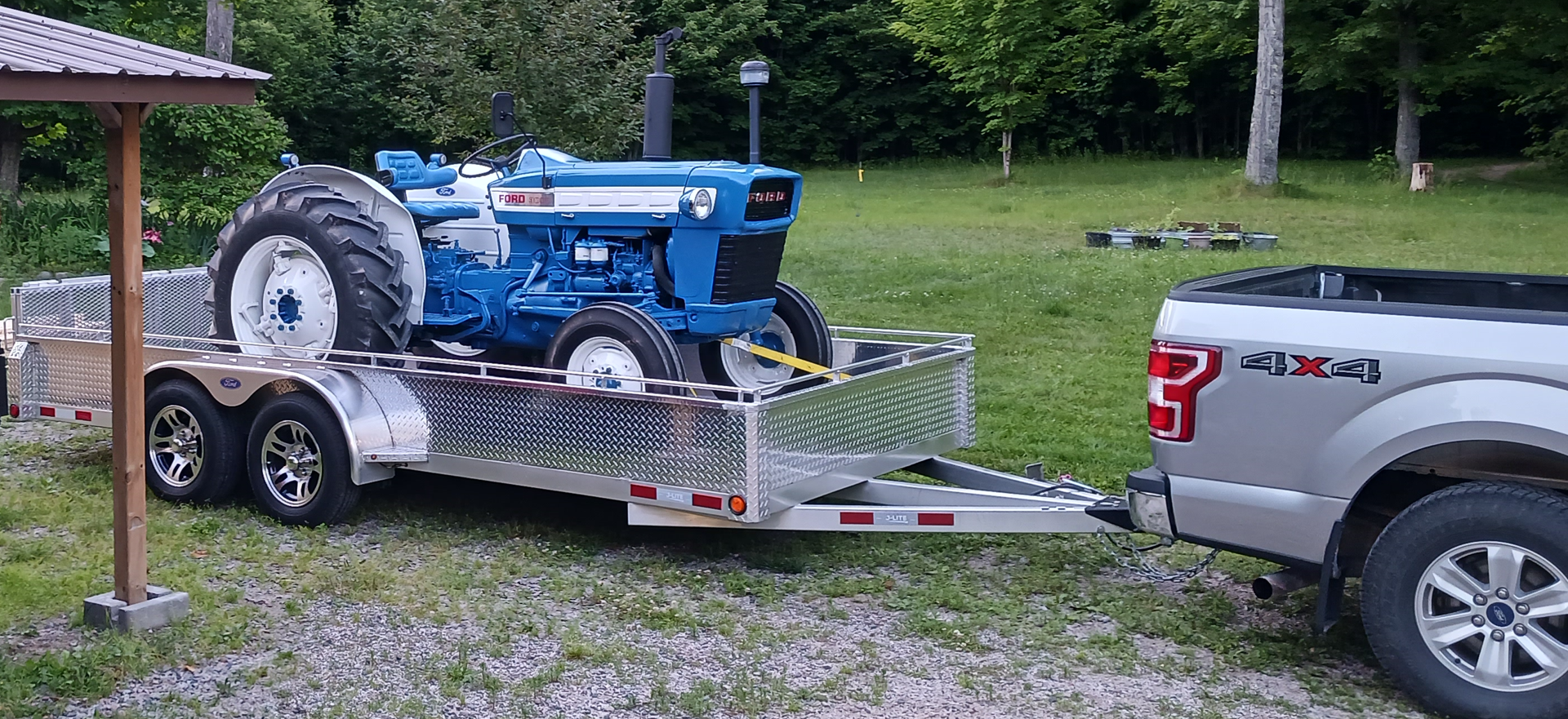

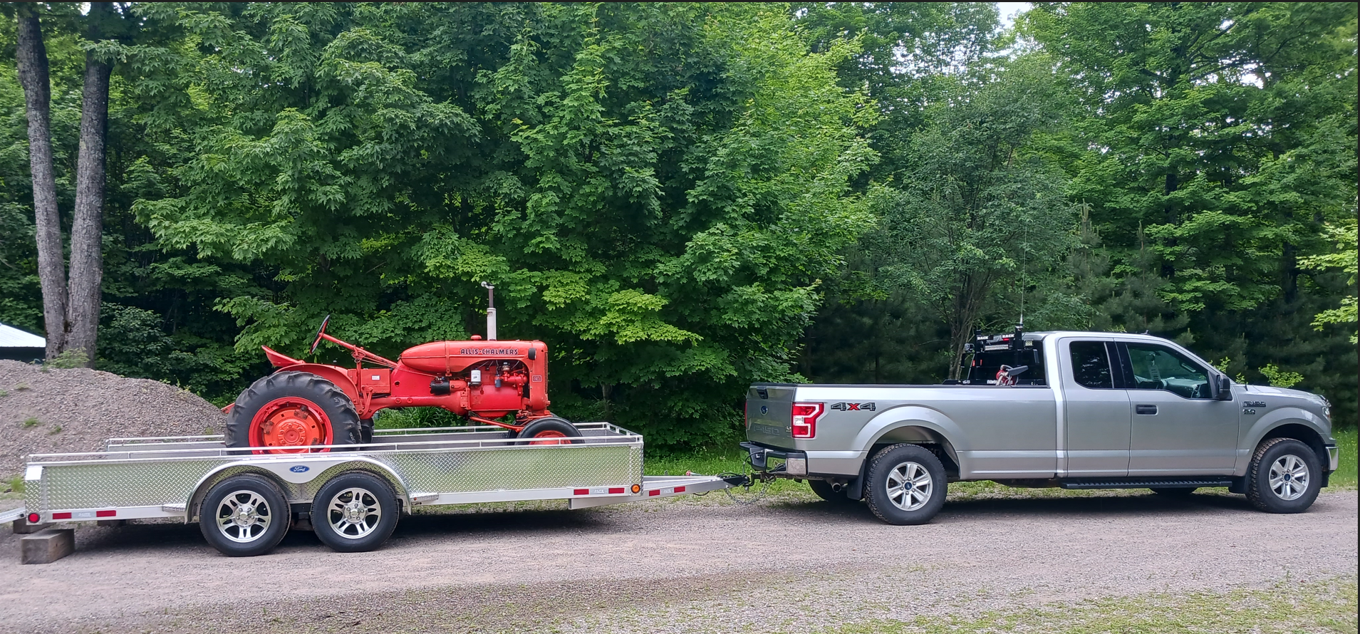

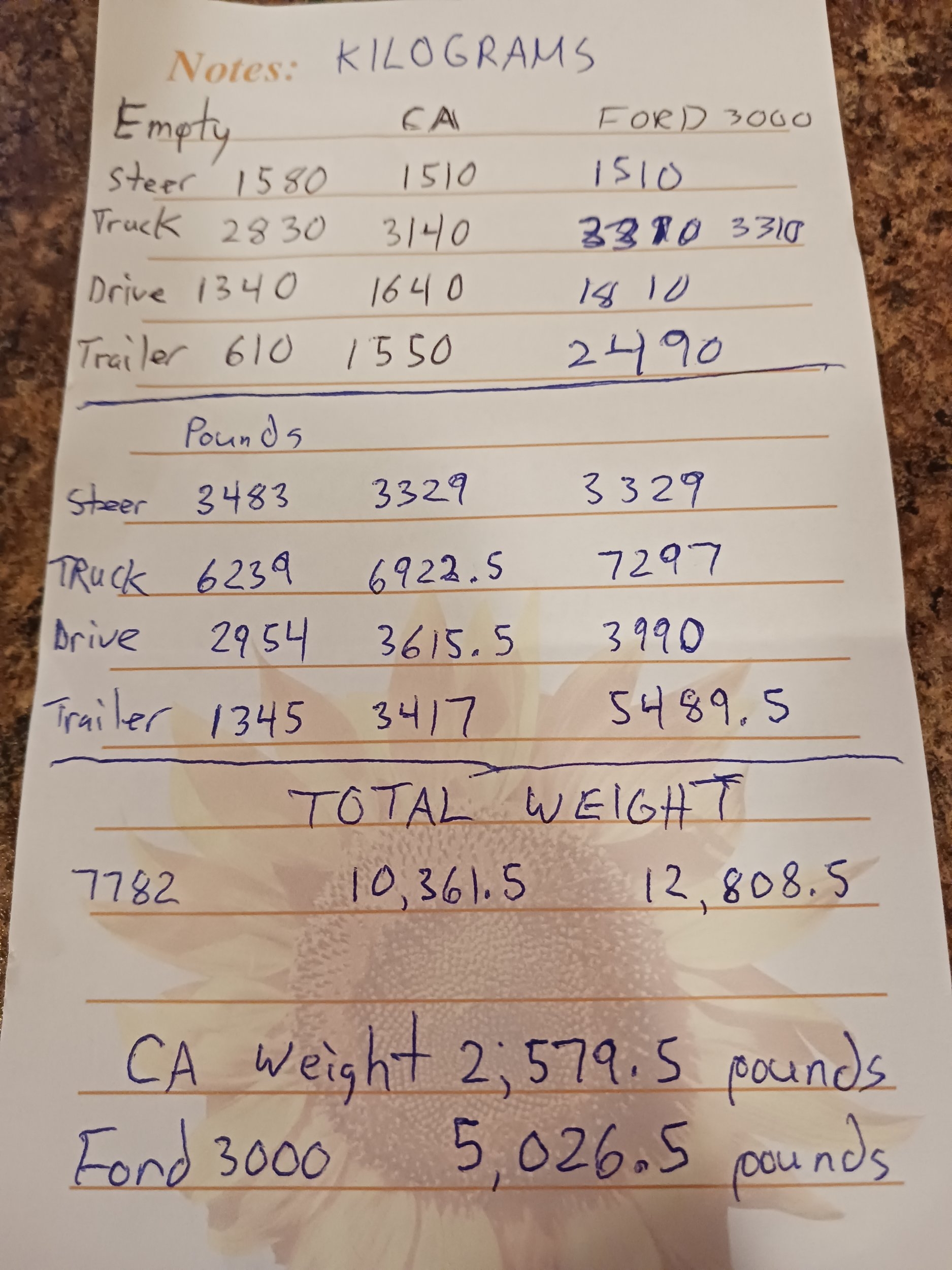

Well that is a concern. I looked up your tractor and it looks to be 4,000 lbs +/-.
My load would be a Honda at 2,600lbs, Jeep at 3,400lbs, or a CanAm ATV at 2,600lbs (if I buy one .....)
I was surprised the CanAm ATV weighs the same as the Honda Fit.
I ended up axle weighing both tractors at the MTO (DOT) scales. Where it says truck is both the steer and drive axle on plate, but since these scales only axle weigh big rigs, may not be 100% accurate as both my axles were right on the edges of the plate due to length of my truck.

I bought an aluminum trailer!! An Aluma 8216 anniversary model 16 foot tilt trailer.
So, good bad right or wrong I will try it out and see how it goes. My missions for it will be to haul a Honda Fit, a Can Am Defender ATV, and assorted small tractors and equipment.
I bounced back and forth between similar models-- a few hundred pounds apart and single vs dual axle. Went with dual axle for all the obvious reasons. A couple hundred extra pounds for that is not a big deal. Blowing a tire with only a single axle is a big deal.
