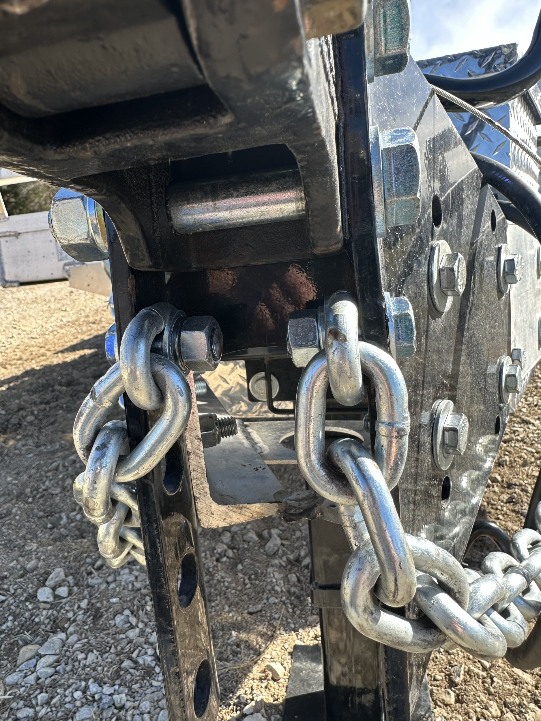

One thing that was ignorant is how they had safety chains hooked. Just used them as like a washer one of the 4 bolts holding the steel adjustable coupler on.
I moved them.

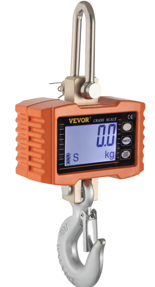

Not for nothing another thing I bought that i use and is super handy to have is this. You can weigh buckets, roll bales, or anything. Love it. Mines a 2200lb scale.

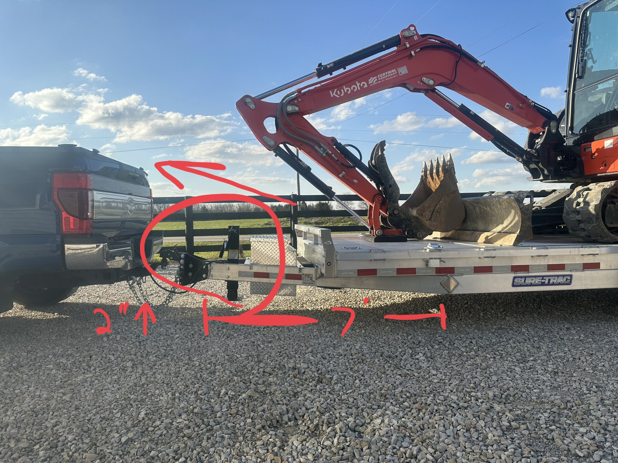

Little update after i used for a bit. It pulls great. Easy to load even though i only have a couple inches on each side of clearance between fenders. No issue. Now for what i just figured out and am pi@@ed about. For the longest time i could figure out why the tongue looked like it was running uphill. I have the trailer perfectly leveled when loaded, not even a 1/2” of upward slant. But tongue and jack, and coupler all looks like it’s slanted. So i finally looked into it and found the tongue runs uphill, 2” in 7’. The tongue starts at the side frame rail and then passes under the front frame rail. There is almost an inch of thickness difference between front frame rail and side frame. It is bothering me bad. Doesn’t effect its function, but sticks out to me bad, especially now.
Here’s a vid of the frame and tongue. Tongue
Heres side pic, it shows up better in person. The jack looks slanted and so does coupler just like the trailer is high in the front, its not, its level.
