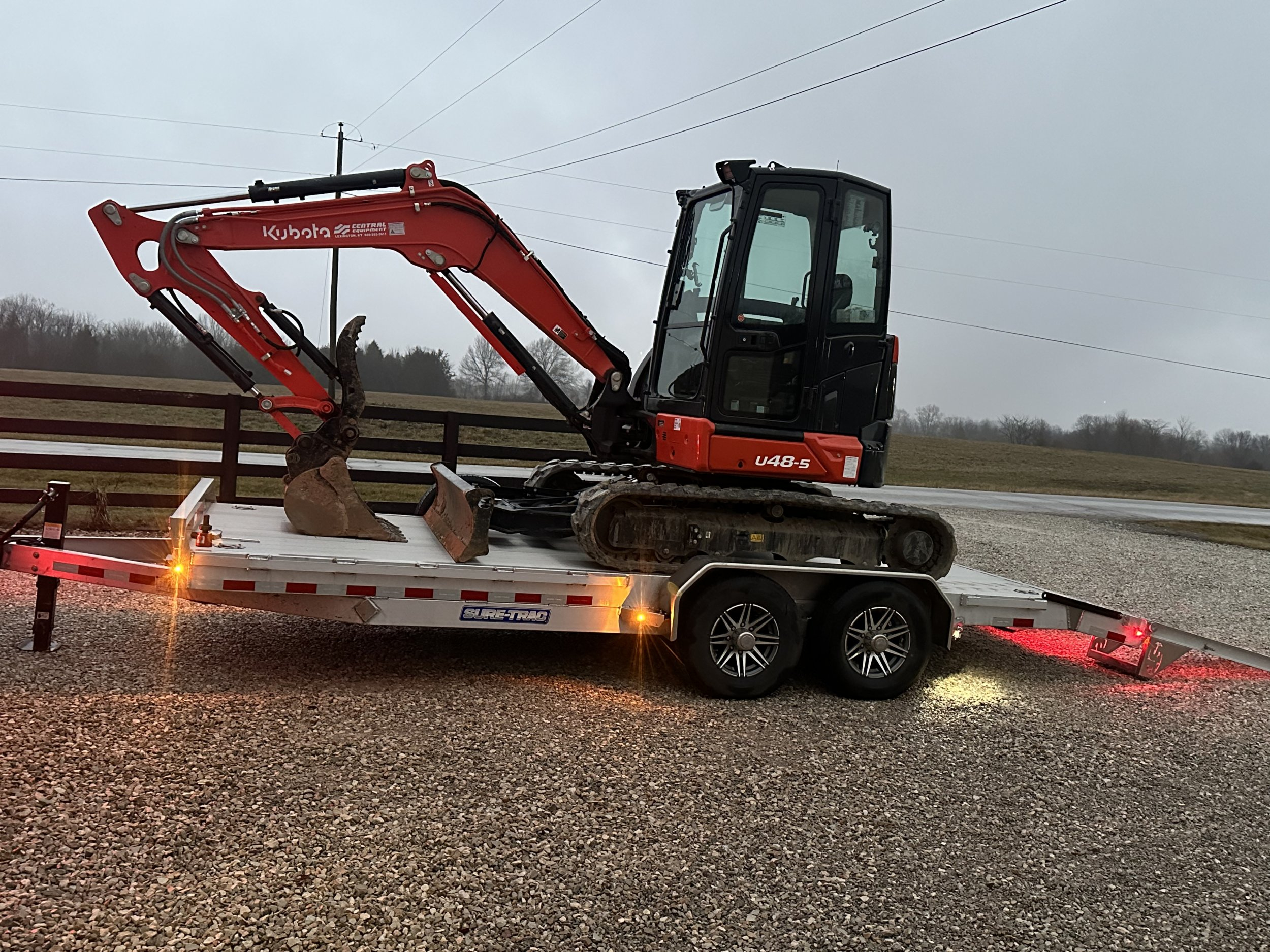

so i bought the suretrac 20’er. After all taxes it was $13k. I want the 22’ they offer but there is a back order of 8” channel and they cannot build anymore aluminum trailers for a good wile. There is only a handful of these 20’ trailers left within a 1000 miles, so i went ahead and jumped. When they start building again, and if i still feel 2’ would benefit me i may order one and sell this one. as you can expect, this large 2000lb trailer pulled like a dream on my 2 hour trip home. Zero vibration or bounce, or anything. Cant feel it back there. The adjustable trailer coupler had 5/8 bolts and was just too sloppy. The trailer bracket has 3/4 holes, i had to drill the cast coupler out 1/8” and it was not fun. Cast does not drill easy. But I now have 3/4 grade 8 bolts and it has very little play. I blame the trailer dealer for this one. I was super anxious about its placement so i pulled the mini x up on there and got my tongue weight at 1400lb.(tongue scale, worth every penny) and this is where it will ride. Trailer is front high cause its not on truck, had it loose to use scale.
View attachment 781682Today we got iced out so i still haven’t pulled it loaded to see how it does. So far it seems built well And i can live with the ugly bland unpainted aluminum, especially with 12005lb payload. Got nice aluminum rims Too. It came with 4 of these tie down things, no way i can use them but they have a 6000lb rating. Kinda worthless to me.
Need better weather. To get hitch height set and take for a trip. Will update.
oh yea, the fenders come off easy, just one hand knob and it comes right off. Good thing, there is only 3” of room on each side of the tracks to fender. All its going to take is one morning I’m in a hurry unloading…they are stiff and you can walk on them, but wont take a track pushing into them.
Just a question- would you consider backing that thing on there to get more of the weight to the front, or isn’t it feasible?

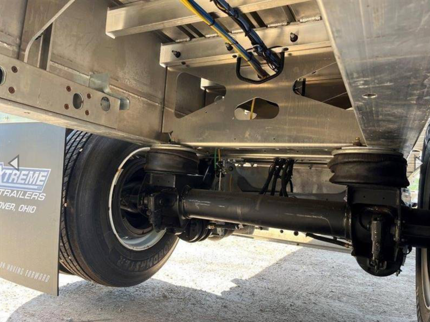

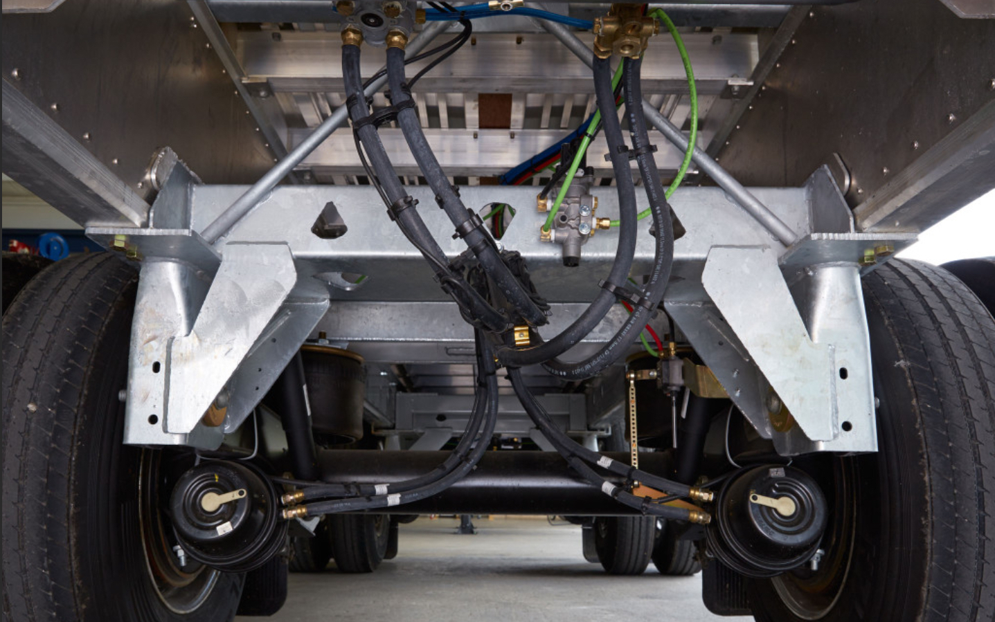

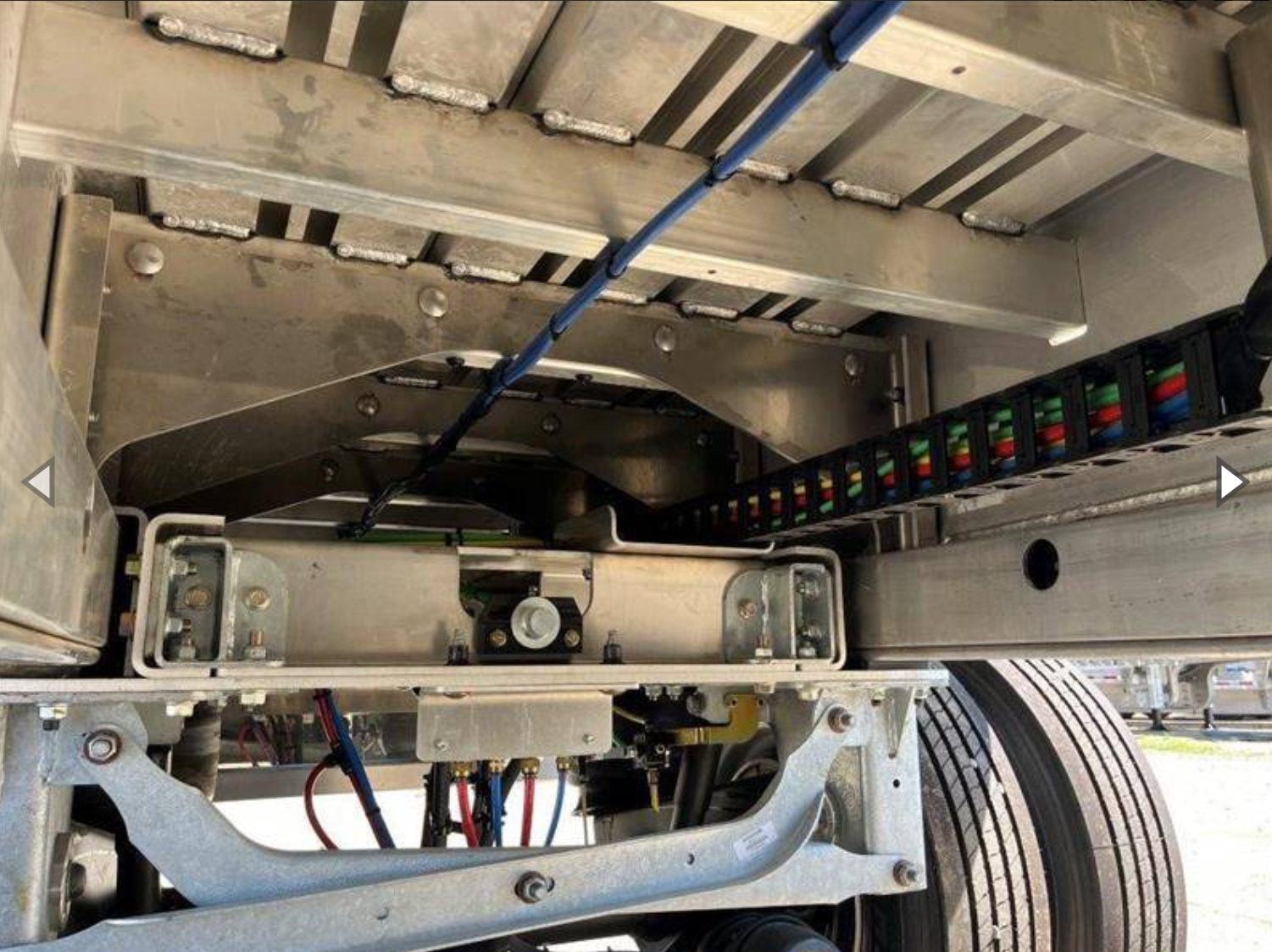

I have repaired a number of aluminum trailers, as others have noted the welds commonly fail. It’s probably because people that build them have experience with steel but want something lighter and don’t build them out of aluminum correctly.
Pointing at semi trailers made out of aluminum is one thing but then we should also look at the construction techniques. Notice the lack of welds holding the aluminum parts together?
That running gear that’s welded together is galvanized steel, the aluminum is rivet/bolt, not weld.
Another brand where the deck is welded to cross support but again note the daylight you can see where they pass through the frame, they left it like that because a weld thats not there, can’t crack.
You could read a lot about the difference between stiffness and strength, modulus of elasticity and such or just look at used aluminum trailers and see where they are failing.

Nice trailer and you should be fine 👍
I'm sure that you've witnessed the same, but I'll see it when loading and tight maneuvering with all trailers. There's some heavy stressing experienced during both of those. Carrying a little collection of shims to stick under the ramps "legs" before the trailer's suspension is compressed to sit on the ground while loading/unloading is a good practice for the back end of the trailer beyond the axles.
Seems like you've got enough experience and smart's so enjoy 👍

Looking at the bones of those trailers, I'd never consider one of I was in the market.
