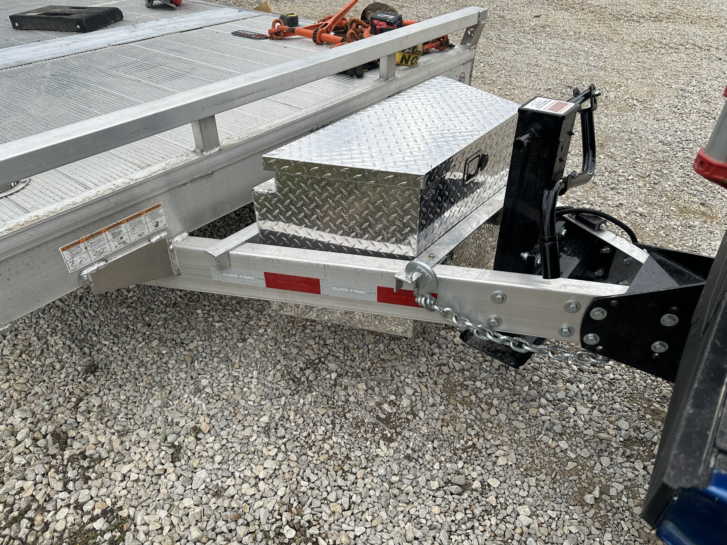

I got the cheap tool box mounted on tongue. I DID NOT want to drill the tongue. So i cut some square tube up and cut some slots to set on tongue. If it was steel i would have drilled or welded to fit it up, This being aluminum, i feel as though i have to treat it like an egg. Was able to add hook storage holes.

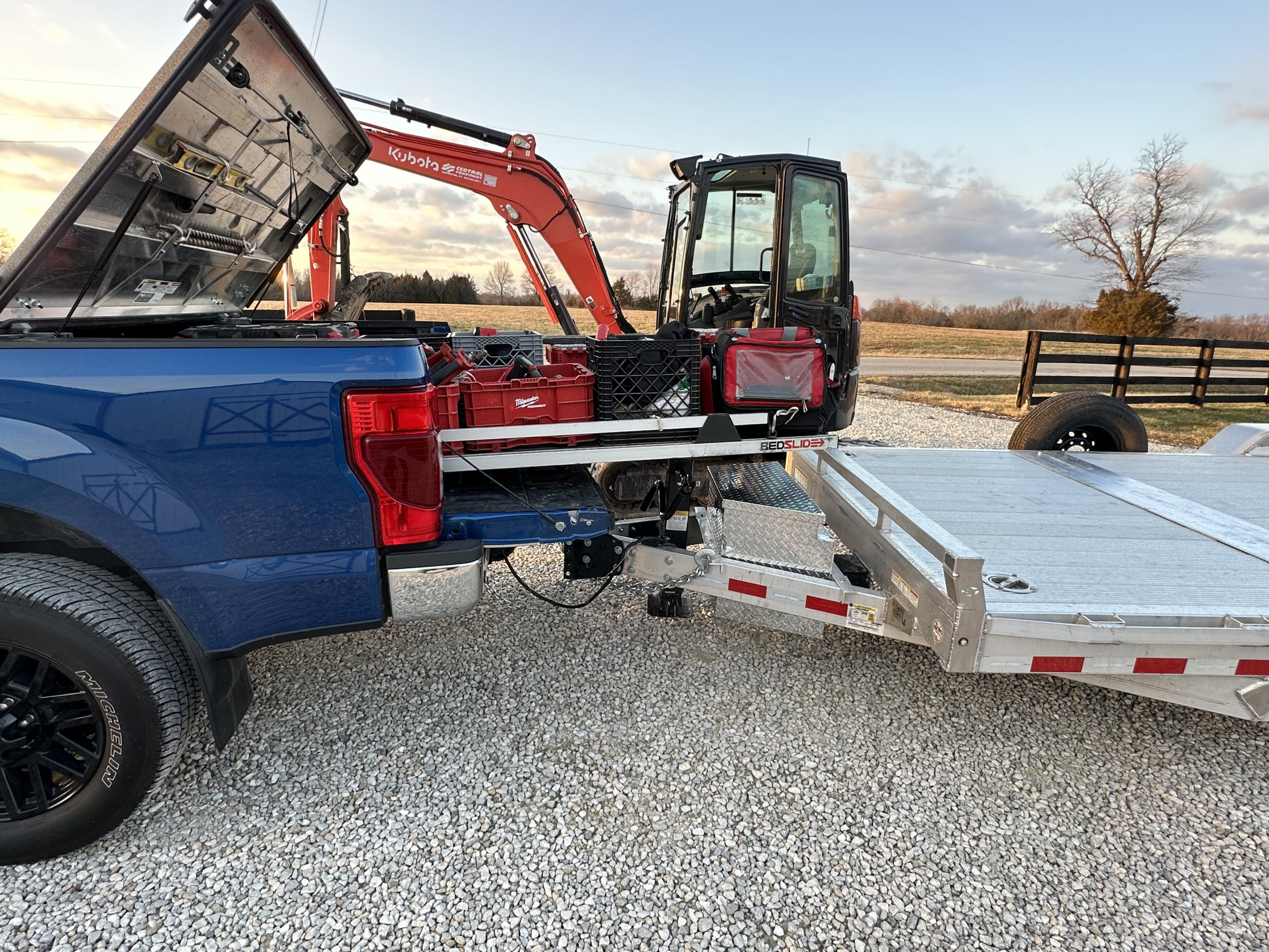

This trailer is low enough i can access my slide out wile hooked up, other trailer had spare tire and jack in way.
I had to mount my toolbox on the deck because my truck bed overhang was wreaking the hitch box. After having the room of the truck box it would be hard to go back to the little hitch box.

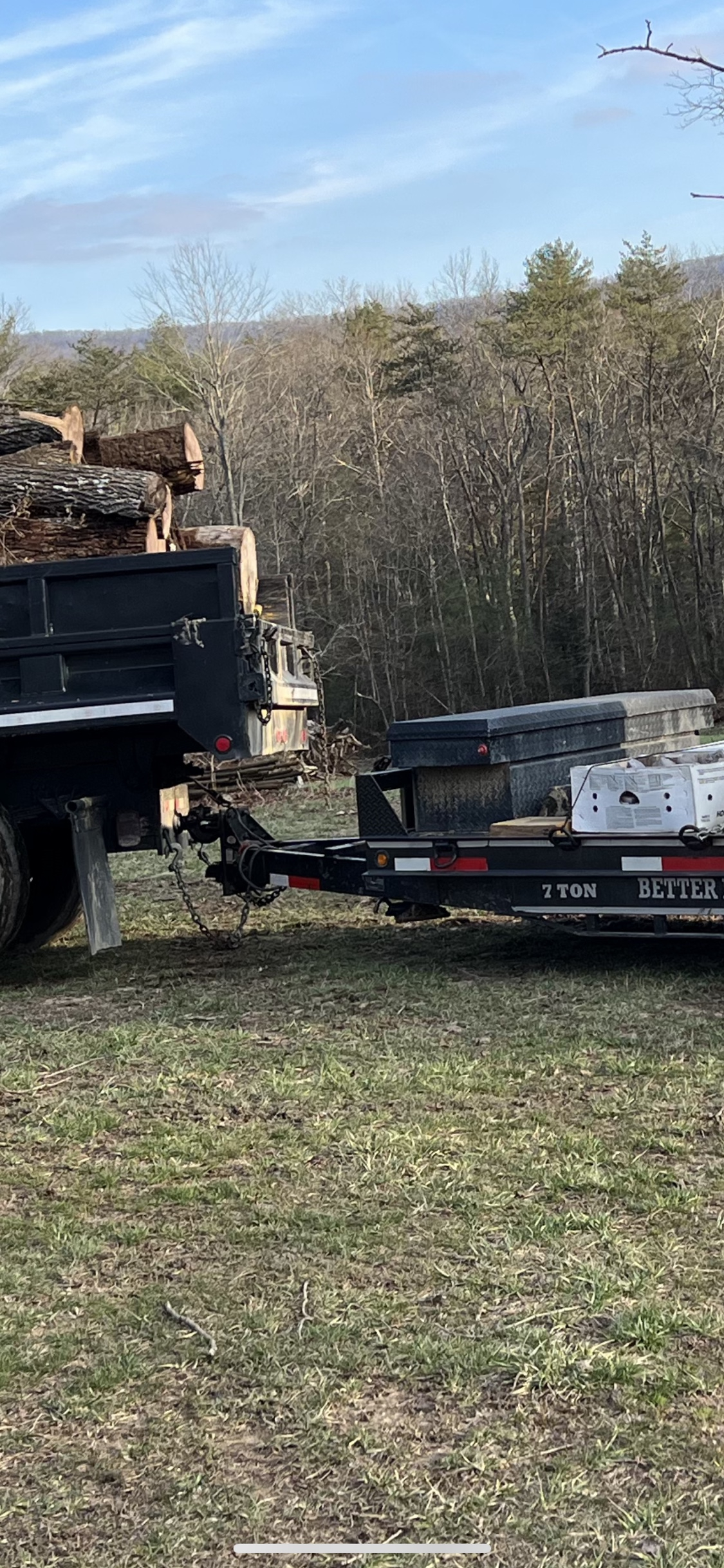

You sell logs? I am planning on getting a sawmill and selling rough cut lumber instead of logs. And firewood on the side. My place is due for logging but just hate to take such a huge loss if I can avoid it
   / Aluminum equipment trailers. #75
I used to sell a few but the local mill closed down and without having an actual log truck it wasn’t worth the effort to haul to the next town over. I kinda want a mill but I’m not sure if selling lumber in smaller volumes is all that profitable either.

Hershey - I think you misread the D ring stamp. It says 6 000lbs. Must be 6 pounds. I would say it's safe even up to 12!
The set-up looks good, and I was going to ask if you could put the extra bucket in the bed of the truck, but I see the slide-out and load of tools. Question for you: When you weighed the rig, did you have all of your hand tools loaded as well?
#77
Yes, when I weighed both mini ex and my truck were full of fuel and all tools. My extra bucket is a homemade gravel bucket and will go on top of my bed cover. It’s rated for carrying 1600lb on it. Diamondback bed cover. The bucket weighs 500lb, I’ll set it on a pallet.
