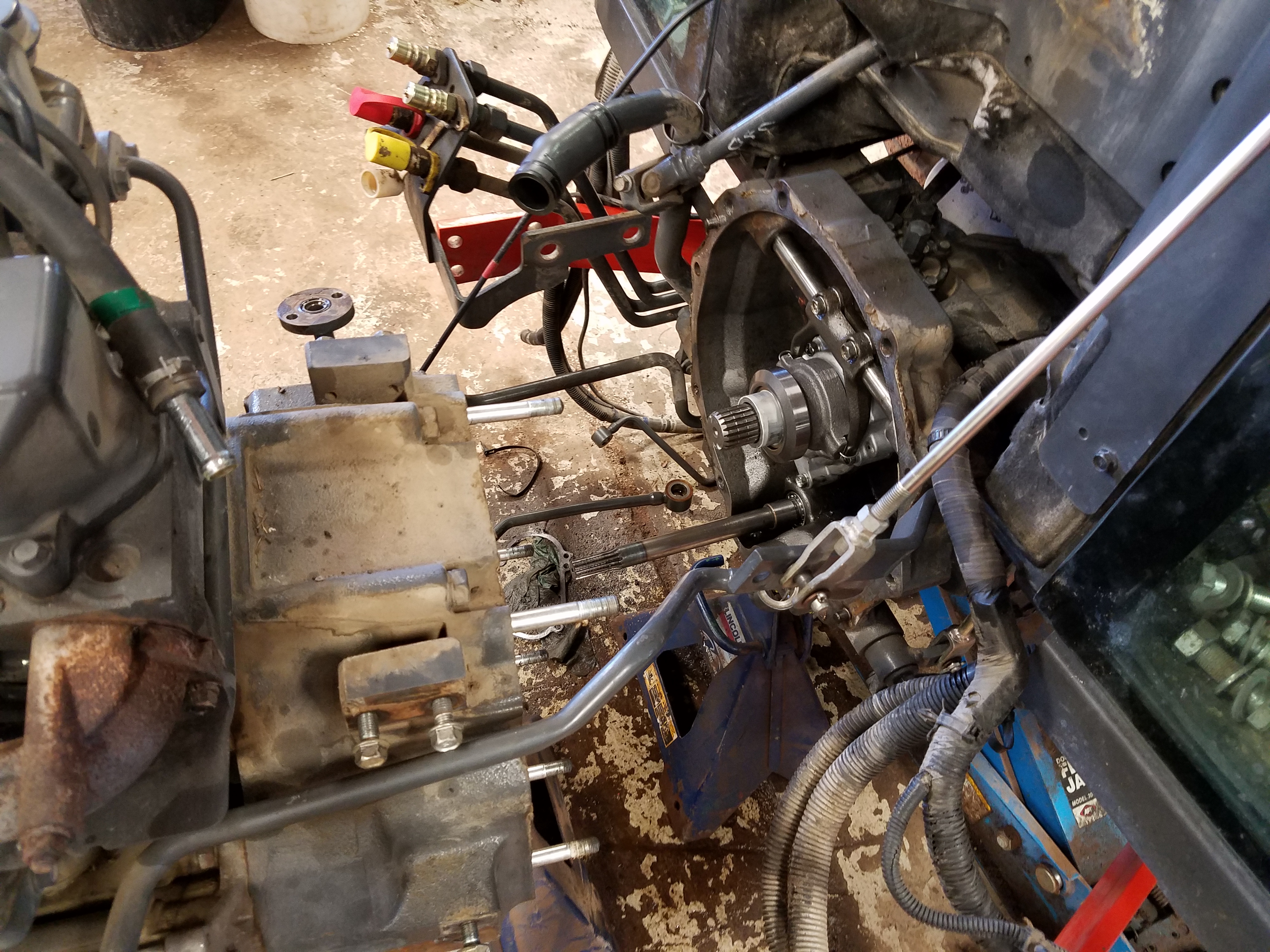

The loader isn't back on yet. Is the suction hose the one removed in this picture?View attachment 483877
Bingo! Well that explains the lack of power steering! No suction hose to the pump, so no fluid movement to the power steering.
   / Am I going to have to split my tractor to fix this?
#62

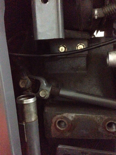

The hose was back on when I started the tractor. I had to remove that hose to get the steering U-joint back on.
