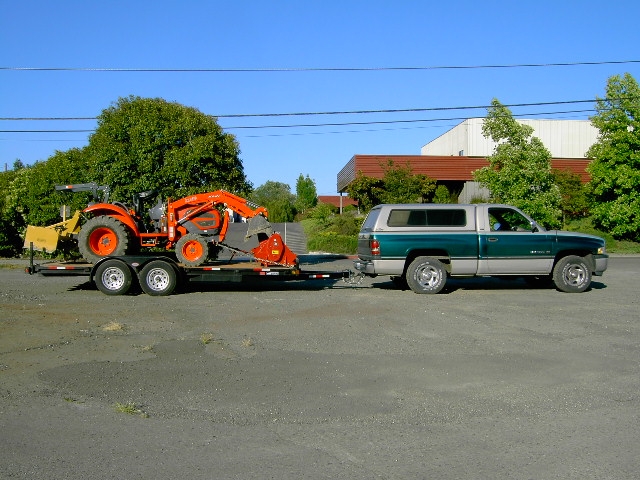

I don't have a back hoe, but I know from hauling mini excavators with my Pete that you should throw a chain over the back hoe bucket and secure it to the trailer (booms can swing from side to side).
Here's a pic of about 4,000 lbs. on a 7,000 lb. trailer secured with two chains, one front and one back, never a problem. (this should light a fire!)
Just curious, but do you have the tiller on the front of the trailed strapped or chained down or is it just held in place with the bucket? State DOT laws vary, but it is likely that you must have that implement secured separately with a strap or chain. Again, just because you have never had a problem, doesn't mean it is in compliance with the laws. You may want to check your state laws regarding securing individual implements.

   / am i legal? #17
I generaly don't haul an extra implement with me but on this perticular day I had two different jobs to do within 1/2 mile of each other, mowing and then some dirt work and it was only a 22 mile round trip. The mower (was the box blade at first) is squeezed between the front and the bucket is resting on the top link hitch. If ti was any farther distance then I would have a pair of nylon straps to tie it down.
As far as an equalizer hitch, it would void this excuse; "see honey, this a why I need to buy a new bigger truck"!
Oh by the way, I have a chest type tool box in the bed plus there's 4 - 5 gallon jugs of diesel setting back at the tail gate and the extra implement is why she's squatting a little.

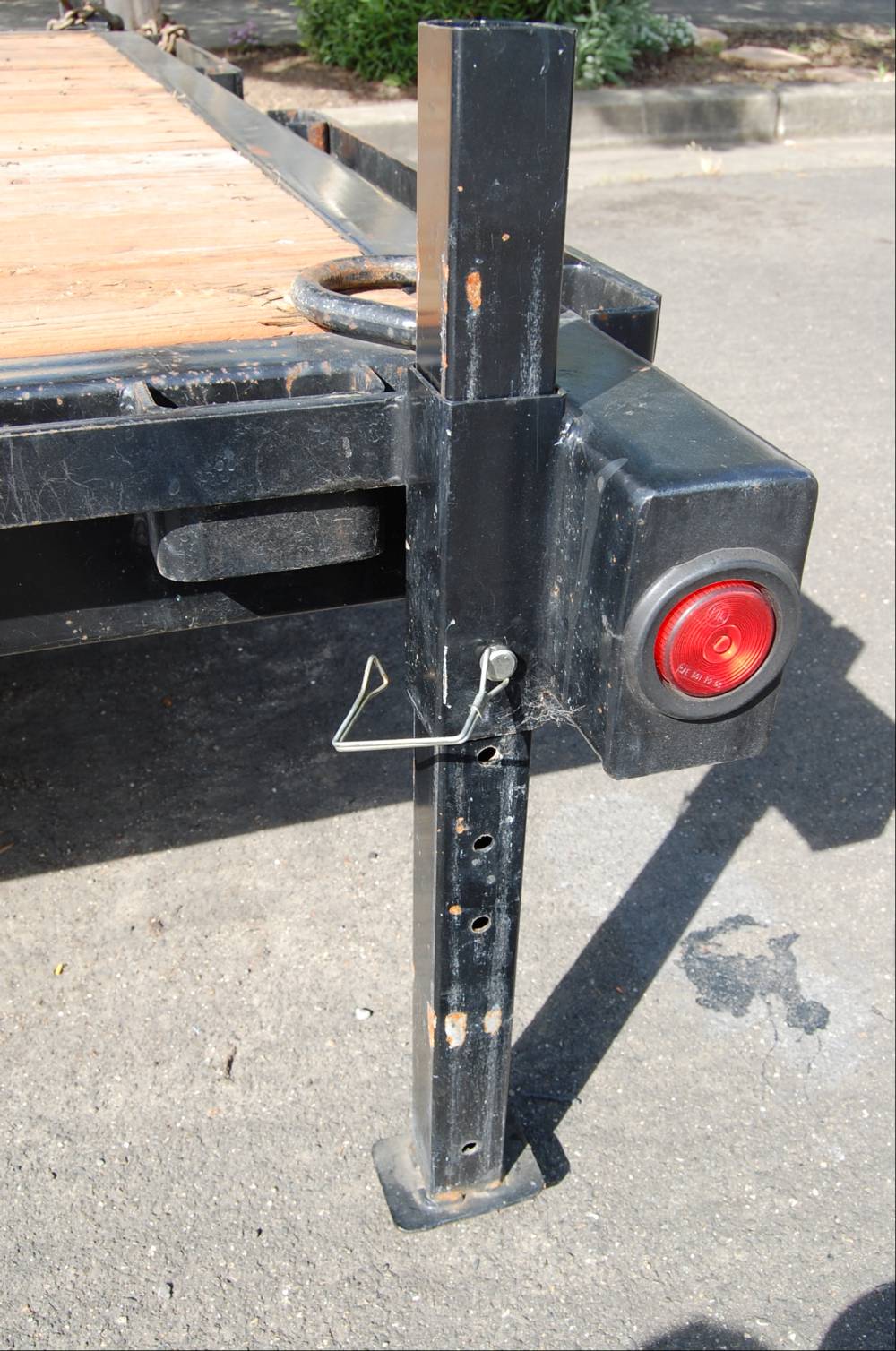

hey dirt
can you take some pictures of the jacks on the back of your set up if thats what those are? i need to fab some up for mine, tired of watching the truck go to the moon when i unload.

   / am i legal? #20
I too got tired of my truck's rear-end almost off the ground when loading and unloading, I carried a ratchet type jack stand around for awhile and would just put under the rear of the trailer each time --- it works but in soft ground it tens to drive the jack stand into the ground. Now I could have ordered this trailer from the factory with "stabalizer legs" for an additional $250.00 +!
Last winter I decided to fab up my own, a trip to the metal store $22.00 spent there and about 2 1/2 hours of my time, I had adjustable drop legs!
I'll take some pics tomarrow and post (raining here today!)
