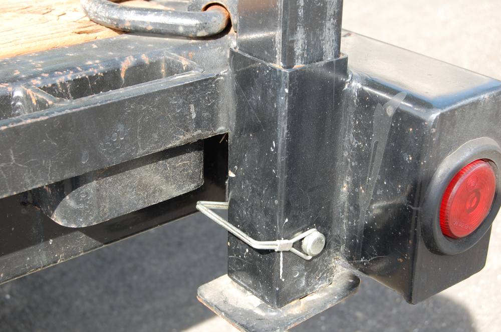

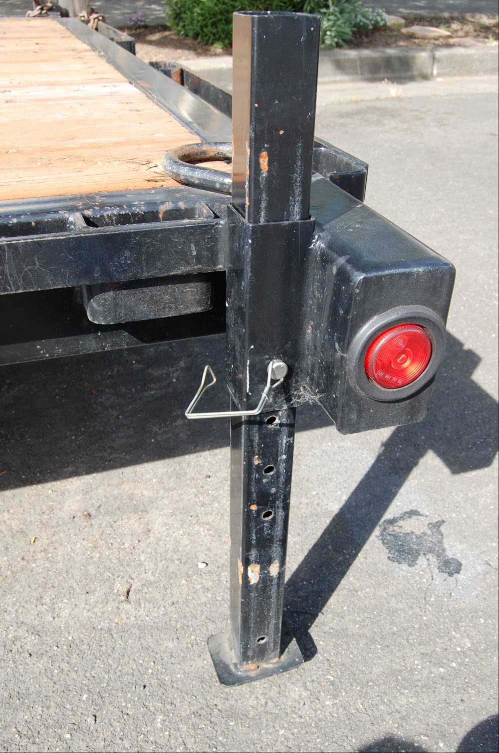

workinallthetime: Here's a couple pics of the "trailer legs" I made for my trailer.
material: 2"x2" square (outside)
1 3/4" x 1 3/4" (leg)
2 3/4" x 3 3/4" flat steel (feet)
3/8" x 2 1/2" pin
3/8" holes spaced 2" apart (in hind sight, 1 1/2" spacing probably would've been better!)

thanks man next project this weekend, ill call em dirty legs in your honor,lol:D
