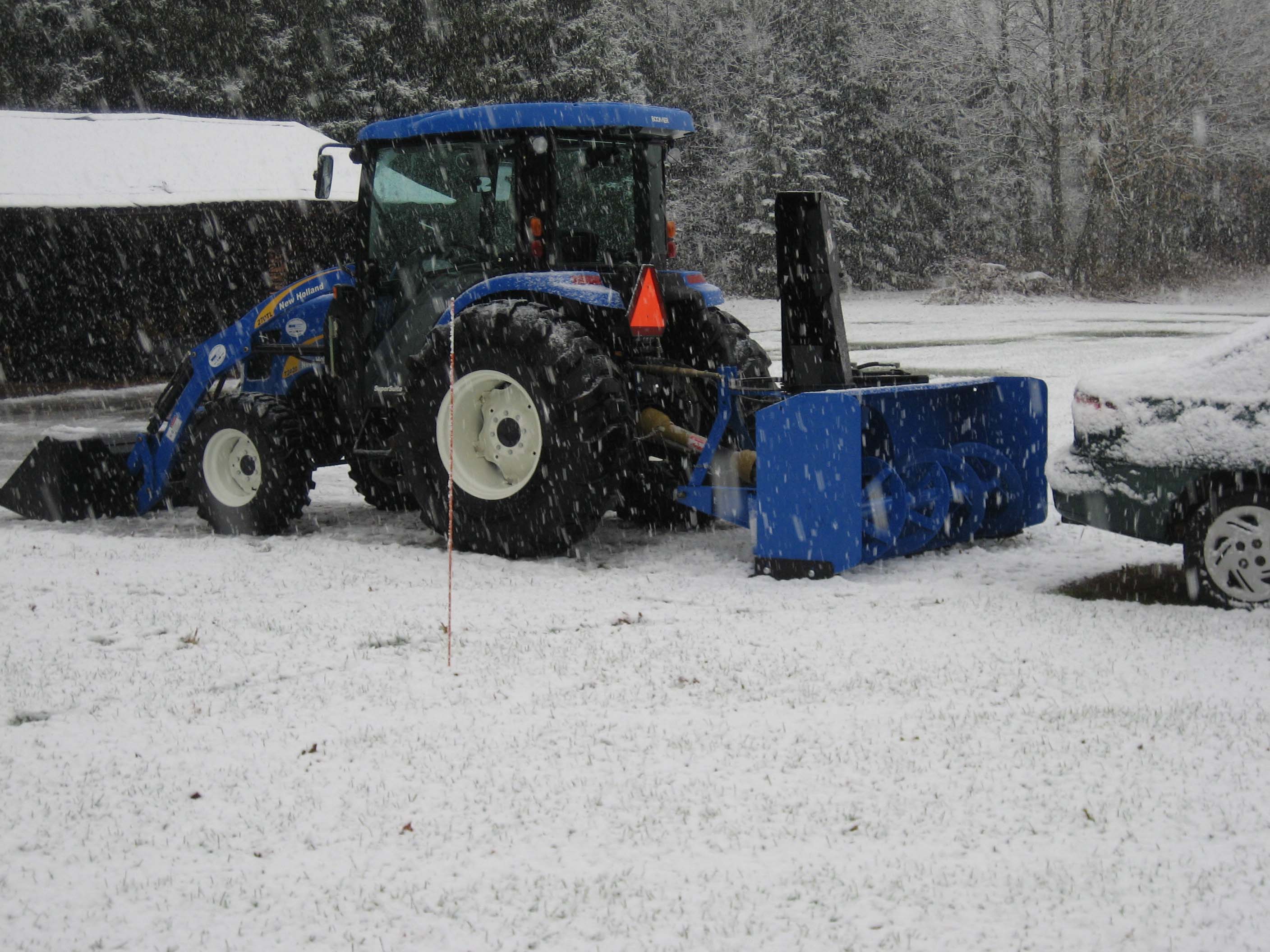

yes indeed 84 inch 34 inch height, works great :). I actually was trying to sell it, but it's grown on me, backing up isn't too bad anymore take care
