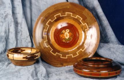

The article said you use a homemade lathe to cut the wood for the guitar, but there aren't any round parts.:confused: Just curious if you don't play a guitar what made you decide to build one? I am certainly not knocking your work so please don't take it that way. I'm just asking questions.
The lathe being referrred to is one that I had built back in the early to mid nineties for turning large diameter segmented wooden bowls up to about 36" diameter. I had mounted a small CNC milling machine to the lathe to be able to make decorative cuts as well as indexing for making clock faces etc.
Then when I got into guitarmaking, I used this same setup to mill the molds for holding the guitar body parts during construction as well as cutting out the shape of the top and back plates for the guitar. (Yes, they are definitely not round) I will try to find and post a picture of this setup.
After making a number of large bowls I was looking for another challenge. Archtop guitars looked to be the answer as the top and back plates are contoured much like a violin. The challenge didn't waste any time in presenting itself but I was able to meet it using templates taken from a book and hand carving the shapes. The hand carving eventually proved to be more than my arms could stand so eventually went to rough carving them on a larger CNC router.
The finish on the guitars is nitro cellulose lacquer as used on cars back in the day. It has plasticizers added to allow for wood movement with changes in humidity. The nitro is used first as sealer and then as clear coat after the colors are applied using powdered aniline dyes dissolved in alcohol.
