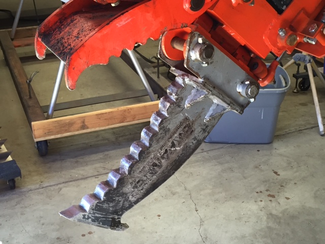

I've dug lots of stumps with a 12 inch bucket on the backhoe. But it is a lot easier with one of these rippers. You can just push it straight down and curl it under a root without having to dig dirt away, and it provides a lot of leverage for pulling and breaking.
Thats pretty cool! Going to have to get me one of those after the tractor arrives.
Do you have a link of where these can be purchased?

There are three companies that TBN folk often mention for a ripper tooth -
Bro Tek
Bxpanded
Michigan Iron & Equipment
Mine is from Bxpanded but they all seem to work fine.
   / Am I thinking to big? #49
Bro Tek
Bxpanded
If you look close, the model in the picture is a Bxpanded model. They only have listings for backhoe accessories for smaller CUT's from Kubota, Deere and Massey.
Here is a link from 2010 showing a ripper a customer purchased from Michigan Iron and Equipment for his Woods BH90X (Kioti DK40se)
https://www.tractorbynet.com/forums/attachments/185530-added-ripper-my-woods-bh90x.html
Looks like Bro-Tek makes a version of a ripper tooth for almost all brands of CUT backhoes:
Bro-Tek

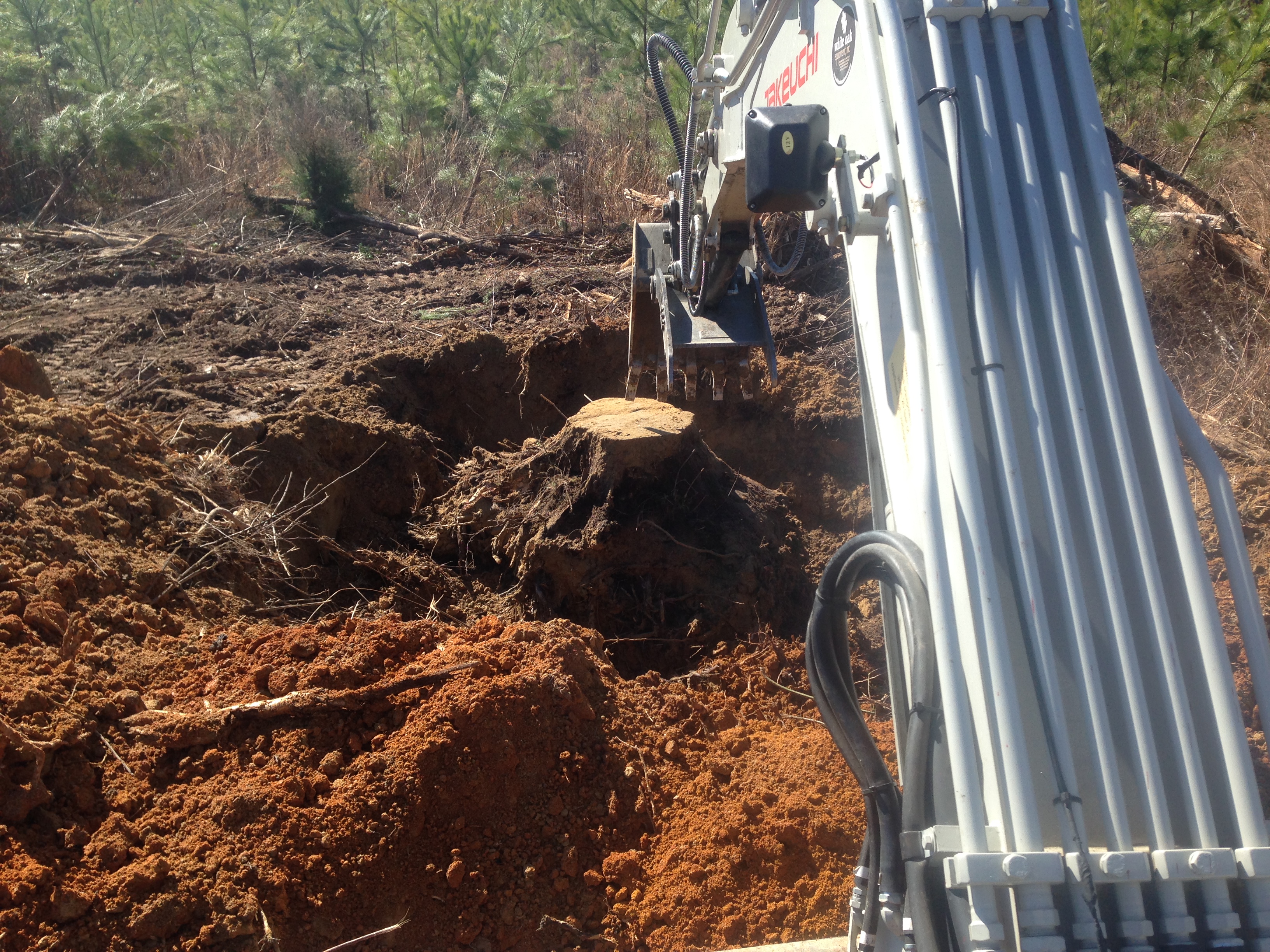

If it were me, I would buy at least the 45hp tractor and then rent a big mini-ex for the stumps. I just cleared out 3 acres on my new property that were full of big stumps (18" to 48"). Using the mini-ex, I was able to dig around the stumps with ease and as soon as the stump was out, I used the dozer blade to back fill the hole. Even with the mini-ex it still took about 45 minutes to an hour to get out the big 48 inch stumps. 10 to 15 minutes on the smaller ones. There is no way I would have wanted to do this job with a brand new 30,000 dollar tractor. JMO.
After I dug the stumps, I went over the whole area with my tractor and box blade to grade everything out and used my grapple for moving brush to the burn piles. That is the fun part. Still working on the burn piles.
