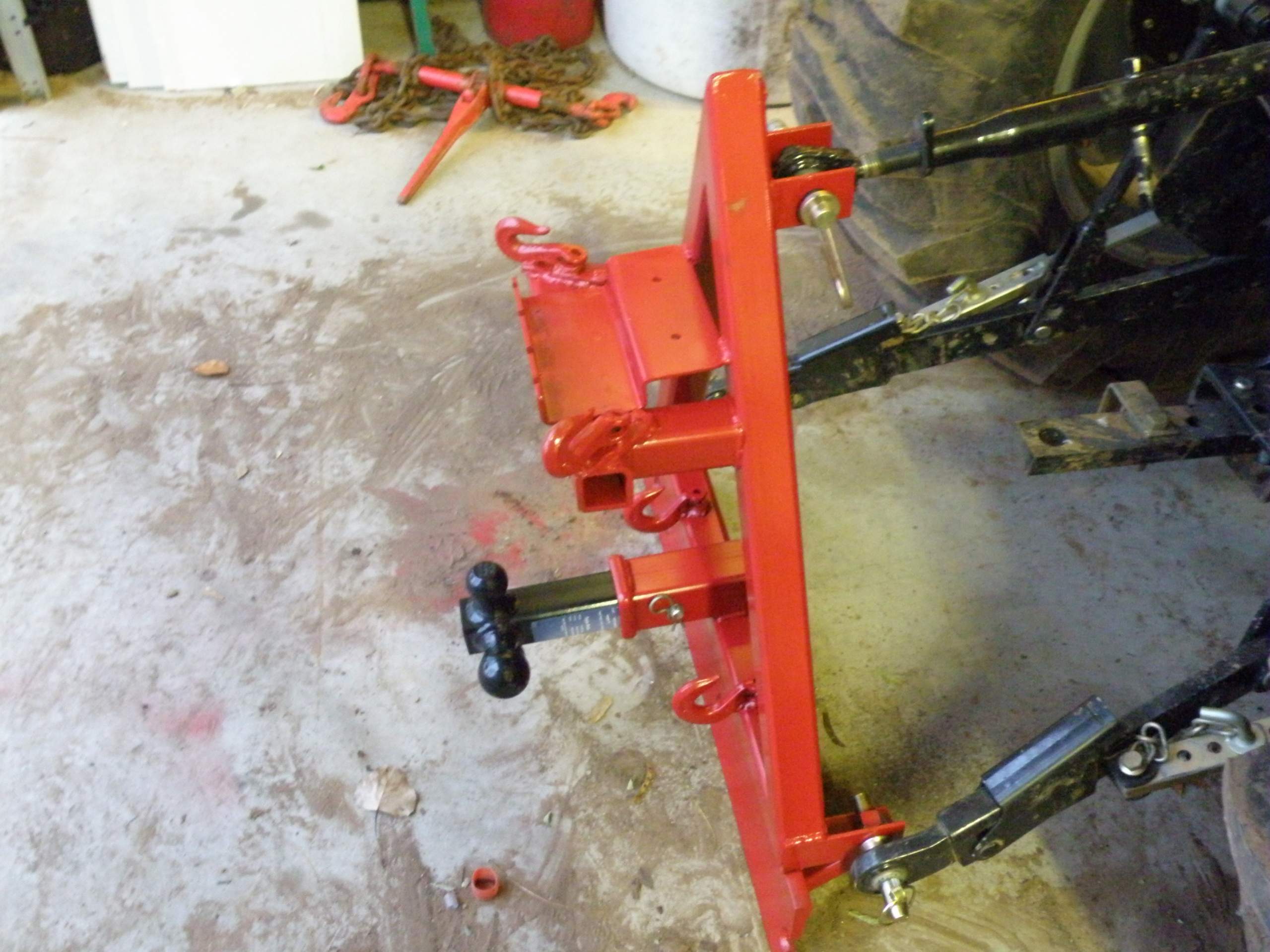

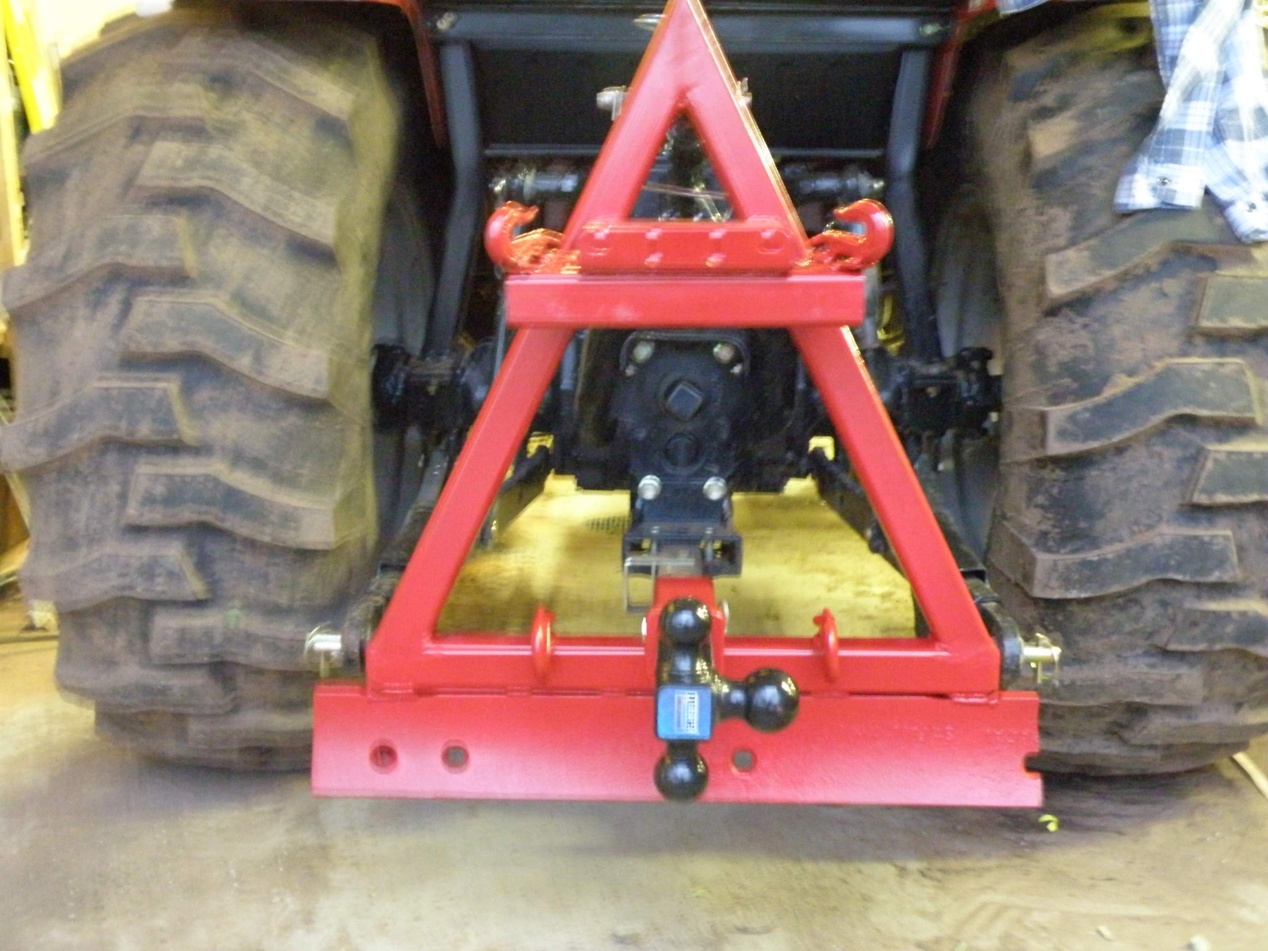

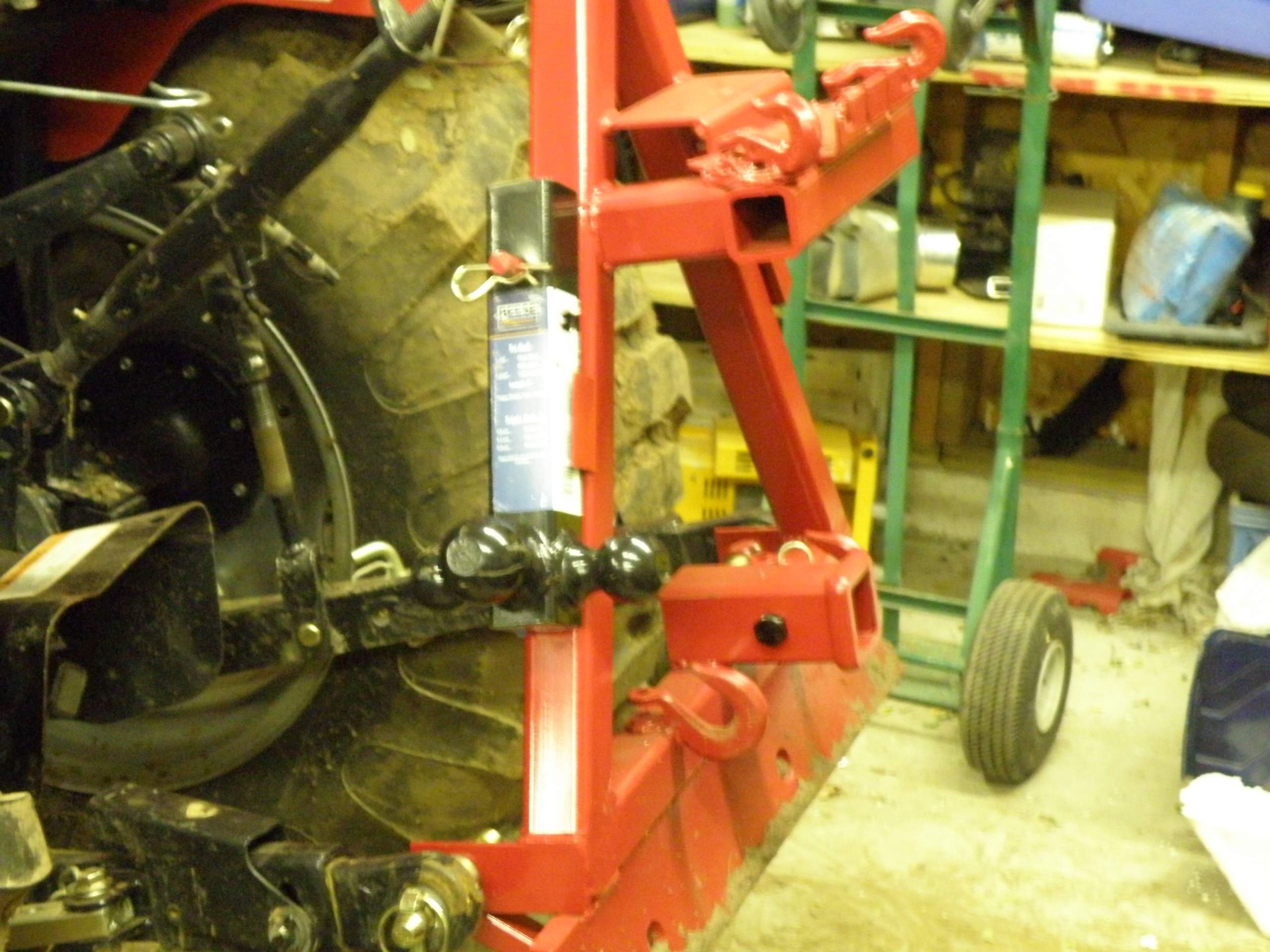

Great site lots of toys to buy. Here's my skidder/hitch I made to haul logs and trailers it works great. I have a winch plate on mine to add later if needed. On the bottom I mounted a blade to push logs with out having to turn around and use the FEL.:D

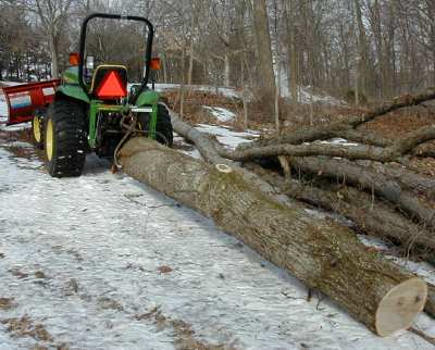

Here is pulling in a white oak with the hitch and tongs. I'm just starting to cut and log about 50 ash trees for firewood splitting.
Hey - I like your setup, blows my idea away. Wish I had welding skills like that. Looks like you really know what you are doing with that stuff, very nice. I'd like to see it with the winch on there too. Can you make us all one?:D
   / Amateur log skidding with B2620 #16
My welding skills come from years of my dad owning a heavy equimpent company and living on a farm.
It did not take very long about 5 hour to assemble and took longer to paint.

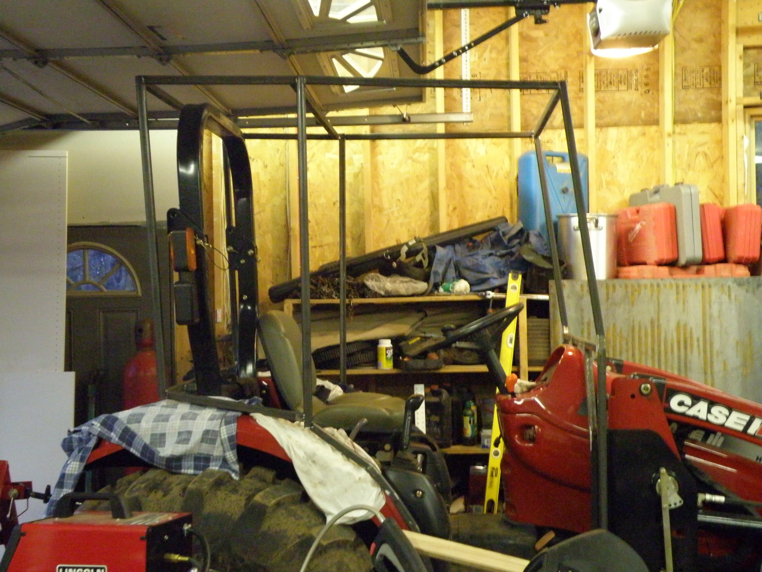

Don't have time to make a another one all of my time is being consumed by the cab I building. Have not started a Thread yet but will soon. Maybe I should market them:rolleyes:

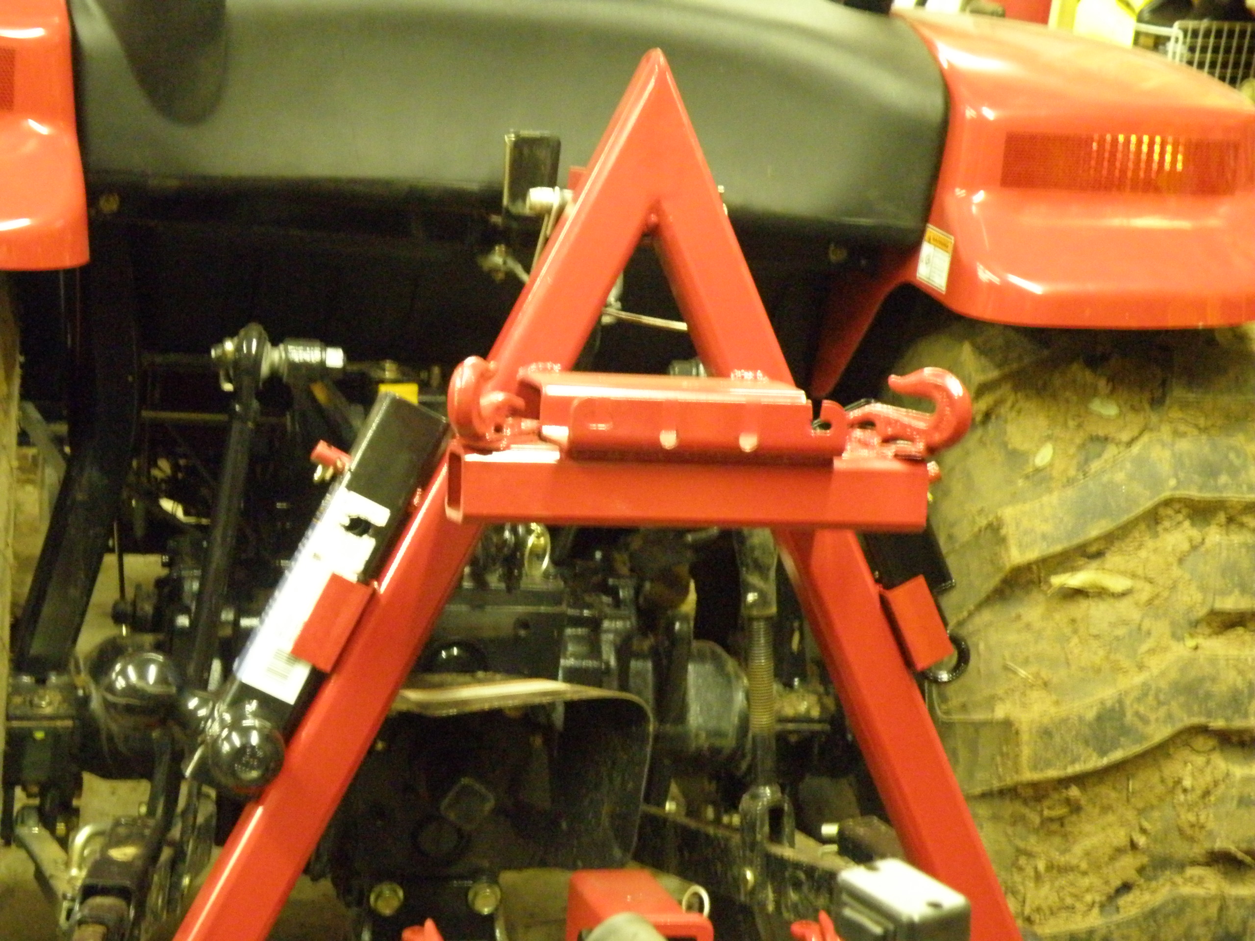

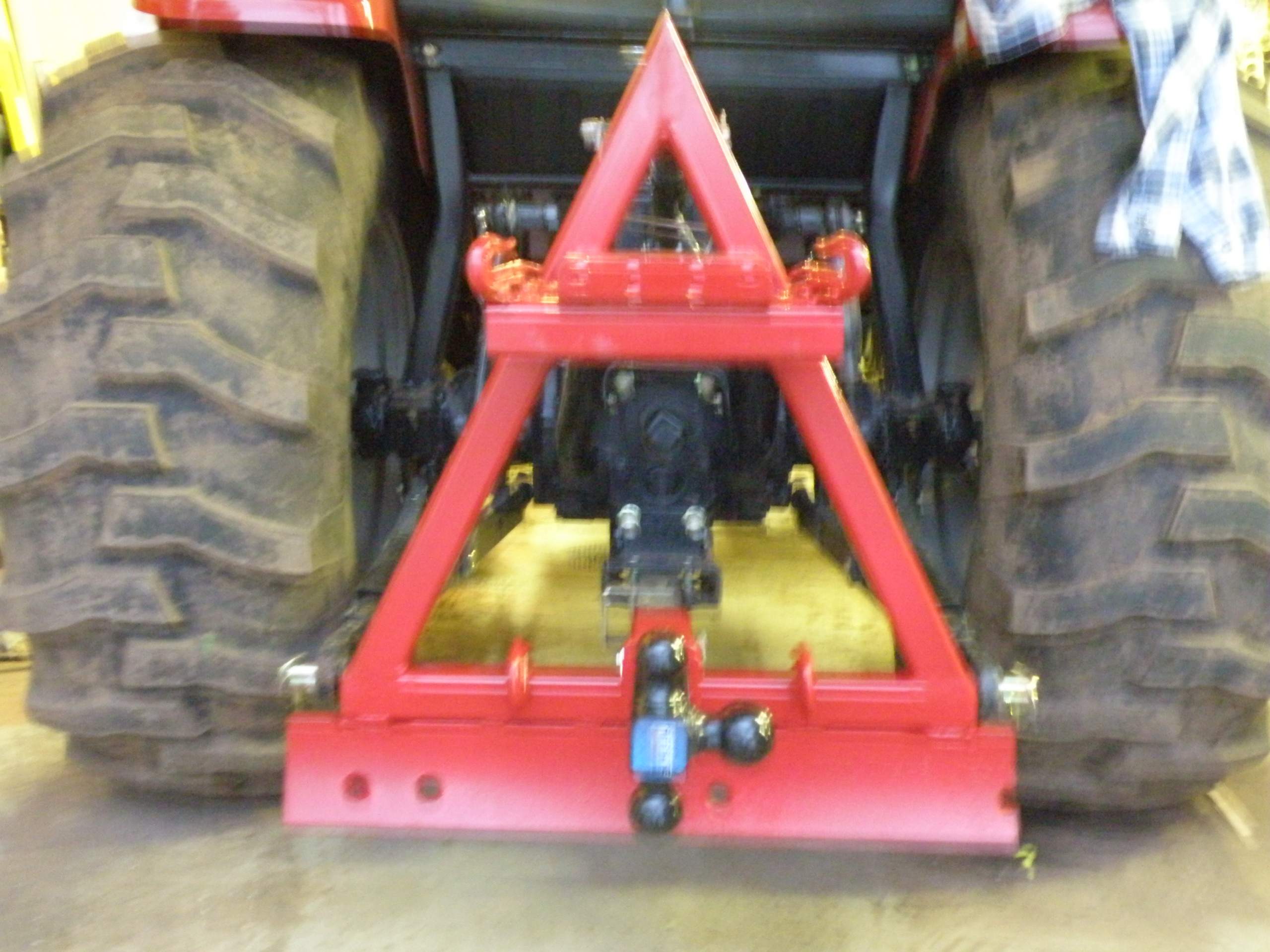

Have been taking lots of pics. The other day added hangers to hold my hitches on the sides.

Nice work.:D
How does the rear blade work for moving dirt humps etc when you are backing in to hook onto logs?:D
   / Amateur log skidding with B2620 #18
It works great for moving dirt. The only thing is I thinking about making the push blade bigger. :D

If you can get the butt of the log up off the ground, and BEHIND something solid, you're off to the races. My toy budget is shot for the year, so a winch isn't going to happen soon. What I may build is a half-inch thick triangular plate to attach to the 3ph, with a piece of angle welded across the upper part to hook chokers to. Lower the 3 ph all the way, hook the chokers, lift 'er up, and off you go.
Skidding from the drawbar is desperately dangerous if the log hooks solid into something. It will pull the tractor over backwards in nothing flat, you get one stab at the clutch and that's IT... a local gentleman was killed here this year, just exactly that happened.
