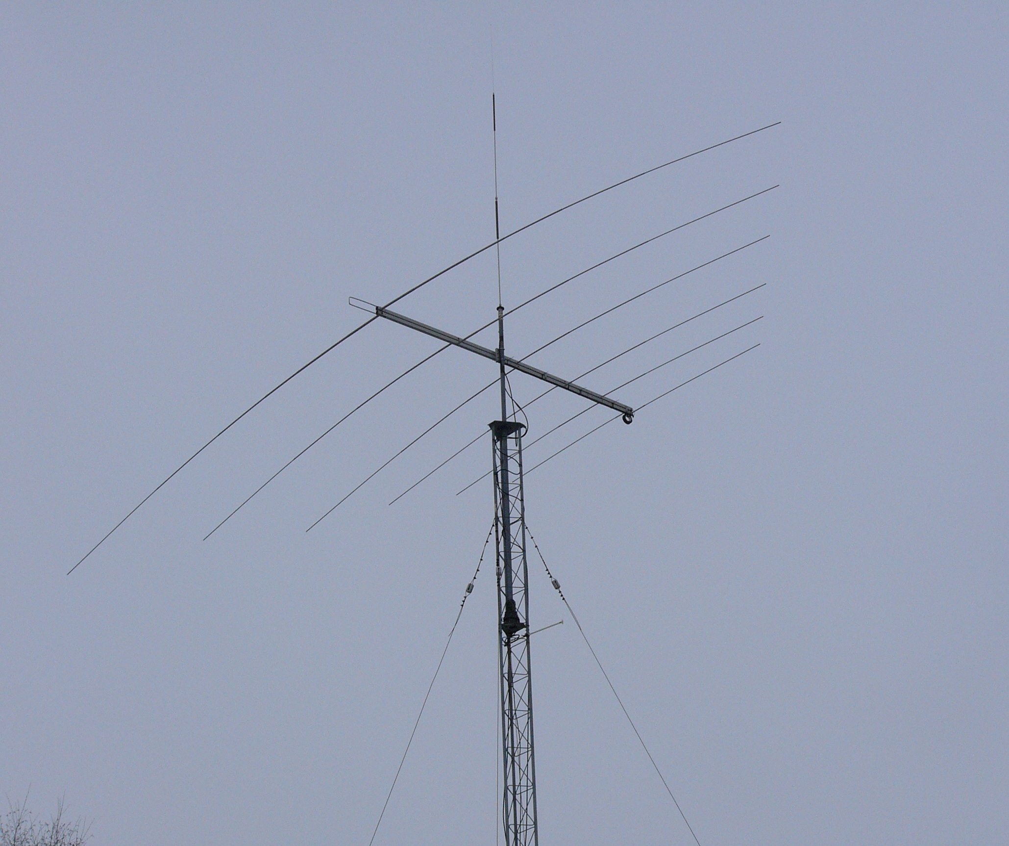

   / amateur radio #40
I guess it's time to chime in here! I'm K1HJC and have been licensed since 1959, and
currently hold an extra class license. The station consists of an Icom IC746 PRO running
100 watts to a Tennadyne T6 6 element log periodic beam up 58 feet on a Rohn tilt-over
tower. The T6 covers 20, 17, 15, 12 and 10 meters and works well. No antennas for 40
or 80 at this time. For VHF, I have a GAM TG-5-S 3-element vertical collinear above the
T6 log periodic. I've attached a couple of photos since the TBN golden rule is 'no pictures,
it didn't happen'.
