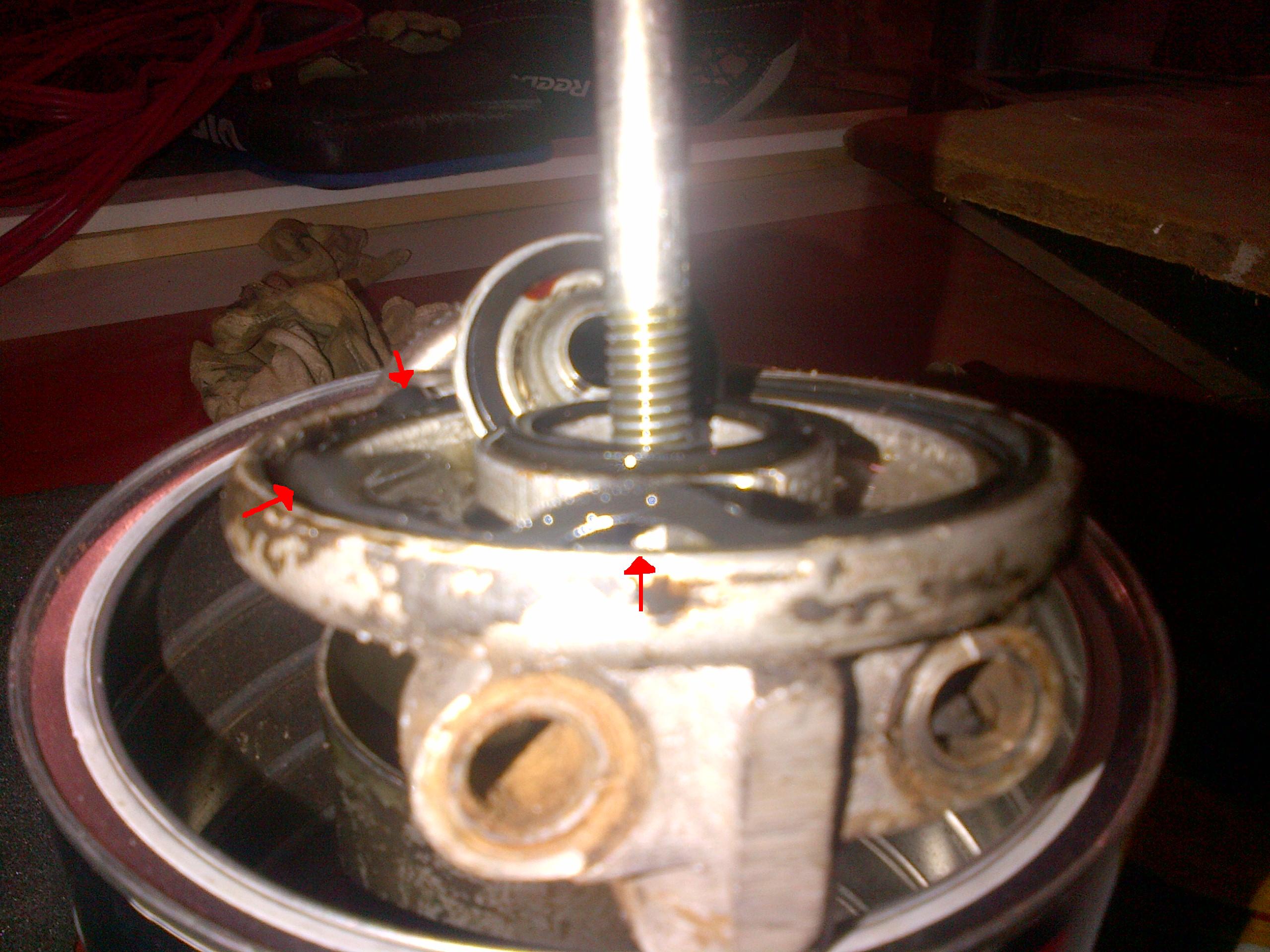

Everything had been going well with the tractor until the 22nd of Dec - got home from work and needed to blow snow. Had the tractor plugged in while I was out, so started and went in to see wifey and son and get changed. Came out to find a puddle of oil under the tractor which was pouring out of the filter assembly at the top. I tightened the bolt as a first fix, and added oil and it seemed to stop leaking. I watched it as I blew snow and twice more it started leaking (not as badly though). I did decide that I was going to convert to a screw-on filter though - I got the parts at the local dealer and the conversion went smoothly. When I removed the old filter cartridge and assembly I saw this:
Very evident what the problem was - the gasket had swollen in three places and was very hard. Has anyone else ever seen this happen? The filter (along with gaskets) had only been changed in the summer so age shouldn't have been an issue. Anyway, I've now eliminated that with the spin-on!

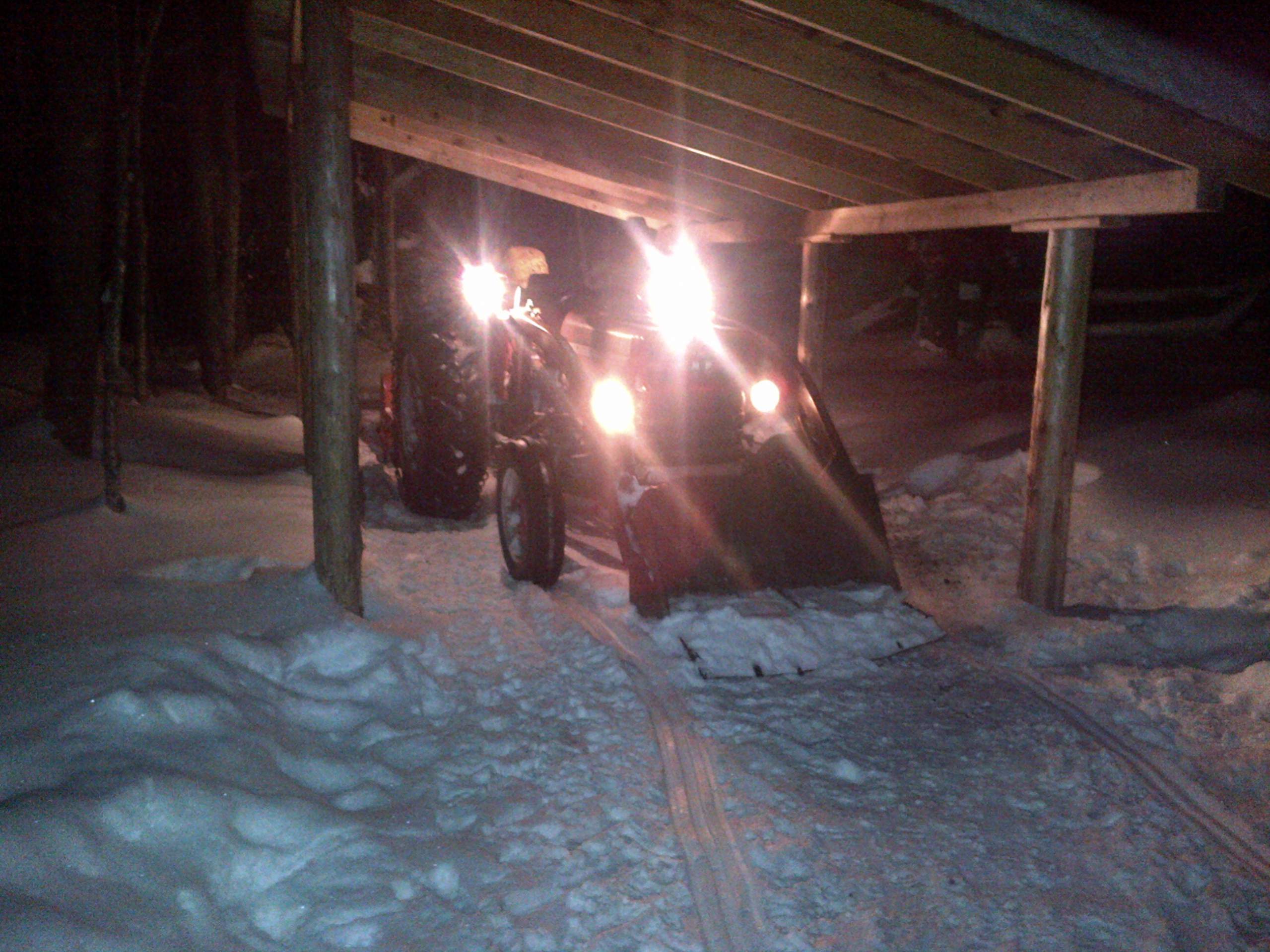

Also got lights working over the holidays!
Didn't recognize the filter and looked back in the thread to find you had a perkins diesel. I have a continental. Are you running any oil additive that the probable buna o-ring did not like, otherwise I have no idea what would cause the deformation. Great looking lights. I like the combination of the front grill and flat fender lights. It looks like you have the rear work light fixed also. I bet that makes working at night a whole lot easier.

Nope, no additives being used at all - just 15W40. It just seemed very odd to me that a few days before it had run fine and then all of a sudden the deformed o-ring. We had a cold snap, down to below -20C but that wasn't the first time that had happened either...
The fenders were originally from an industrial model the dealer told me, and there are 2 lights facing back just like forward. They had a red film over them originally I'm assuming maybe to be used as a brake? I peeled the film off and wired them to allow both to serve as work lights. Of course with the holidays and being off work I've had no need to blow at night yet so haven't been able to give the lights a true test - I'll report when I do!

I had a 135 with a perkins for 27 years and I never had an "O" ring fail like that

I guess I'm just lucky - I haven't even had mine for a year! At least I do know it won't happen to me again though!
The dealer said the only issues he'd heard of with them was if they weren't seated properly in the groove - but that doesn't appear to have been my problem. The ring was seated properly every where else except for where it swelled. I still wonder if it had something to do with the extreme temperature swings we'd been having.

Finally had a chance to put my lights to the test last night while blowing and I must say it was a treat to have them! Only negative was that one of the bulbs blew after about 5 minutes - I guess not surprising since the previous owner never used them so it's unknown how old they are. Just need to find a good place to get them now...
