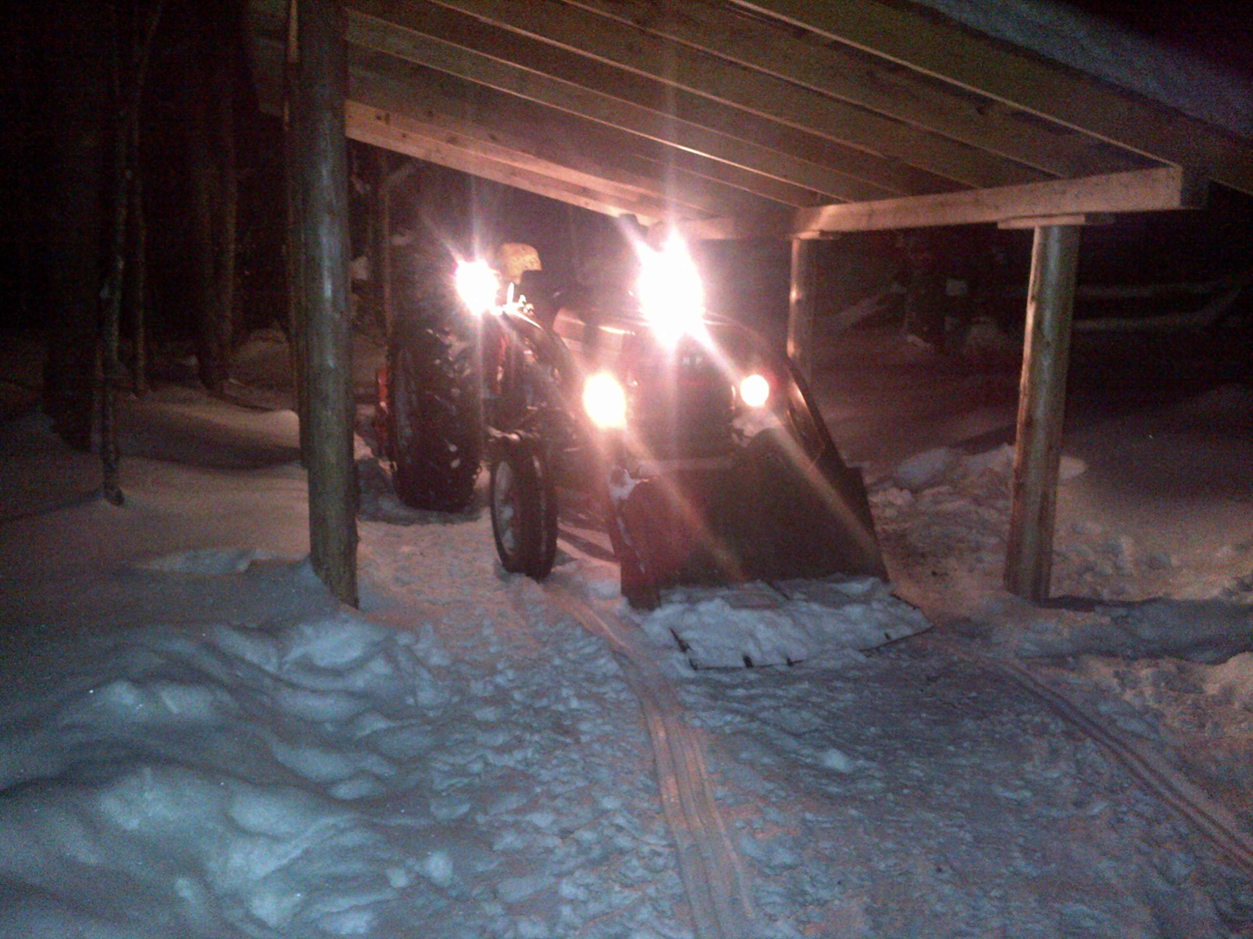

I was in the same situation when I did mine. I just got done rebuilding the engine and didn't even have the loader back one when the snow started and seemed to never stop that year. I was under the gun the whole winter. started out with a back blade until I got the loader on. Then added the chains but had to go slow till I got the rims moved out. It was a real chore I don't want to go through again. I mentioned earlier in the thread about the heat houser. I think you found a picture of one but I finally got pictures of mine I will post when I get home later.
   / AMD's 1968 MF 135 #67
heres pictures of the heat houser, front mounted auxiliary hydraulic system and the two spool auxiliary valve on my tractor.

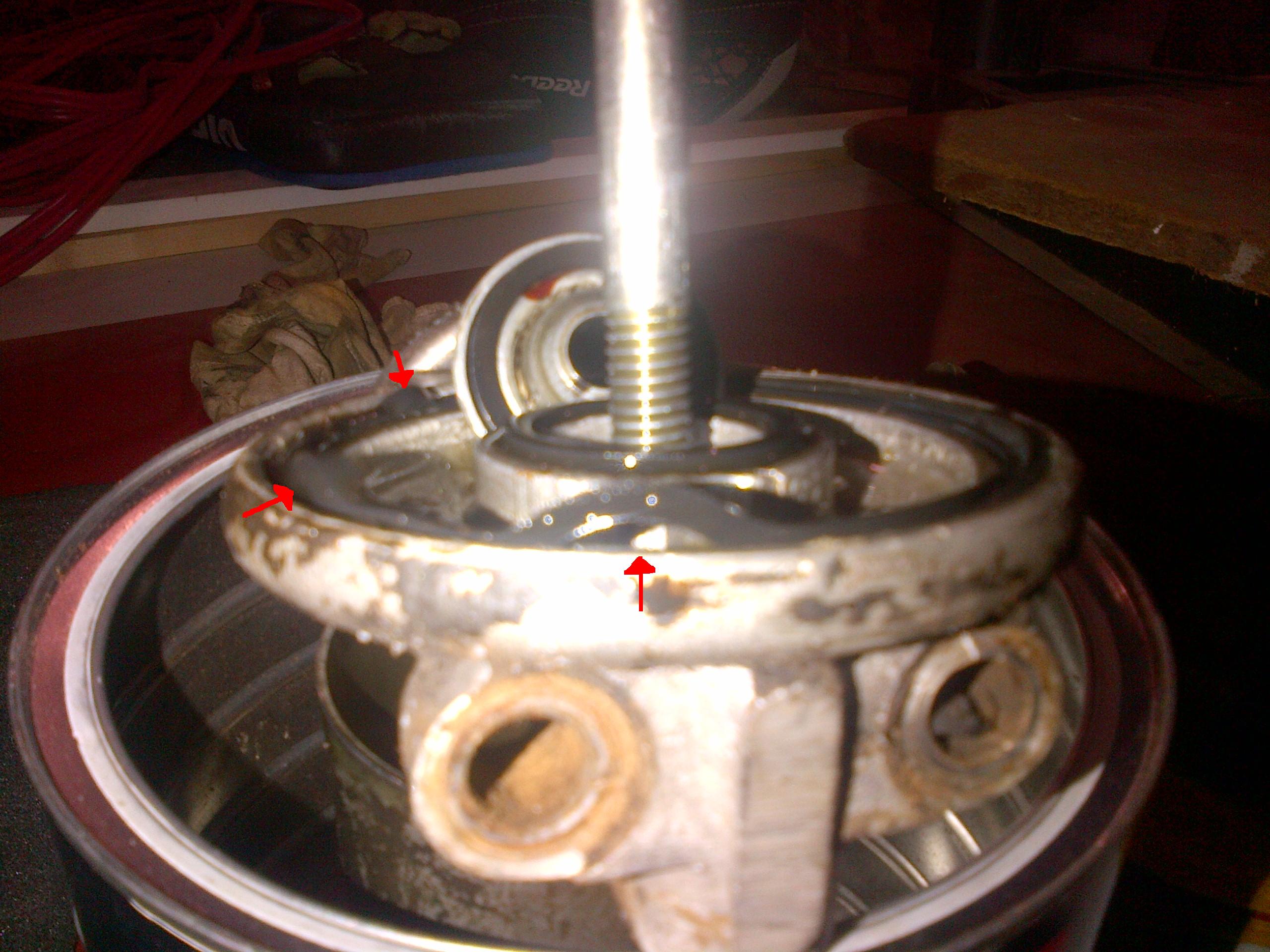

Everything had been going well with the tractor until the 22nd of Dec - got home from work and needed to blow snow. Had the tractor plugged in while I was out, so started and went in to see wifey and son and get changed. Came out to find a puddle of oil under the tractor which was pouring out of the filter assembly at the top. I tightened the bolt as a first fix, and added oil and it seemed to stop leaking. I watched it as I blew snow and twice more it started leaking (not as badly though). I did decide that I was going to convert to a screw-on filter though - I got the parts at the local dealer and the conversion went smoothly. When I removed the old filter cartridge and assembly I saw this:
Very evident what the problem was - the gasket had swollen in three places and was very hard. Has anyone else ever seen this happen? The filter (along with gaskets) had only been changed in the summer so age shouldn't have been an issue. Anyway, I've now eliminated that with the spin-on!
