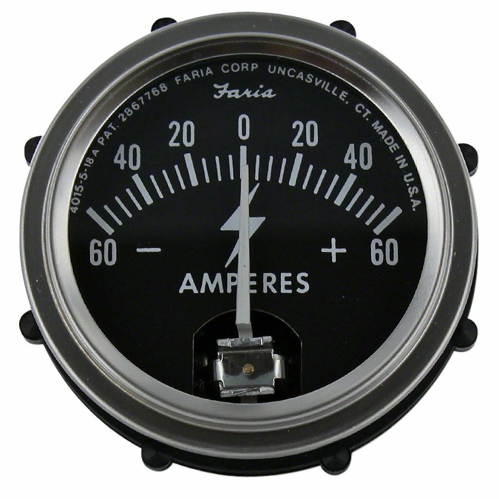

I have found a schematic from the IH 1066 Hydrostatic;
https://cdn.compknowhow.com/carterandgruenewald/wiring_diagrams/IH 66 SERIES.pdf
The + from starter (battery) goes to plus on Amp meter, the minus from the Amp meter goes to alternator "B".
It looks to me that the Amp meter shows the lights current from the battery when the tractor is not running and key switch of , and the amp meter shows charging amps only when tractor is running
Then may I conclude that it's showing me what it should be showing?
That would seem to fit what I'm seeing.... key/engine off, lights on meter showing nothing because lights are riding on battery power. Engine running, it shows alternator trying to charge battery and when the lights are on, (powered by the battery) the alternator is putting out more power to feed the battery.
If I moved (whichever wire is feeding juice to the lighting system) to the OTHER Ammeter post, would that shift those items from the battery power to the alternator power?

/ Ammeter question.... #63
Yes and No. It is showing you what it should for how it is wired.
It is NOT showing you what it is intended to show you. It should be showing you if the battery is charging or discharging, right now it only shows you if it is charging, it will not warn you if the alternator is not putting out enough power to keep up with the load and charge the battery, the ammeter will just sit at 0 amps as the battery dies (and be hard to distinguish from a case where the alternator has the battery charged and there is little or no load on the alternator.
Correct.
Big question..... "does it really matter???"
Yes and (IMO) yes.
The idea behind the ammeter is that EVERYTHING except for the starter connects to the alternator side of the ammeter.
That way if the alternator fails, you can see that the battery is discharging via the ammeter whereas now (with the lights and other loads on the battery side) you wont see anything, the ammeter will just sit at 0 amps as the battery dies.

OP, Richard: With reference to the Schematic attached by DL Meisen, I think your ammeter is connected in the lower portion of the vertical line shown rising from the Voltage regulator - instead of in the horizontal line, above there, that branches from it over to the starter.
This would explain the symptoms you are describing. -- Your ammeter is measuring the full current from the ammeter instead of the net current (as it should) to the battery.​
