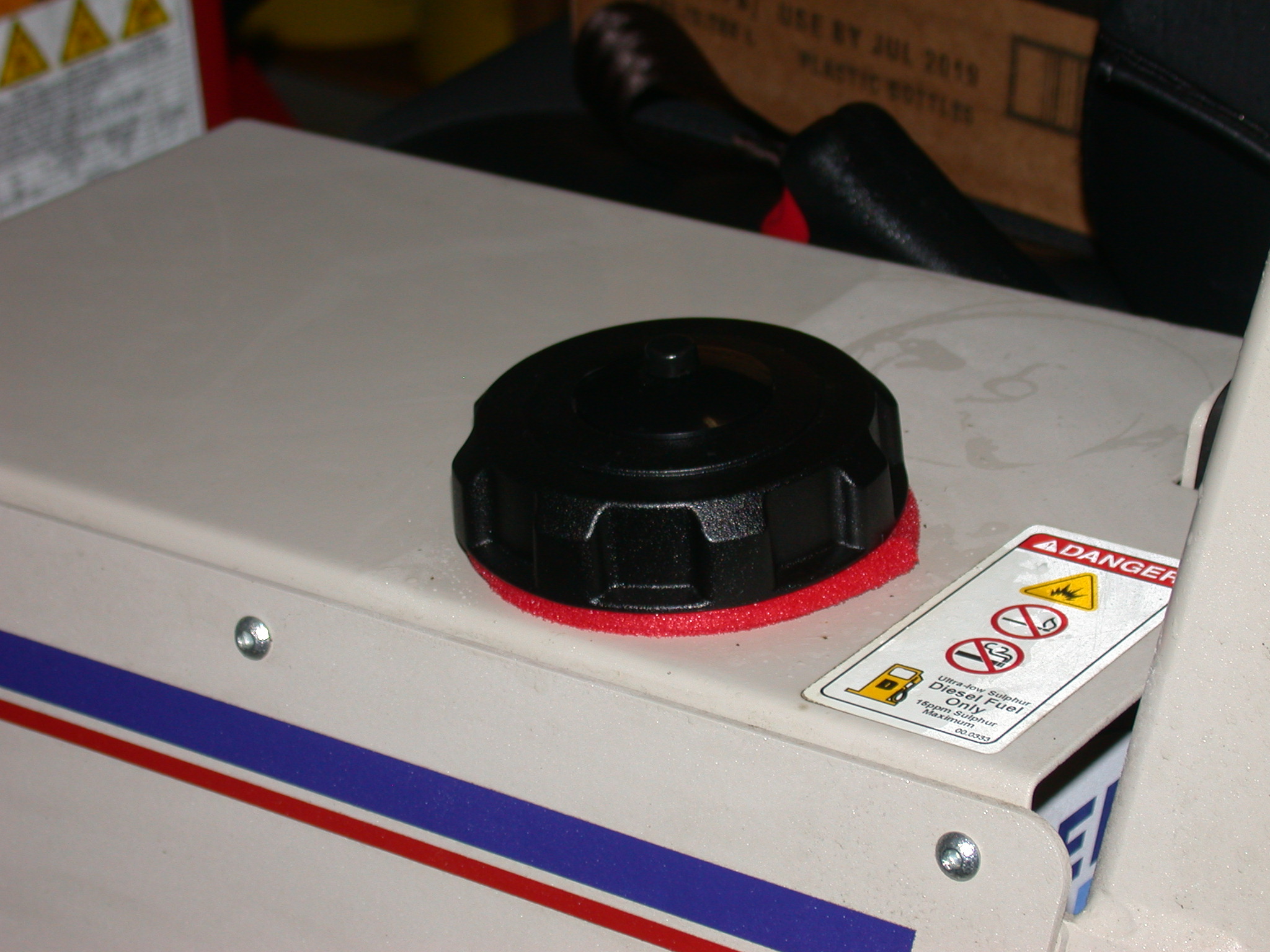

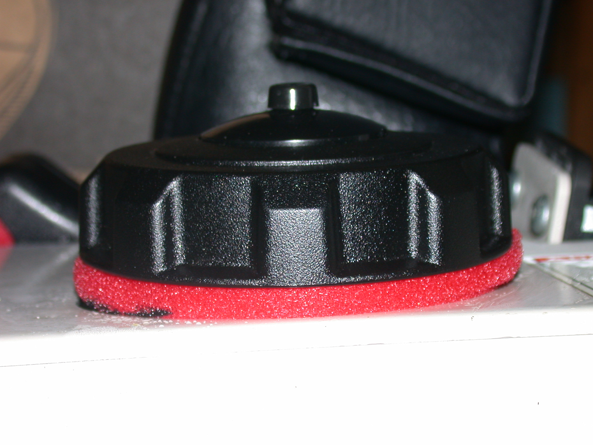

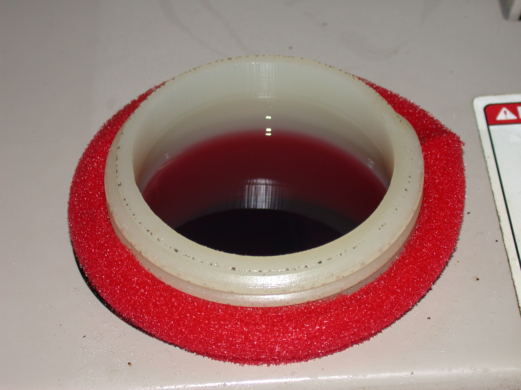

The K&N prefilters arrived at the local CarQuest on Thursday. I drove up to pick them up. After dinner, I decided to try to fit the K&N 25-1480 to the filler neck. I had to stretch the K&N prefilter a bit, but it did not tear, and I succeeded in getting it on. I did not apply oil to the prefilter before installing it, because the K&N charging oil is very sticky, and I did not want to mess my hands. If the filter seemed to fit, I intended to remove the filter, charge it with K&N oil, and then refit it to the filler neck. However, for starters, I simply wanted to see if it would fit.
It looks as if the K&N 25-1480 will do the trick. Some pictures follow.
I do not think that this will help owners of gasoline-powered Ventracs because, as I understand it, the filler cap is not vented. The vent slots on the underside of the 4500Y filler cap are fairly large, obviously big enough to let insects crawl into. I know that the insects were not in the fuel cans or in the fuel because I use a screened funnel whenever I fill up the fuel tank.
