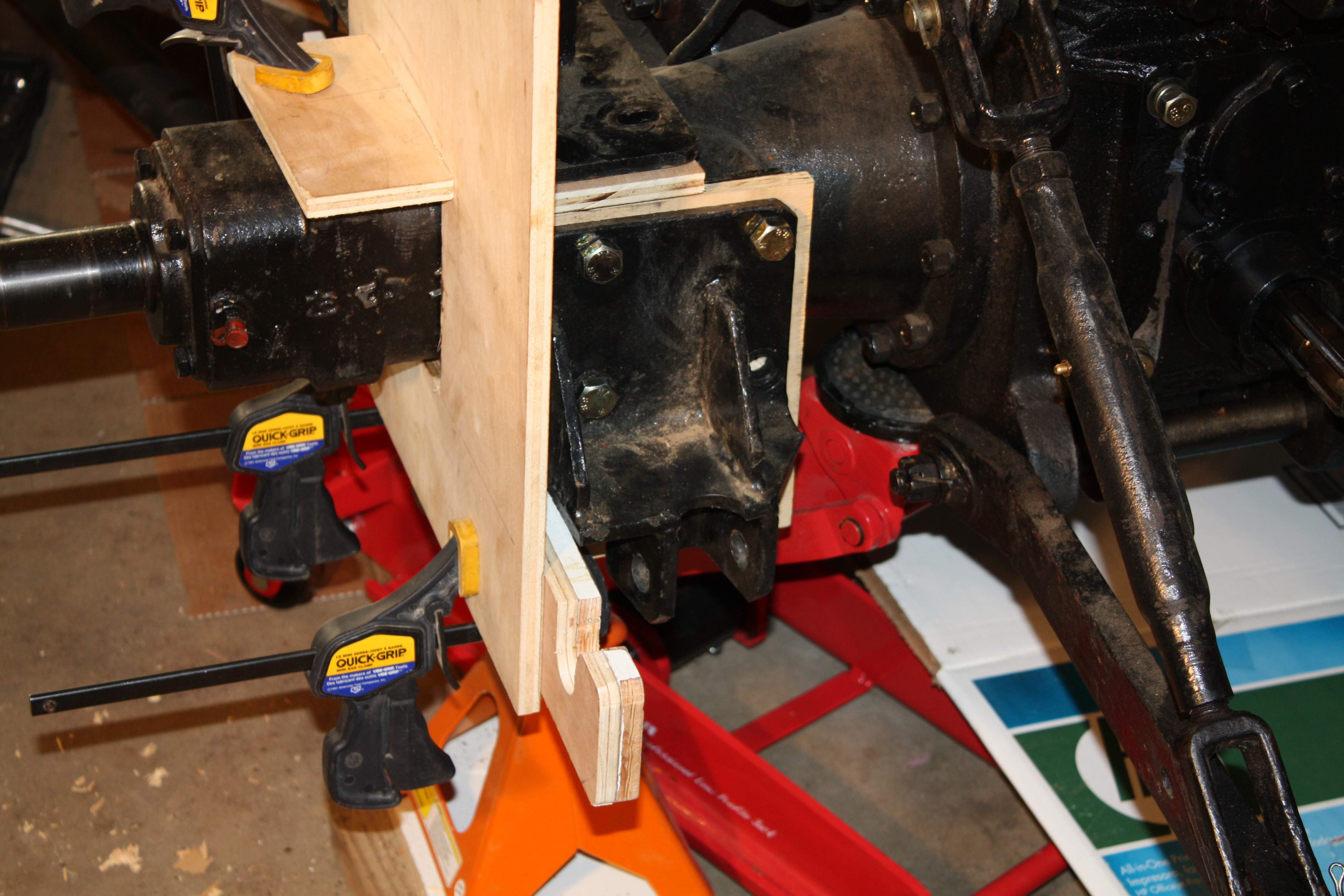

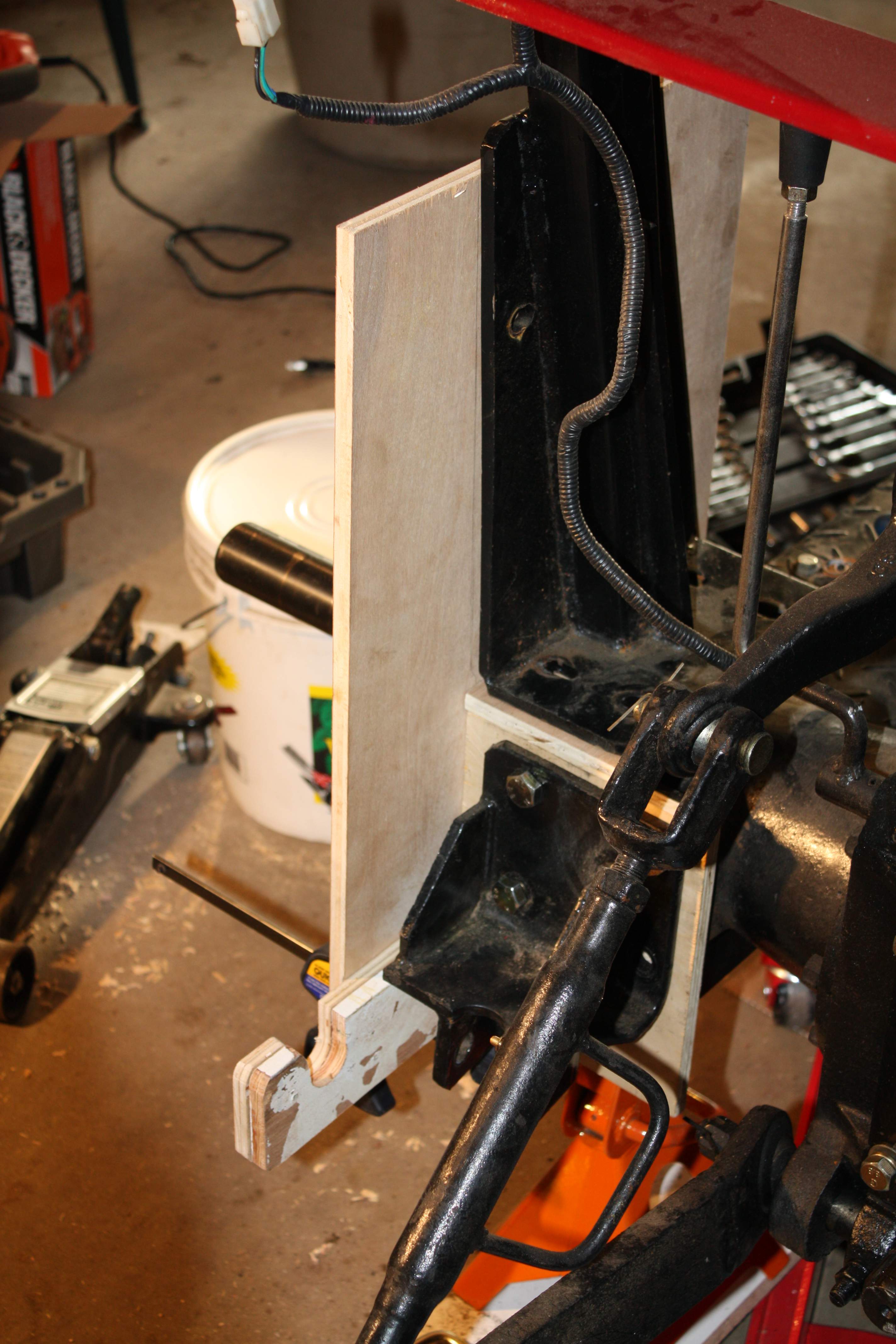

I first made some crude plywood templates as seen in the following pictures.

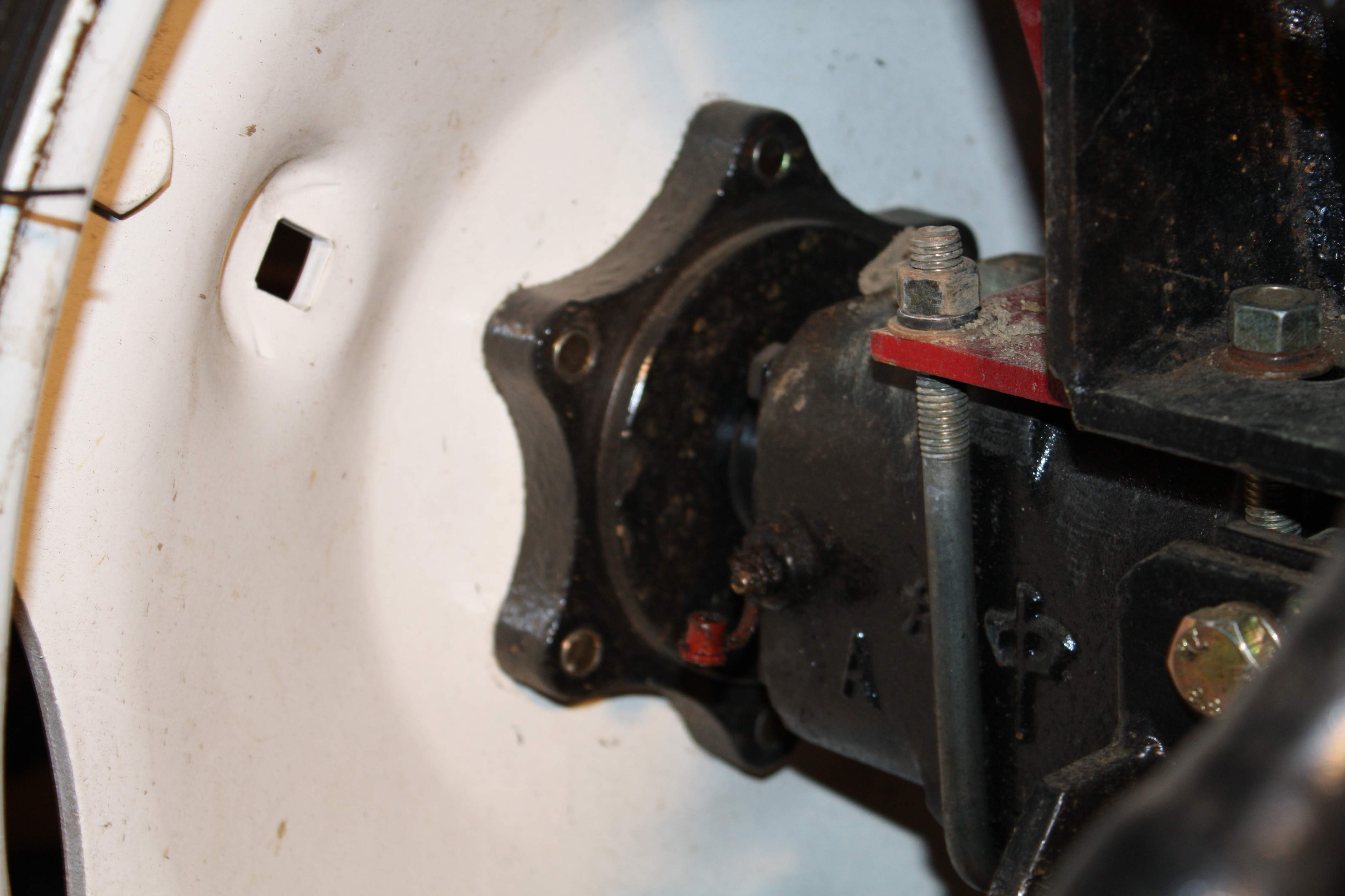

I had to remove the star shaped hub, so I could slip the template over the square axle housing (see picture).

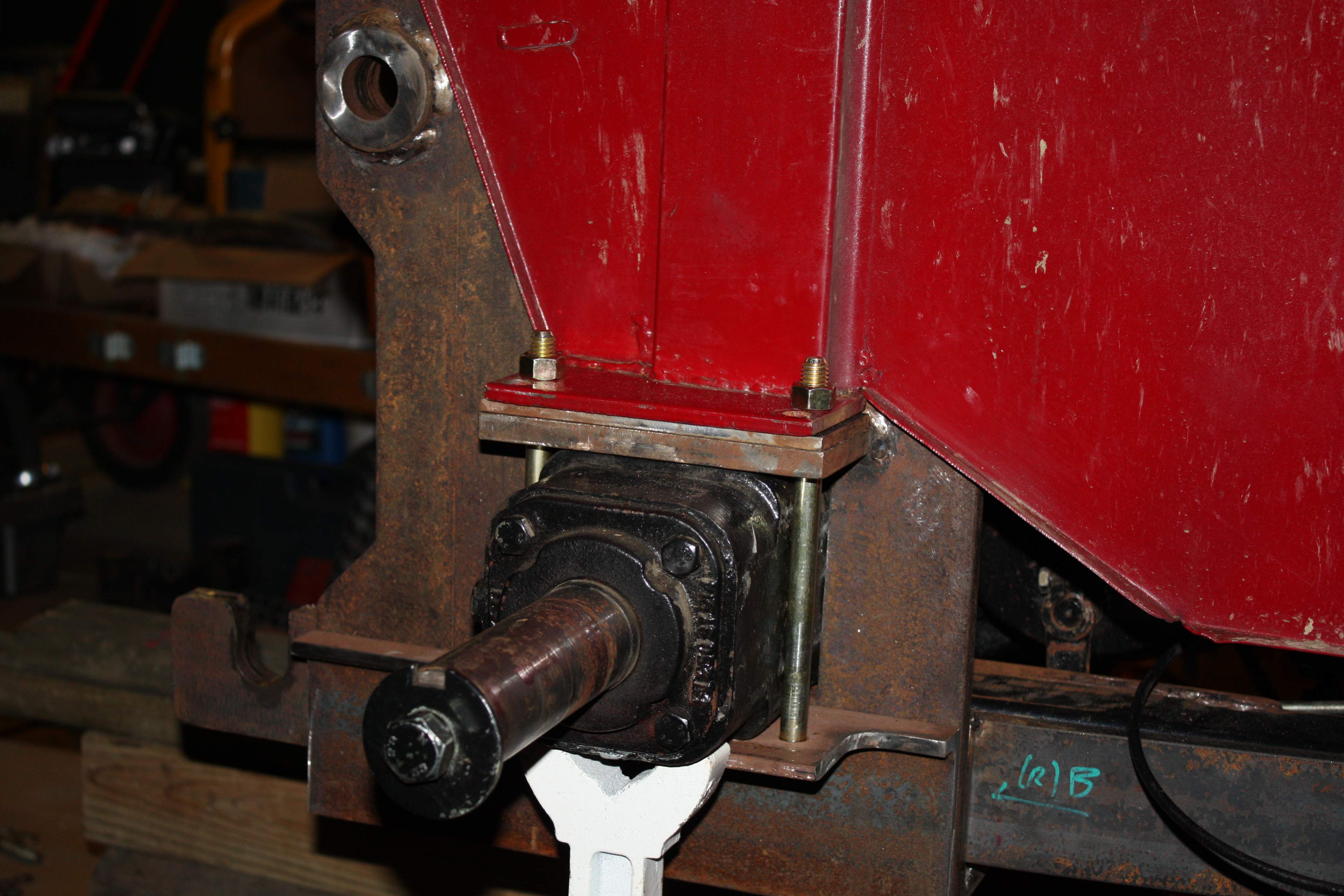

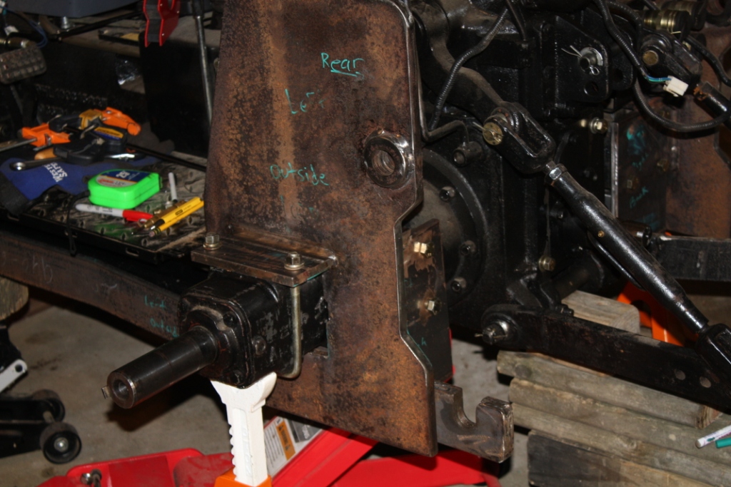

The next picture shows a test fit of some of the components I made. The vertical plate is 5/8 inch steel. It is the main anchoring component and will be attached at multiple points to the tractor. It will be attached to the axle housing using the same bolts that attach the 3 point hitch as seen in the photo. It will also be attached to the loader subframe and ROPS. In addition it will be attached to the drawbar mounting holes by a 9 inch by 1/2 inch plate that runs under the tractor. I'll try to show these attachment points in subsequent posts.049.JPG

The U bolt seen in the previous photo was replaced by 2 grade 8 bolts and an angle iron that will be bolted to the 5/8 inch plate. It will also be bolted to a 3 inch by 1/2 inch bar that runs up to the bell housing.030.jpg

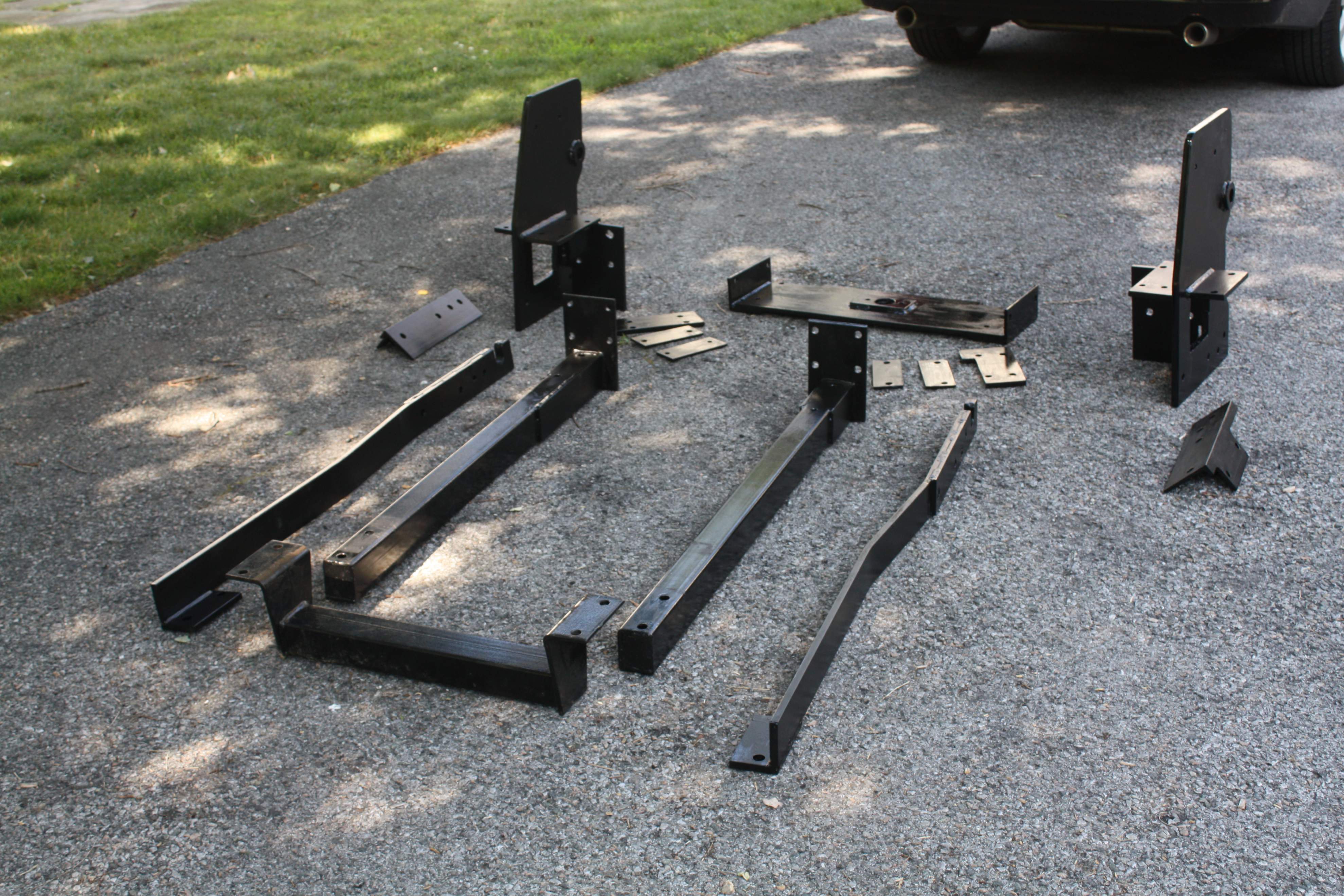

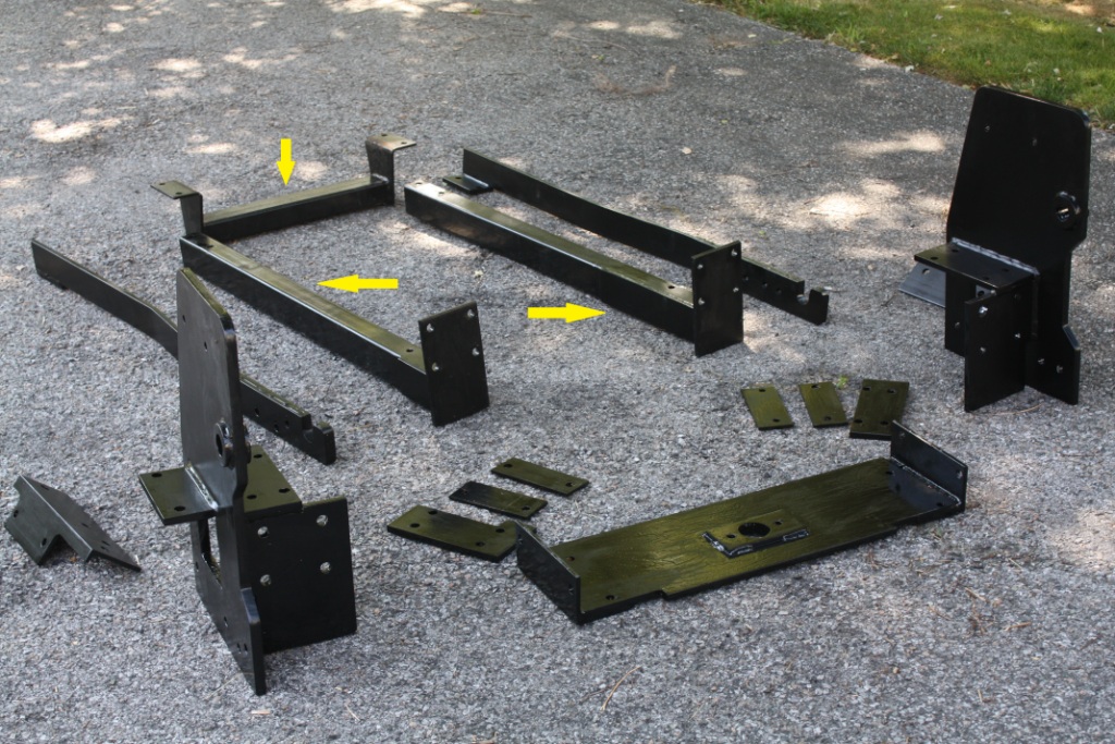

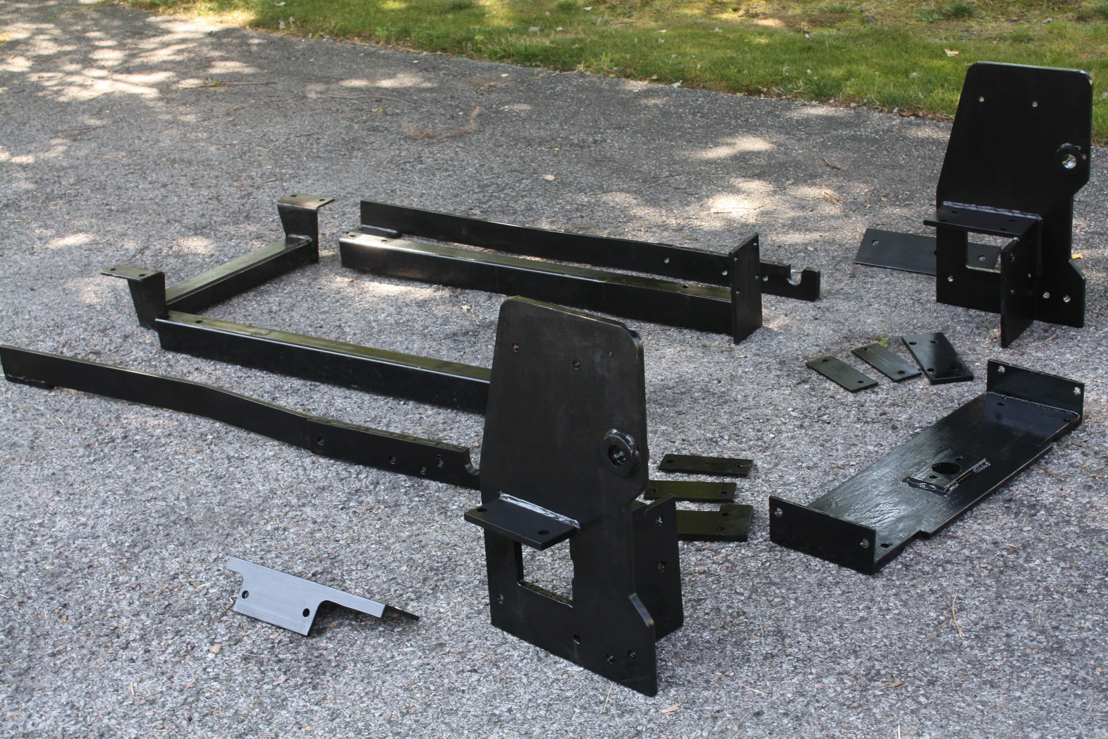

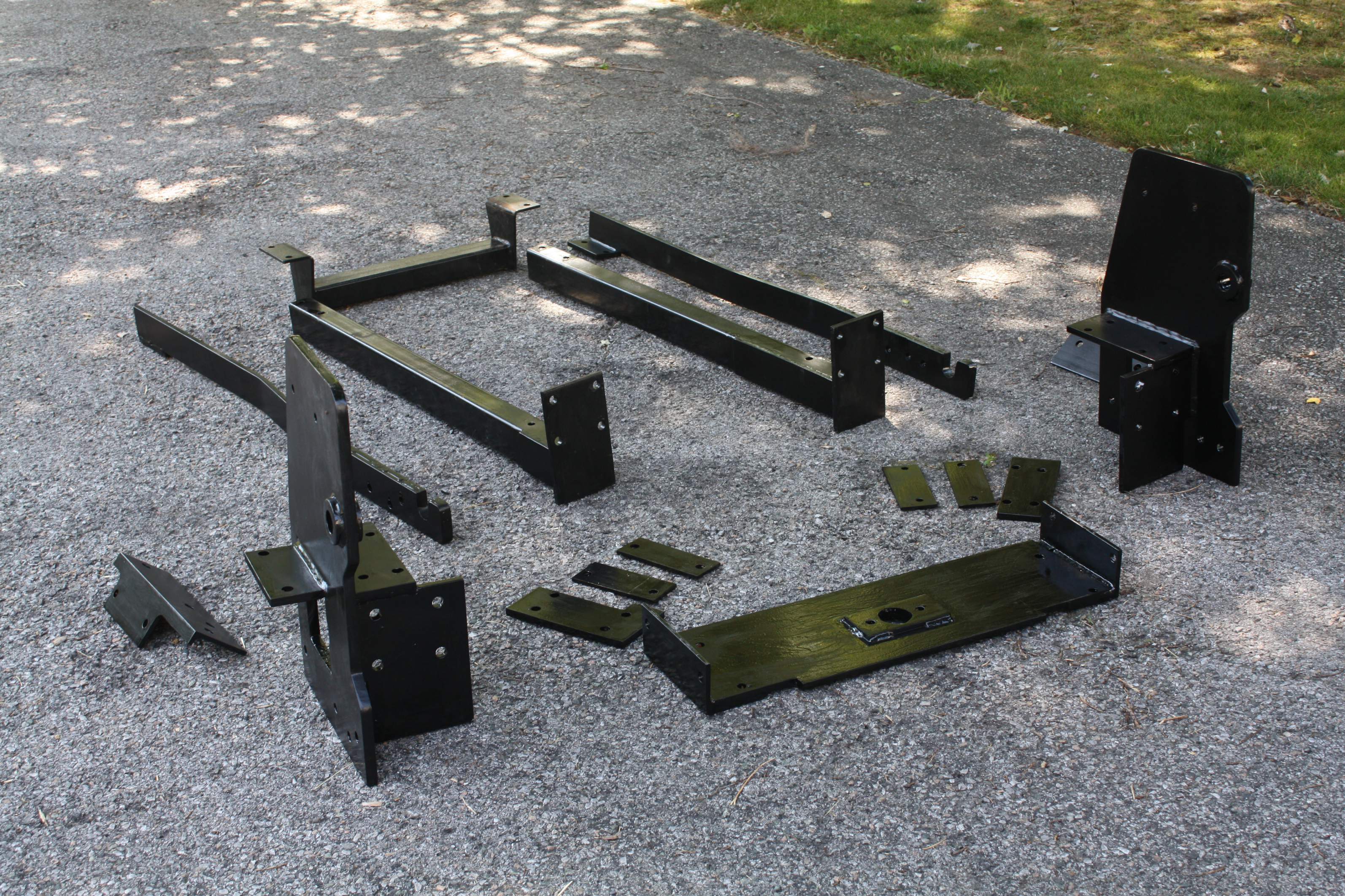

The following pictures show the parts that make up the parts that attach to the tractor. The yellow arrows in the first picture point to pieces that belong to the loader subframe. The only modification I made to the loader subframe was to weld 1/4 inch plate to the sides of tube near the back for reinforcement.

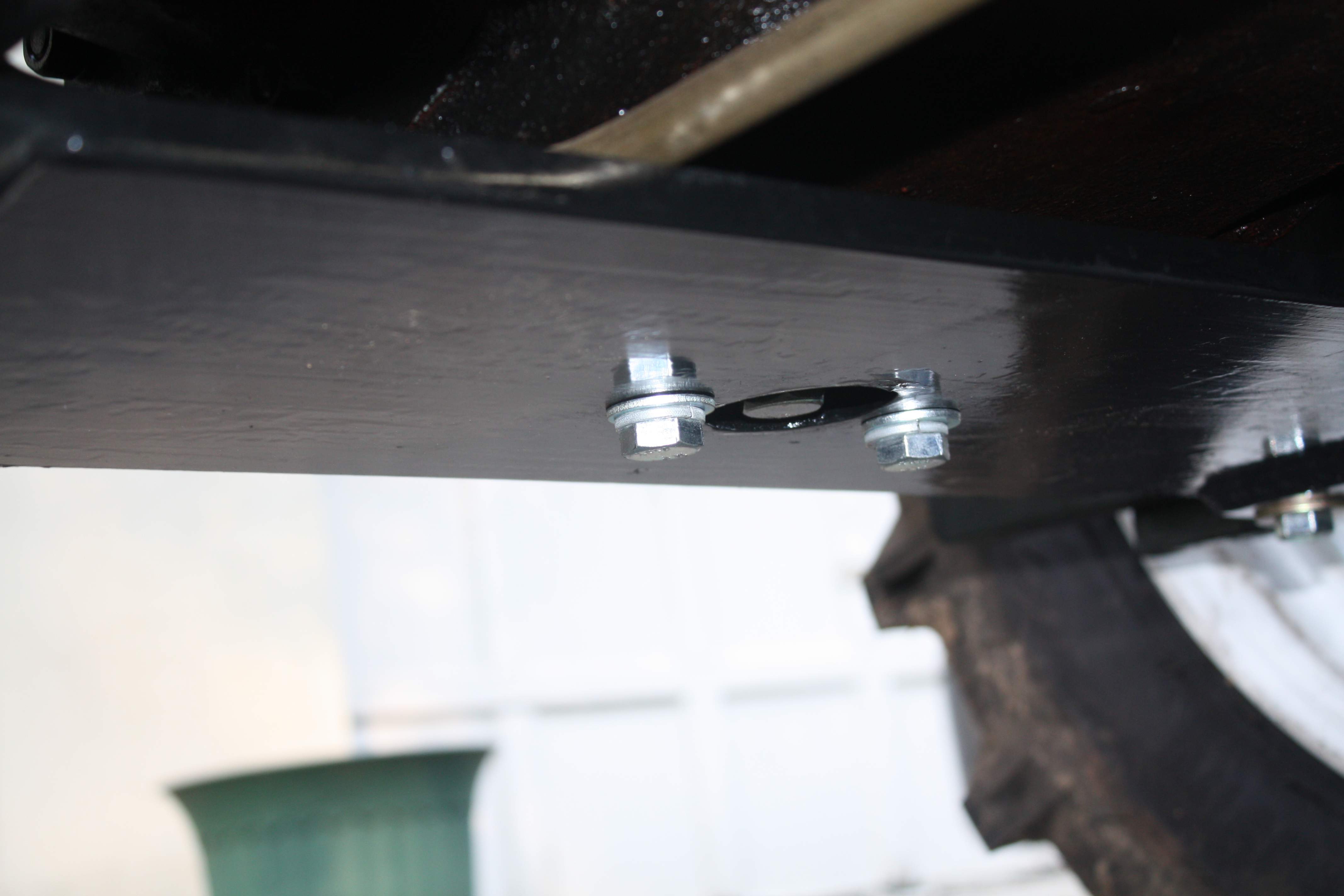

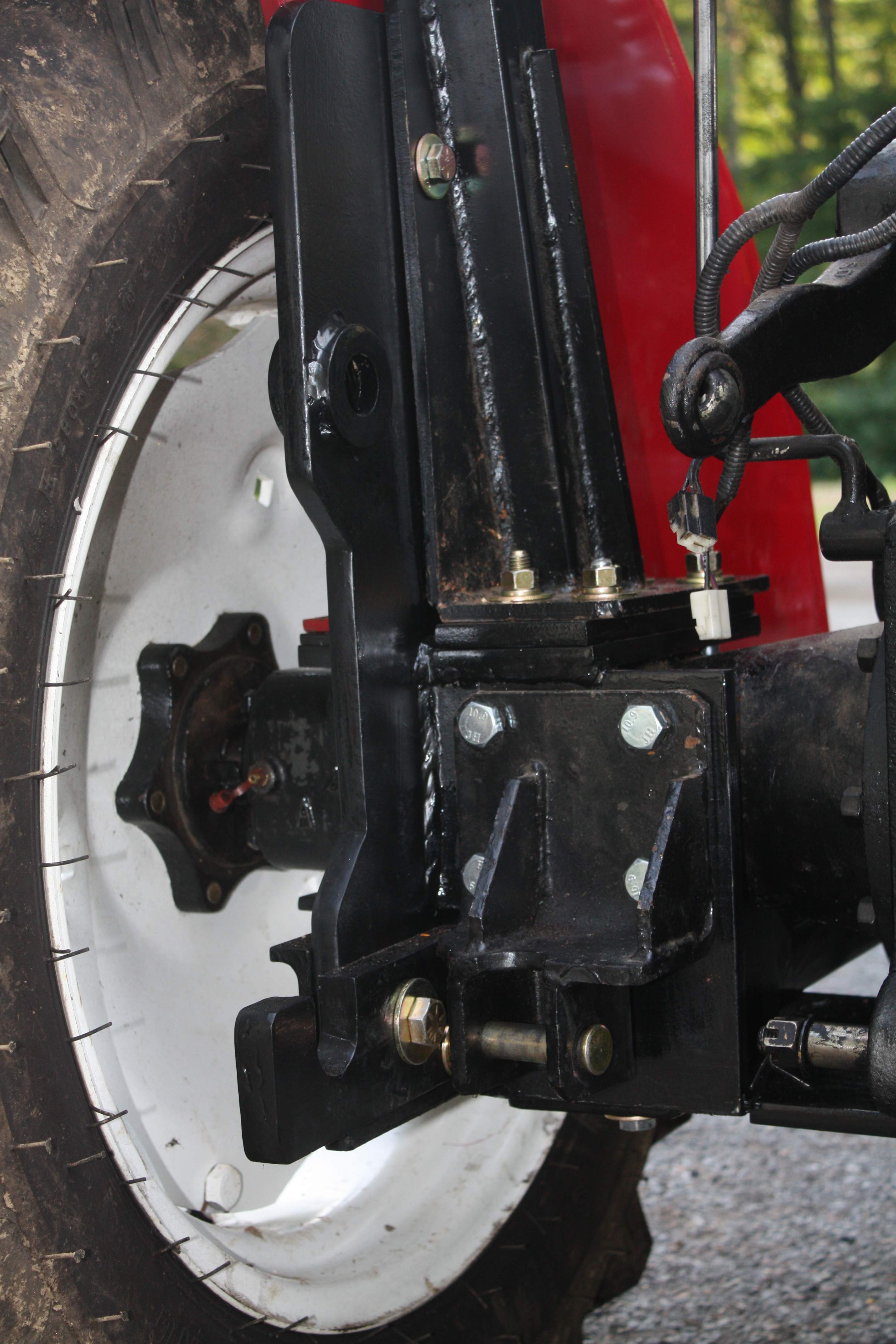

Below is the 9 inch plate shown mounted under the tractor. The hydraulic oil plug is still accessible through the hole.
The 9 inch plate shown from another angle is bolted to the 5/8 inch main bracket.
/ An "axle-surrounding" type backhoe subframe
Re: An "axle-surrounding" type subfram

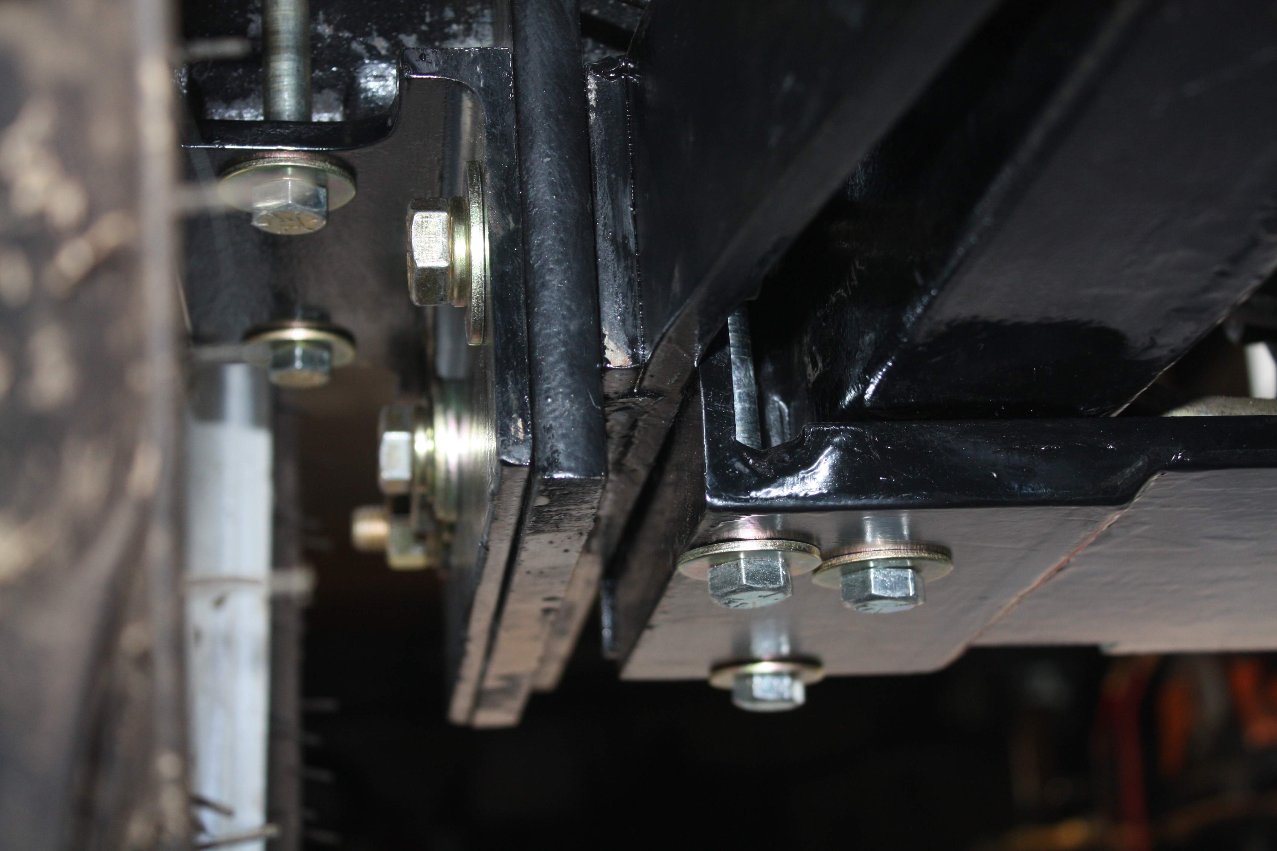

A picture from the rear of the tractor showing the mounted bracket. The bracket is bolted to the axle, ROP, front loader subframe, fender bracket, and 9 inch plate.

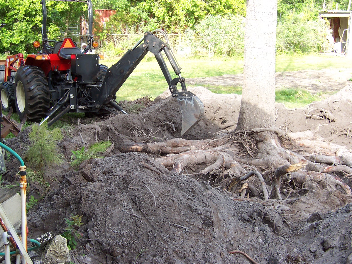

I bought a new close out LW-6 Hoe on ebay that was still in the shipping crate and modified the subframe to fit my 3510 Branson.
I have to remove the 3 pt arms and the subframe attaches to those axle brackets and top link.
In the front I made J bolts to hold the subframe to the FEL brackets.
I don't like leaving the subframe on the tractor because it gives me too little ground clearance.
The subframe is critical to keep from busting the tractor in half.
I have had a hose blow off of a fitting and had to make a couple fittings to fit US hose because my local hydraulics shop could not match up the Chinese fittings.
I also had the round loupe on the end of a cylinder rip out and had to repair that.

VERY NICE work so far.
Are you sure you arent BS-ing us about this being your first venture into metal fabrication??
ONly suggestion I can offer: I noticed some of the bolts didnt use lock washers. I would suggest it as you dont want them bolts comming loose. And its cheap insurance. I would use them on every fastner you use.
#9
The bolts in the pictures that don't show lock washers have them at the end adjacent to the nuts. In one picture, there are lock washers at the bolt heads because where wasn't enough clearance to put a lock washer adjacent to the nuts. Is there any value to have a lock washer at both ends?
No BS-ing about this being my first venture. That's why it took me over six months (having to work didn't help either). Thanks for the input.
