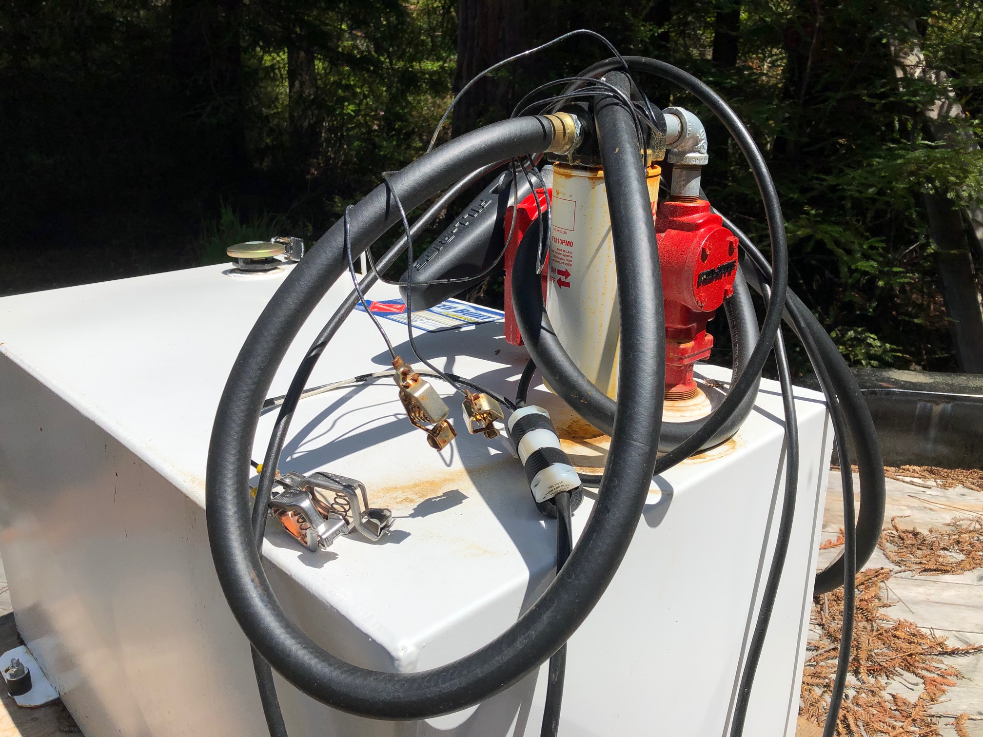

When I got a diesel generator in addition to the diesel tractor, I decided to upgrade myself from the 5 gal can. The new setup is a large diesel tank from TSC and a Fill Rite 12v pump. It is on a pallet so I can put it in the pickup for filling at the gas station, then put it in the generator shed or on the equipment generator, or wherever else it might be needed. I put a two pole twistlock connector on the power cord. In the generator shed it plugs into a dedicated receptacle hooked to the generator battery. For fueling the tractor, I use an adapter with large alligator clips that hook to the tractor battery. There is a separate ground wire that connects the pump and tank to whatever is being fueled.
