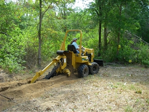

We rose early and got a good leg under us, and after a stop at a local Donut Hole in College Station for some kolaches and other assorted sugar bombs, we were waiting at the Big Rental Yard gate as they opened.

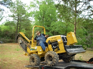

As promised, the trencher was ready to go, and the boys had the trailer loaded up and the machine chained down before I could get out of the office ... They appreciated the goodies ... I appreciate not having to dig 1500 feet of trench by hand ...
The heavy machine made the ride back to TOGR a sedate affair, but it was a nice cool morning and the back roads from College Station to TOGR run thru some lovely country ... and road signs for places like "Carlos", "Gibbons Creek", "Roans Prairie", "Iola", "North Zulch" (there isn't South Zulch it seems) and last but certainly not least, "Bedias" ...
I love it around here ....

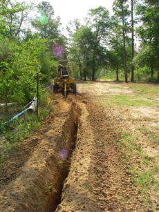

It was warming up by the time we got the trencher unloaded, and PB and I were already into the ice water supply but time is money, so I got the machine fired up and PB stood by to run interference for me so I could stay in the saddle ...

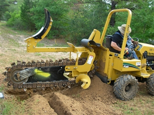

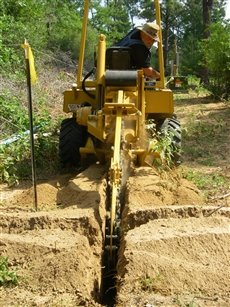

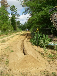

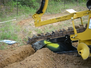

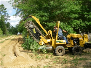

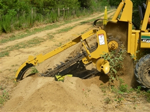

The Vermeer was the same machine I had rented before, so there was no learning curve ... I got right on with it and began making trench ...

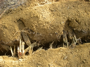

Owing to the shallower trench, the ground was cutting like butter, even in those spots with dense root tangles, and though the drought has baked the earth even harder than it was last summer, the Vermeer was buzzing right thru it, the straight-ish run of 600 feet down the driveway was cut in the first hour.
Cutting all the corners in the "back 40" took a little bit longer, but by early afternoon, the trench was done, and I was loading the machine back up.

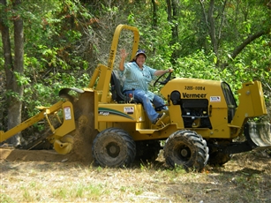

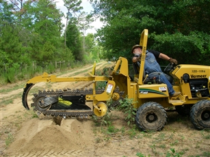

I even got Precious Bride to try her hand at running the trencher .... she finished up the last couple of hundred feet by our little pond ...
PB listened to my instructions and operated the controls with a firm but gentle hand ... Unencumbered by the male chemical cocktail of testosterone and Old Spice, she was happy as a clam at high tide to boogy along at a nice even pace ... and did a fine job of it ...
A natural machine operator ...
PB and I cleaned up, and headed back to College Station, returned the trencher and had ourselves a nice meal too.

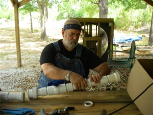

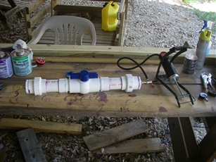

The next morning it was time to put some fittings together.
One of the suggestions the boyos at the Big Plumbing House made was not to cut into a 20 foot length of pipe if it could be avoided, as man-handling the sections in order to grind a taper onto the cut ends of the pipe would be a real PITA.
(The "spigot" ends of the pipes have a long taper to ease assembly thru the rather tight gasket in the "bell" ends and fittings.)
Instead, since most of my tap and valve locations were approximate, they recommended I cut short lengths of schedule 40 PVC and taper the ends of those stubs to fit the gasketed bells, tees and elbows and place the fitting wherever a bell worked out to be near a convenient location as I assembled the pipe.

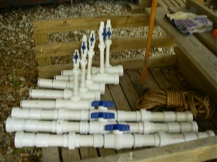

It made good sense, so I set about piecing together 5 taps, 3 line valves and 2 hydrants, as well as the valve boxes.

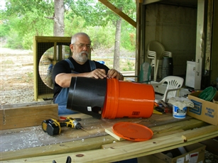

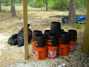

The valve boxes were a bit of an "engineering" exercise ... Most systems in this area are apparently fairly shallow, as 24 deep valve boxes were only available by special order.
So I had to improvise ... Some nice orange buckets and a bit of baling wire and we had some nice deep valve boxes ...
Throw a little dirt on it and nobody but me and the scorpions will know ....
I went a little overboard on the line valves just in case I ever have to change one out, I set them up with unions, to allow me to dig em out and then R&R without having to cut and glue PVC pipe in what would most likely be a very wet hole.
I even went so far as to pressure test them, since the only valves in stock that day were threaded, and it's a good thing I did, too, as I wound up finding and re-sealing a couple of small leaks.
I just kept after it and by days end, I had all the fittings assembled, all the tools and supplies to assemble the pipe laid out and was pretty much ready to go.
All of the assemblies were cut to length so I could just pop them into place and drop them into the trench, cover them with a valve box and move on.

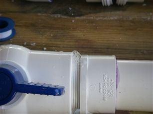

While building all of the taps and valve assemblies, I found that even when cleaned and then lubricated with the official grease, the spigots could be a real bear to stab thru the gaskets located in the bells, with my gymnastics looking nothing like the pictures of the happy workers in the instruction manual, joyously assembling pipe 10 times the diameter of my little blue straws by hand ...
I figure that ultimately this is a Good Thing, as the tight gaskets will be less likely to leak later on, so I set out to figure out some sort of gizmo to make the work a bit easier ....
In my tool bin I have a couple of wire-rope come-along's, my favorite fence stretcher (a small boat winch) and all manner of slings and ropes etc, but it all seemed so cumbersome .... as I was sitting around looking at all the junk in the back of El Trucke, I spotted the solution ....
I tried using a lightweight ratchet tie-down ... The little ratchet winch put an amazing amount of tension on the rope slings, so much so that the slings just slid down the pipe ... so I cut down the webbing to make a ratchet section to about 3 feet and used the rest of the flat webbing to make a pair of slings ....
Perfect ... the webbing fetched up tight and the shoulder of the bell end provided enough of a hold-fast that I didn't even really need the second sling.
The photo explains it all, and I heartily recommend you consider such a tool if you use similar pipe.
