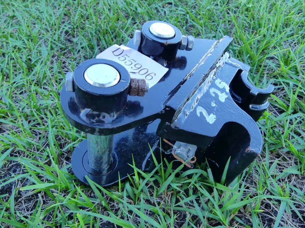

Having refined my technique the previous day, I woke up the next morning a certified pipe-slinging Jedi Master, and by noon, I had reached The End of The Line ...
ry%3D400
ry%3D400
ry%3D400
ry%3D400
I was sorry to see it go, but I took the excavator back to the Big Rental Yard and sadly gave up the keys ... I had taken the time to wash the dirt off with my brand-new water hose, and the Boyos showed their appreciation for my efforts by only charging me a half-day for the second day
I like these guys .... there will be more donuts in their future
