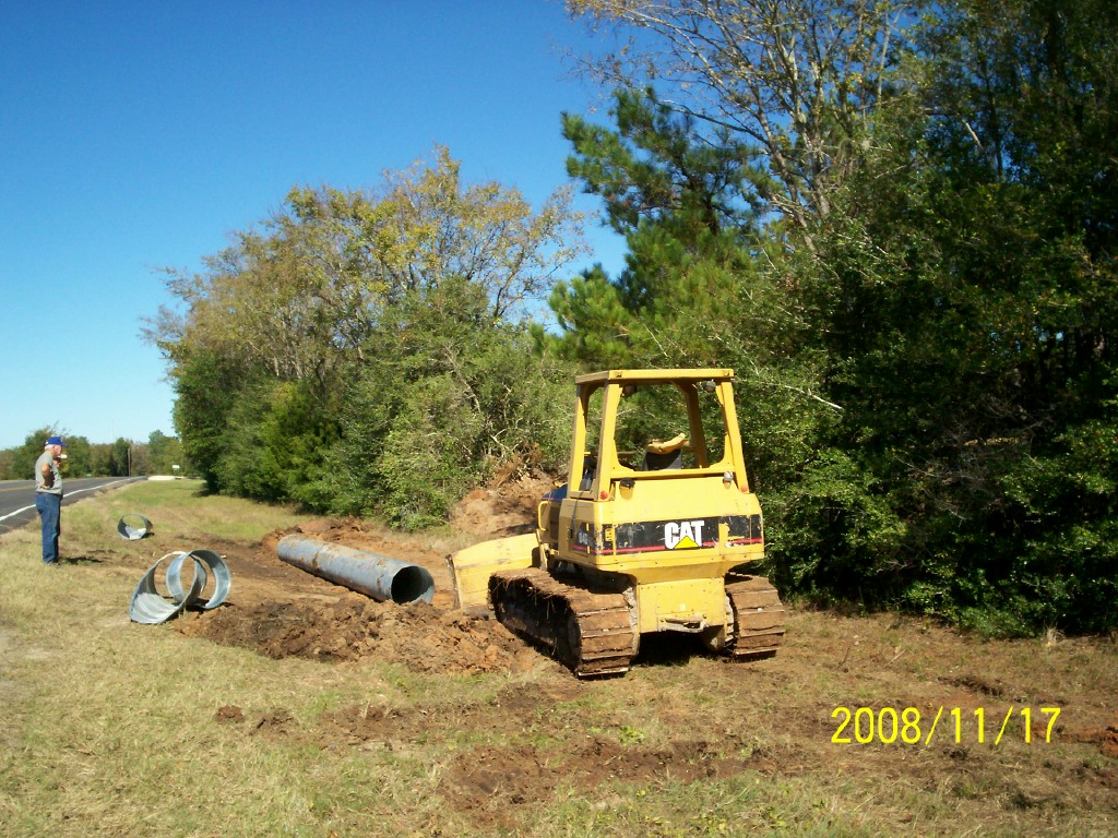

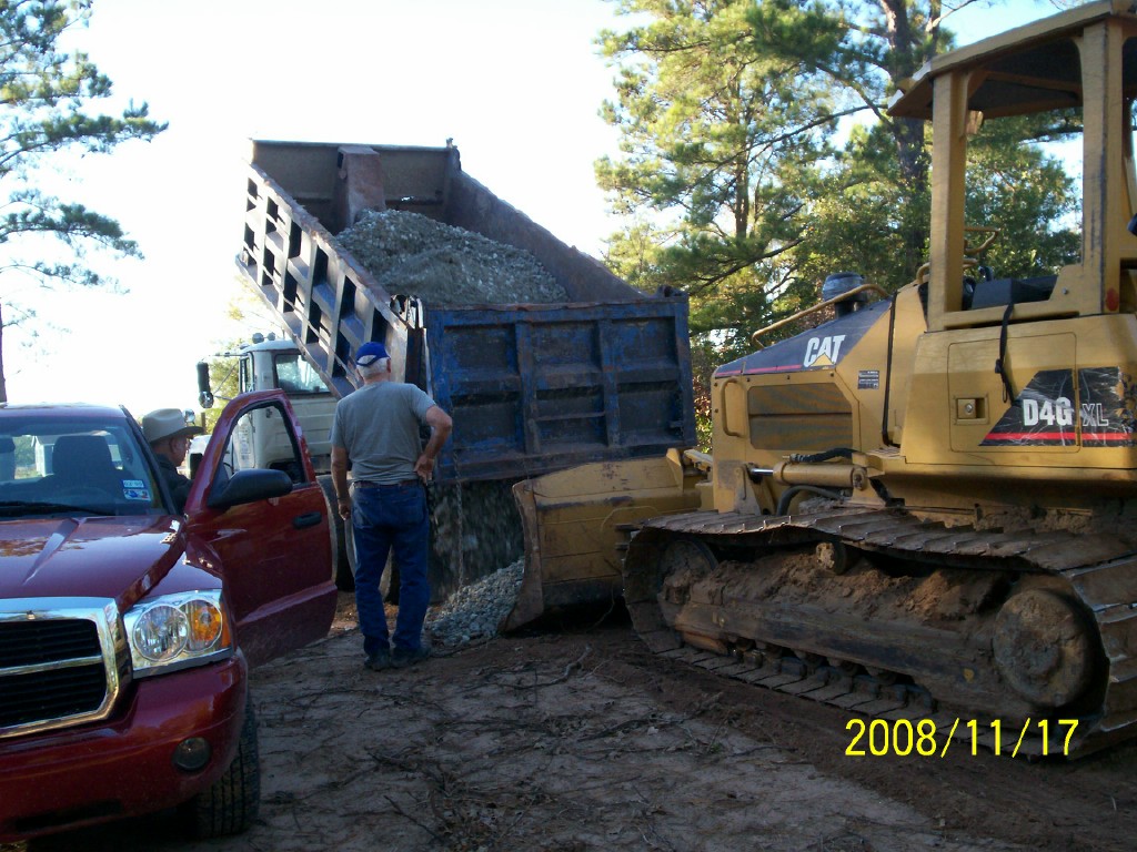

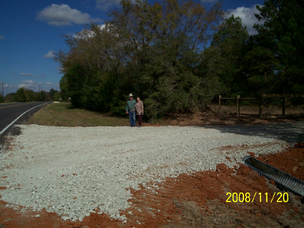

Found some photos of the culvert and front entry installation at my place...
The perimeter fence was completed at this point...fortunately the weather cooperated during the fencing work, allowing the dozer and fence crews to cross the shallow drainage ditch with their trucks...
The concept sketch is done in "Google Sketchup", which I cannot recommend more highly as a tool for ensuring that your ideas are accurately translated into reality. When you can stick a clear, detailed sketch of your dream into the hands of a competent craftsman, half the battle is won....

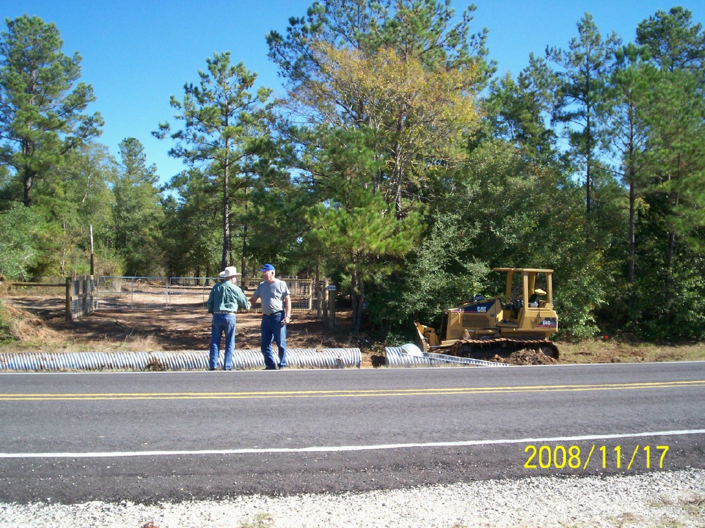

Since this entry fronts a State highway, therefore crossing a State easement, "TXDOT" (Texas Department of Transportation) is the controlling and permitting authority....which is not as bad as it sounds...the area engineering staff was easy-going and clearly explained the process for gaining approval, provided a list of approved contractors and were in general were very easy to work with. Of course, we took the time to contact them and followed the rules...being "Texas Friendly" has got to work BOTH ways...
The "men at work" in these shots are my Father-in-Law, retired after a lifetime building and repairing railroads, and our "Zen Dirt Master", piloting the CAT....between the two of them, they have dumped more dirt out of the cuffs of their dungarees than I've walked over...you can't ask for more experience...
As the entry is on the high side of a curve, "Dirt Master" counselled us to increase the "sweep" of the driveway....it took a couple more loads of rock...and am I ever glad we took that bit of advice....
Pulling in or out of the driveway with a loaded trailer is a snap...it could have been a real safety issue with the traffic on the highway...
The "take home lesson" here is....seriously consider the advice of anyone who has engaged in a craft, skill or trade for 40 years...sometimes it isn't just the money...
"Dirt Master" did a fine job...up to the high standards of TXDOT and the FIL ...but Final Approval was in the hands of Precious Bride....who you can see inspecting the hinges on our gate.

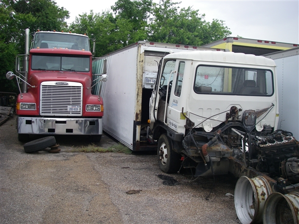

When it came time to buy said containers, however, for whatever reason and even tho Houston is a port city with used ISO containers piled up like cordwood, containers and transportation to our site cost FAR more than expected....a 20' container was going for $1200 with transport going for an additional $600 to $800 each!!!
Apparently someone forgot to tell Houston there is a World Economic Collapse going on...
Needless to say, those prices were not acceptable or apparently negotiable either...
After a little more legwork, one of my neighbors introduced me to a truck maintenance shop manager who had a yard full of old cargo truck bodies...one thing led to another, and four bodies were selected at far less than the cost of a single ISO container...$800 for the first three, which are 24' dry cargo vans and #4, a 20' all aluminum insulated box which had been heavily damaged, was thrown in free...FREE is good right?
My neighbor came thru again and had no problem finding us a trucker with a roll-off rig and time on his hands willing to haul the boxes at $400 per trip from Houston to our site midway between Huntsville and College Station...with the cost of diesel...I am content.
So we now had 4 truck bodies instead of shipping containers for roughly $2400 vs $8000. It is good to have friends with friends.
Cash changed hands, a delivery date was set to coincide with my presence in the United States...and we waited for the BIG DAY.
Which waited for me to come home from work...6 weeks later.

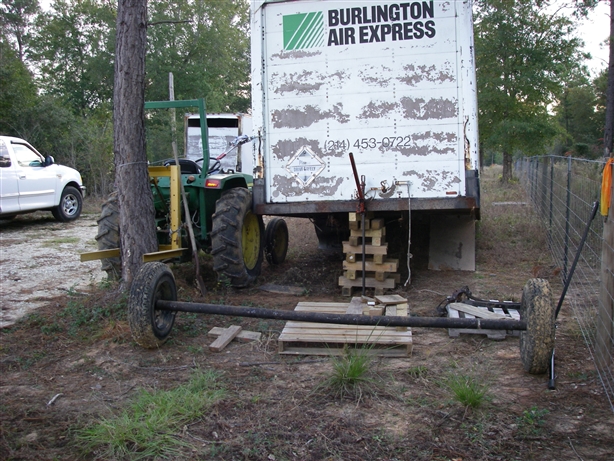

My approach was as simple as I could make it....Getting these boxes up from Houston involved putting some wheels under them...so thats what we would do to finish the last 1,000 feet....
The fellow that sold us the property, and is now our "Over the Fence" neighbor and Dear Friend provided a mobile home axle slightly longer than the boxes are wide. The axle was cleaned up and readied for the job, I rounded up all the lifting and rigging gear I owned or could beg-borrow-steal and fueled up my tractor.
First things first, I set up a "Field Office" for my "Engineering Advisory Staff" and the "Safety, Health and Environmental Department" otherwise known as my Father-In-Law, who after a childhood on the farm and 40 years building and maintaining railroads, knows a few things about things...
The Office, tho Spartan, has a wonderful view...
On the serious side, you have to understand that moving things bigger than yourself potentialy involves the sudden and catastrophic release of massive amounts of energy should your rigging gear fail....
...and that you are soft and crunchy...
Having a second set of experienced eyes watching over the job to give a little advice during the planning or at the rough spots, tocall "WOA!!!" early in a failure chain and avoid a disaster, or ultimately to call the Fire Department or EMS when the unforeseen or neglected issue bites you in the *** is an absolute essential....
A few trips to the Emergency Room and "Near Hits" over the years have convinced me of the wisdom of a "No Lone Rangers" policy.
Gotta have a Wingman...
So....with the "Office" open for business, the problem-solving began...
To maneuver the axle to its balance point under a box, one end of the box had to be elevated to at least 3 1/2 feet. My John Deere 870 tractor, tho willing, was not up to the task, with only 1,800 lbs lift on the 3 point hitch, it was over loaded and lifted the front end without any sign of budging the box so the old standby "Hi-Lift" jack was brought out to provide the lift.
One foot into the initial lift immediately revealed potentially dangerous lateral instability, as the other end of the box was actually standing up on it's central supports? pair of 3" I-beams 28" apart on the center-line of the box?nd even the light wind was making the box rock on this teetering point?o the 870 was snugged up alongside the box and a come-a-long used between it and the roll cage of the tractor to keep a firm contact between the box and the rear tire. This provided ample stability both on the up and down stroke and easy adjustability as the geometry changed.
Tho a firm foundation of treated 2x6 was under the foot of the jack, the "Hi-Lift" design is inherently failure resistant and the box was well tied to the tractor and secured against rocking, to provide a margin of safety while working under the raised box, cribbing blocks were used to build a "jack-stand".
NEVER EVER EVER work under a suspended load.
Now, my Precious Bride is a genius at scouring up "unloved" surplus materials so I have an endless supply of bits and pieces when I need em.... so it was no problem rounding up enough blocking to build a proper support.
I didn't even have to cut any! I love my Texas Women....
During the jacking and cribbing work, my old Fire Service instructor's voice was clearly howling in my head..."Jack an inch....Crib an inch!!!!"
30 years later and "Bear" still shows up, in spirit at least, when I need him....I sort of missed his gloves smacking the back of my helmet tho...he is still keeping me from killing myself after all these years...
The lift went off without incident, and with the box resting gently on both the cribbing and the jack, a good shaking showed the box was rock-steady....
Which was a good thing, as a good bit of work needed to be done under the box...
Besides just sliding in the axle, 4x4 support blocks were needed at the outboard ends of the axle to spread the load over the full length of the pipe....the boxes centerline foundation beams would have concentrated the bulk of the load in the center 28" of the axle and most likely bent the pipe like spaghetti...so a pair of 3 foot 4x4's with a vee-notch to hold them over the axle were quickly cut and then fit between the axle and the floor beams, spanning 3 or four beams in the process and providing excellent support at the outboard ends.
Once up in the air, it was no problem rolling the axle underneath, setting the support blocks in place and then securing the axle assembly to the box with a cargo strap...the axle was placed a foot behind the measured center-point of the box, ensuring that the load would be slightly heavy at the towed end for stability.
Careful measurements also assured the best possible steering geometry for straight tracking during the tow to the gravel pad.

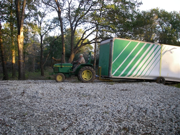

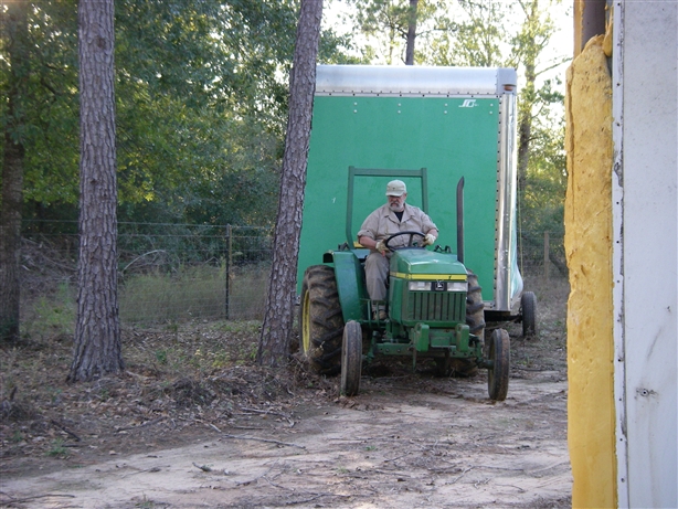

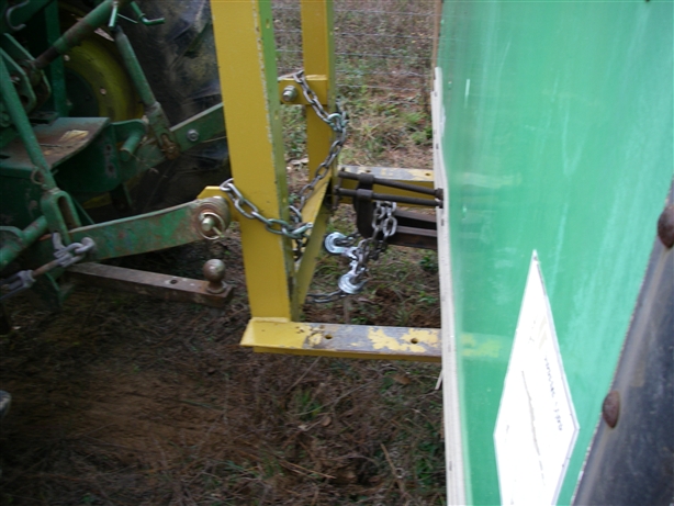

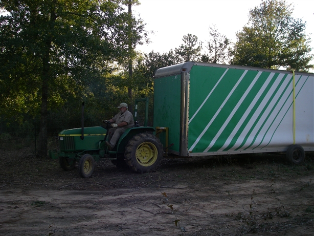

With the axle secured, the jack and cribbing were removed, and using my "carry-all" as a forklift, it was now no problem for the 870 to slide the forks under the heavy end and elevate it.
The "hitch" was made up of two C-clamps fixed to the front of the box, where a 3x3 steel rim-joist provided a secure pulling point....short chains wrapped around the lower crossbar held the load down on the forks then provided the pulling connection.
The system proved very maneuverable, and although "creeper" gear was not required to move the boxes, keeping the load low and the speed slow is the only safe way to move a peculiar load like this...so I chugged slowly on down the road with the first box and enjoyed the view....
It was no problem making some very tight turns, and only one spot, a 90 degree turn into the home-site required any backing....once I figured out the right point to start the turn, the remaining boxes went thru that choke-point without stopping....
The edge of the gravel pad proved a bit too steep for the 870 to pull the load up and over, but after a little grooming with a shovel, using a couple of short 2x12's for ramps and the lowest gear in the transmission, the tractor pulled the box up on the pad without even puffing.
Safely moving this first box was the "engineering on the fly" portion of the job...it took most of an entire day to approach the problems of each phase and then analyze, adapt and overcome the unique challenges presented...but at the end of Day 1, a system had emerged from all the uncertainty.
