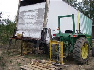

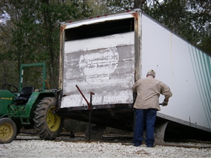

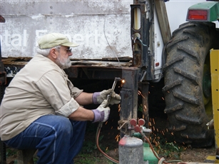

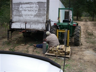

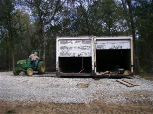

A good nights sleep....of course, whatever didn't hurt didn't work...coffee and a bowl of Ibuprofen, Garcon....
Day 2 began with jacking the #1 box down on some 20' long 2x6 treated "sleepers" (THANK YOU Precious Bride!).... then, with the tractor free, a short length of 4x4 was chained to the carry-all and the gravel on the edge of the pad was tapered....the tractor had no trouble with this gentler ramp, and box #2 made the journey without stopping.
Now it was a matter of rigging up, moving and setting the boxes next to each other... I pulled #2 up to the match the front of the previous load, set the front end down with the front corners touching and then used the tractor to stabilize the high end of the box while I jacked it down.
Now it was time to push the first two boxes together.
The sleepers were placed at 6 intervals along the length of the boxes spanning the distance between the foundation beams of adjacent boxes.
This provided:
  • A common plane of support for all the boxes
  • A smooth surface to slide the boxes on
  • A bearing surface for any leveling shims that might be needed
Leveling......Our "Zen Dirt Master" had provided such a fine grade on that gravel pad, that water poured on the floor of the first container pooled where it was poured without running in ANY direction....since the gravel pad was allowed to "weather compact" for several months prior to the work, I doubt even after settlement occurs, will any shimming be needed....
Just another case of a blind squirrel bumping into an acorn...
My initial attempts to pull the boxes into position with a chain were unsuccessful....the rear wheels of the light-weight 870 spun on the compacted gravel like they were on ball bearings floating in french-fry grease....but ample traction was obtained by using the carry-all as a fork lift to hoist the edge of the box just shy of lifting it off of the sleepers...
With the some weight from the box now transferred to the rear tires and using the incredibly low gear ranges available, this turned the previously ineffective 870 into a little powerhouse....and one bump at a time the containers were nudged together, and squared up to the pad.
A come-a-long was used to keep the open end of the boxes tightly together while the 870 was shoving the other end...it took me a few tries to figure that little trick out....I would nudge one end and the box would spin...and I burned up a little diesel going back and forth before the light went on....
But better late than never....No?

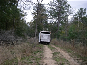

Each box presented slightly different challenges....#3 had a wrecked door that I will demo and salvage the hardware from to hold as spares for #1 and #2 (we got a 50% discount on that one!) and the remains of a lift-gate needed to be trimmed off prior to moving it.
But now that the system was proven up...in just a short while, off it went down the road to join the others....Do you love the mud-flaps?

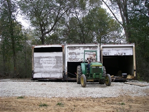

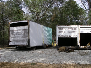

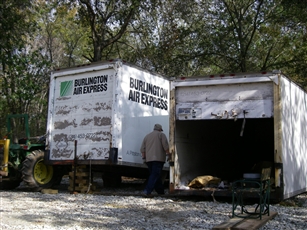

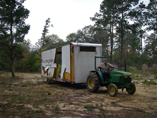

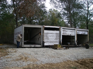

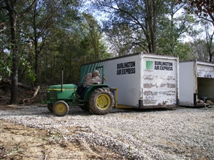

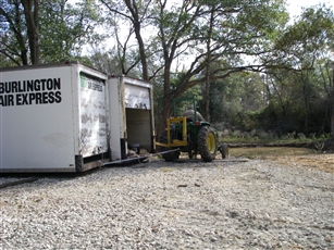

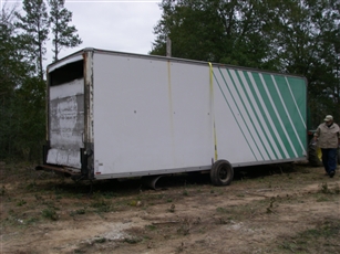

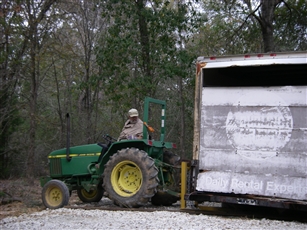

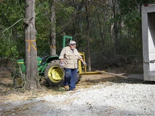

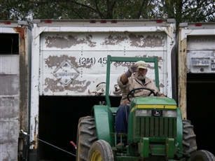

Box #3 was moved and set in a little under 3 hours...

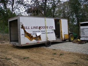

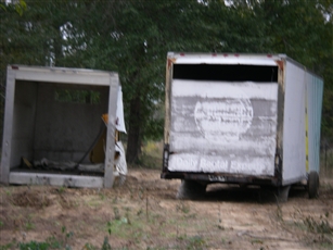

Box #4 (The "FREE" box!) was a fooler...tho 4 feet shorter than the rest of the boxes and made predominantly out of aluminum, it proved to be the heaviest of all....apparently there is a lot of steel hidden under the aluminum...
As you can see in the photo, the extra weight put a bit of a permanent bow in the mobile home axle but otherwise caused no significant problems.
The torn metal sticking out from the damaged side needed a bit of trimming to get the boxes to snug up tightly, but the soft aluminum was no problem. Inside, the plan is to line the wrecked wall with plywood panels screwed to the remaining metalwork, thus providing bearing surfaces for cabinets and covering the damage.
The cutout in front that formerly housed a chiller with now hold a small AC unit, and salvaged tin and spray foam will fix that wrecked corner....got "POP" rivets?
Site-built doors will close in #3 and #4.....the roll-ups are still in fine shape on #1 and #2....

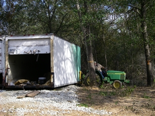

#4 was moved and set in two hours....and the free ends of the sleepers where then trimmed off....
SO - with the approval of the "Engineering Advisory" and "Safety, Health and Environmental Department" the first phase of the project was wrapped up, and the "Commissary Department "served a picnic lunch by the pond....
It was was perfect way to end a perfect day...hard work, no injuries and a good time had by all...
I would trade a ham sandwich by a farm-pond in Texas with family, for every snail in Paris.
With all that work done, and 9 weeks downstream, we are only now back at the point we SHOULD have reached, had the rain held off for a few days allowing that truckie to make it down our dirt road....BUT - such are the ways of construction...
I now have time to plan how to tie the boxes together, anchor them to the ground and make up a framing plan for the contianer doors and front porch...till the next installment; I bid you "Grazi Mille"....
And BE SAFE...
Terry
