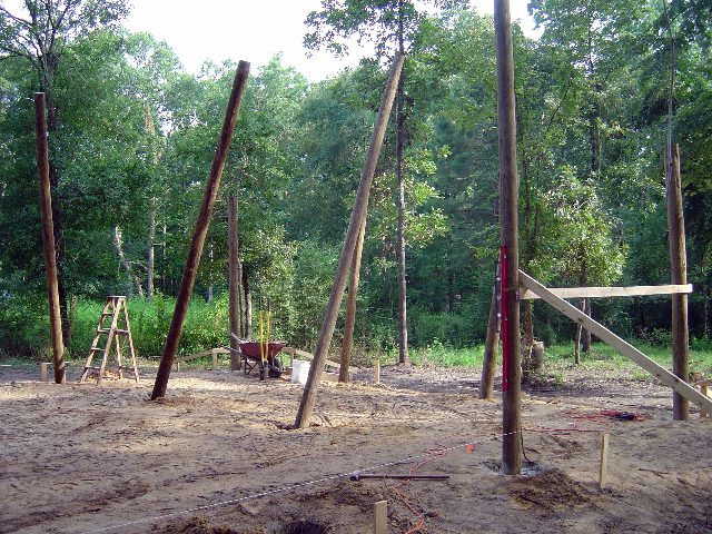

Brett,

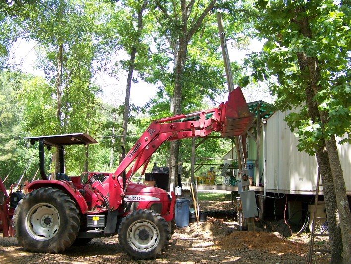

How many post holes do you need dug? Digging the hole and sitting the posts is the easy part. I squared and cemented about 12 of my 18 poles myself, with a cordless screw gun, 2x4s, and a 4 foot and a 2 foot level strapped onto the post. Glad to hear you are busy. Attached are two photos. One shows my barn poles in the holes and the other shows the Big RED Beast sitting my new meter pole.
hugs, Brandi Barn poles waiting concrete.JPG4-23-11 Installing new Meter Pole.jpg

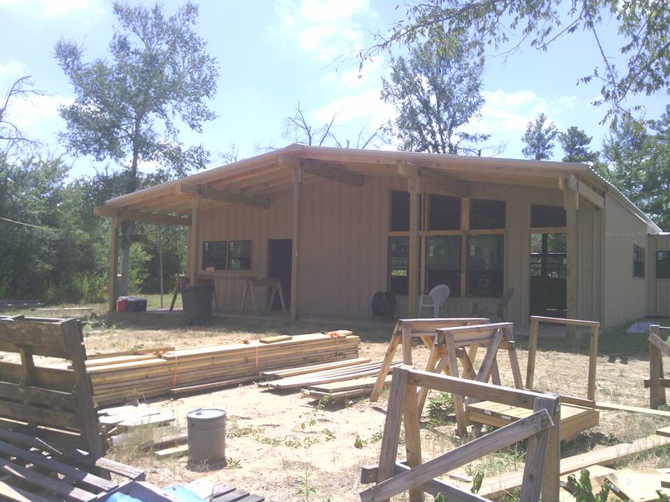

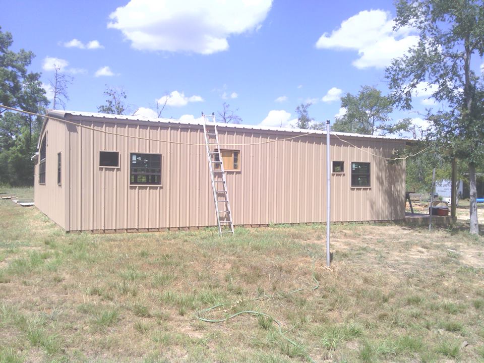

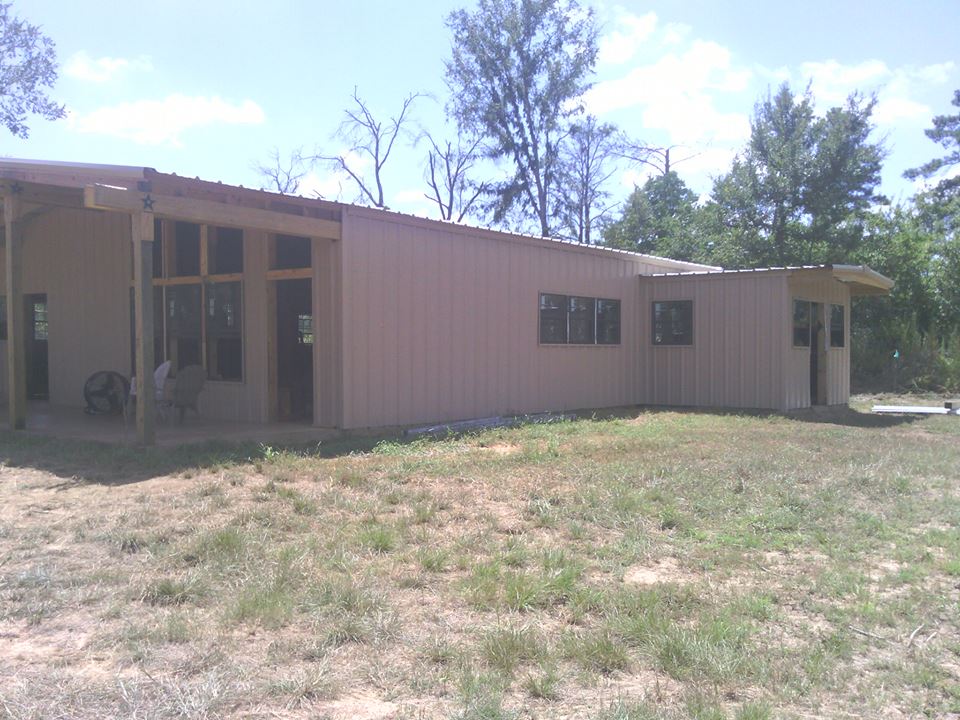

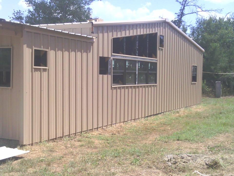

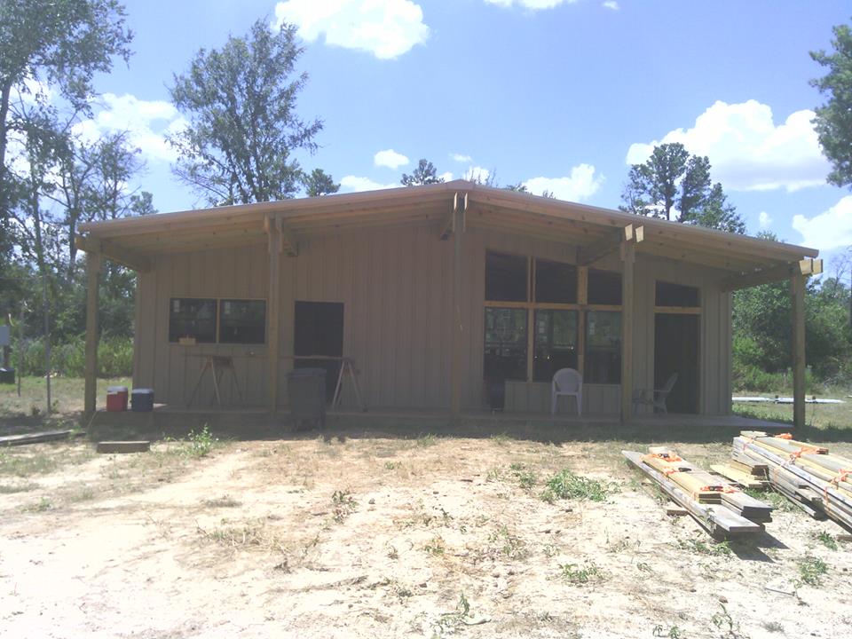

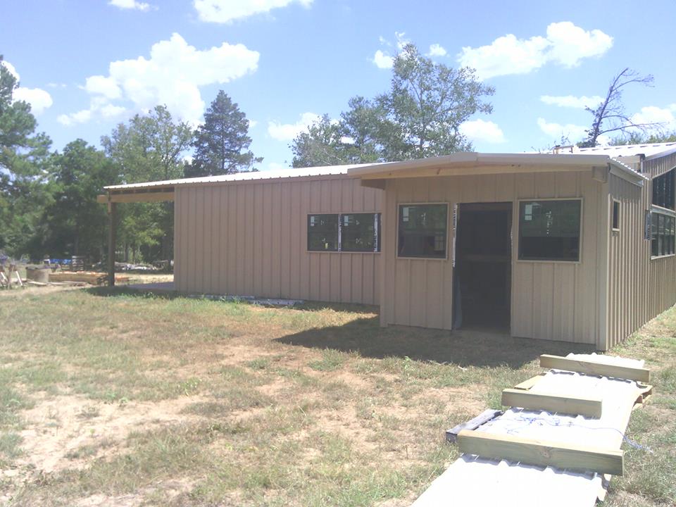

Aight...it's been a VERY productive month here on The Old Goat Ranch...and hot as a anvil, just the way I like it...
For those of you unused to a Central Texas Summer, get out a hair dryer, turn it to the highest setting, point it at your face and then empty the bag from your vacum cleaner into it...it is a weak substitute for the real thing, but you'll get the gist of it...
Working outside takes a little planning...
Starting at sunup is the only way to go...hourly breaks for water and finishing up the days activities by about 2:30 has been working out pretty well...by then the heat is climbing past the 100f mark, shade is at a premium and it allows plenty of time for the enjoyment of that most delightful of habits...SIESTA...as well as afternoon trips for supplies...
...I moved South because of my dislike of cold...so I try not to whine too much about High Summer....but when the thermometer in the shade under the barn roof hits 100f, I do lose a bit of enthusiasm...
Heat or no heat, my helper and I just kept a steady pace and got all of the sheet steel and trim up, ...leak tested the roof...fixed the leaks...(!)...and those few screws just needed to be torqued correctly....best of all, the darn thing is starting to look a lot like the plan......now all I need is a month at "work" to recuperate from my hobbies...
Enjoy the pics, I know I sure am...
And as always....BE CAREFUL OUT THERE...
T

   / An Old Goat Ranch in Texas #498
We're building a house,and was talked into "standing seam" type roof. Reasons were,screws will get loose and leak with expansion and contraction over the years due to temp changes,was about 50% more for material,but there are no exposed fasteners,so shouldn't have to worry about leaks. Tim
#499
Standing seam roofing is a wonderful choice! It is beautiful and durable....You will not regret the extra expense....but engineering-wise there is little worry in a properly installed exposed seam fastener roof using the latest crop of modern fasteners...
Modern "R" panel roofs and walls use a butyl seal tape between sheets and EDPM seals under the screws...and so long as the sheets are tight to the purlin, girt or other sub-strate, the fasteners are set square to the surface and properly torqued, as evidenced by a small amount of "squeeze-out" of the seal ring, the water seal is good for the life of the roof...I use both impact drivers and drills with adjustable clutches for driving the fasteners...the tool does not affect the final fitup as much as the experience of the operator....if you mess one up, just back it out and put a bit of "pooky" under the seal and set it back down...I keep a "toothpaste tube" size tube of silicone or scraps of butyl tape in my toolbag for that use...
When I first moved to Texas I built barns for a living...and even with less advanced sealant technology and hand-driven NAILS in both the roof and sidewalls, the company I worked for still gave a 25 year leak-free warrantee....the only service calls I ever made were to buildings that had been subjected to limb strikes, severe racking forces by tornadic winds...or had someone back equipment into a wall or door...
I wish we had these modern fasteners and sealants then!
Best of luck on your build!
Terry
