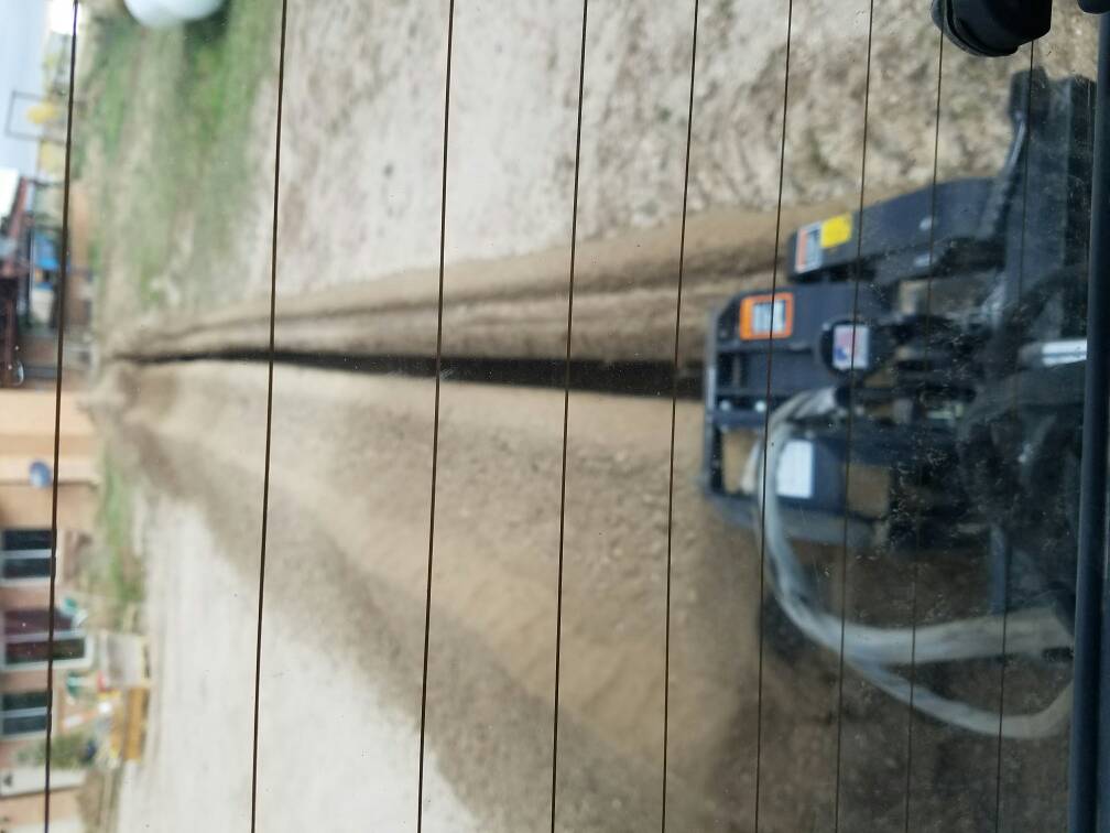

Here is a photo of me running my 3pt trencher. To pull that off you need to go a constant steady 1-2' per minute ( that 100' bit took me a bit under an hour). The only way you can pull that off with a tractor is with a HST. It gives you as much control as you want & is the ideal tranny for running a loader or precision work. I have no concerns about placing my pallet forks inches from the rear window on my truck to load/unload something. I'm sure somebody with a gear tranny could pull that off, but I have no desire to try.
Gear is more efficient, which is why they dont ofer HST on the big tractors. But most of us have utility tractors that do lots of random stuff, not just pulling impliments in circles in big fields for days on end. 20171013_101520.jpg
