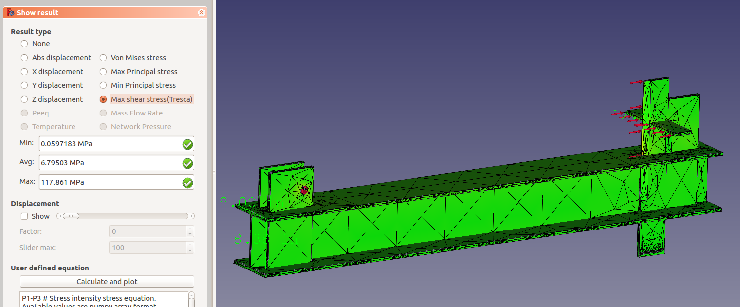

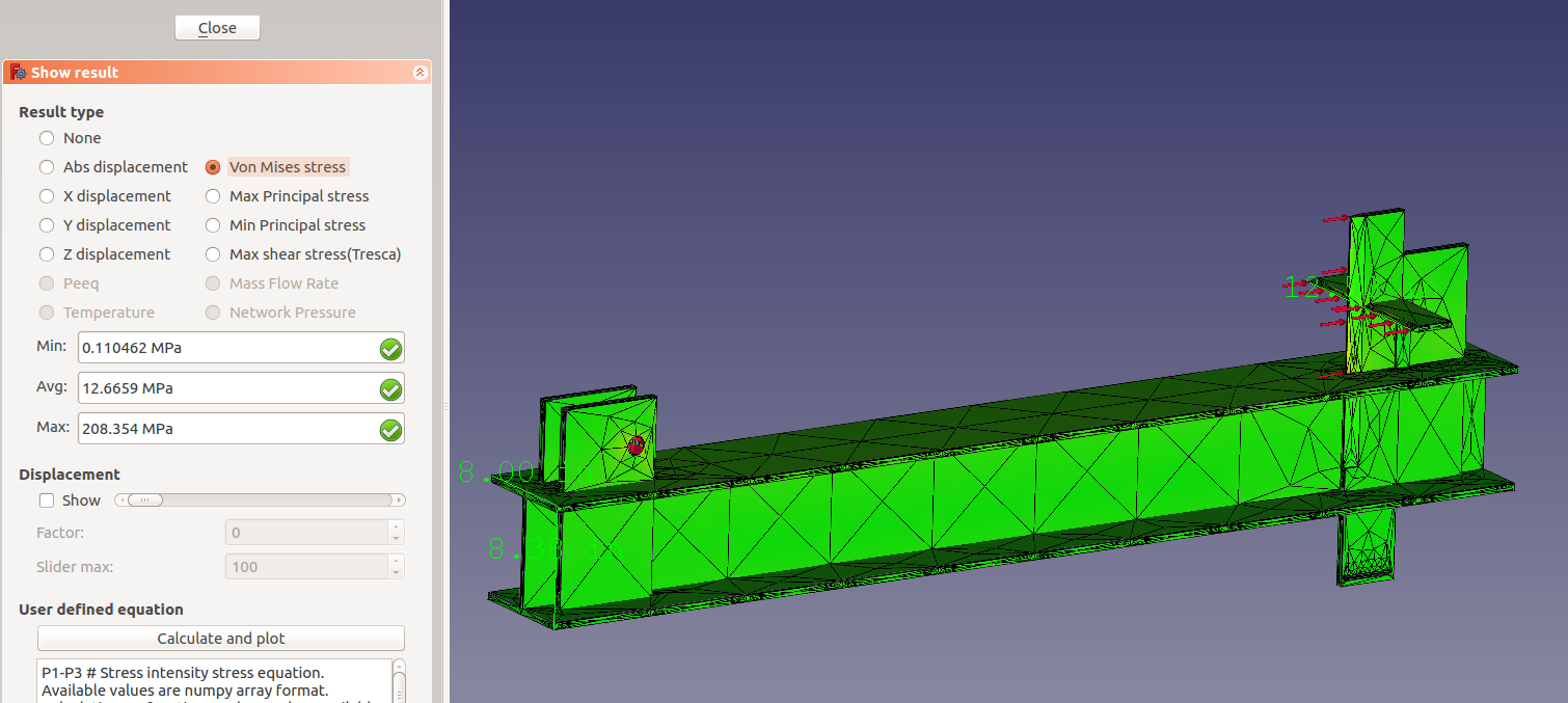

You are correct. I put the stress numbers on my first post though. Not able to confirm if was something wrong with the mesh creation, this is how it looks now. Be aware that I have not knowledge nor experience on using FEA. I just learn from google here and there.
So if you think that I am using it wrong plz let me know. This current analysis has changed: a) The flange width is 8" instead of 6.5" , and I created pockets so the cylinder mount "ears" and at the 4-way knife can go in and be welded to the full length of the web, plus at the opposite flange.
One pic shoes the Von Mises stress, the other the Tresca Stress. I have no idea what these mean though, if anyone can help me PLZ DO! Resources to read, or even a plain explanation, anything that helps me.
The Z displacement is 2mm, which I believe is elastic deformation. Applied force is 35000 Newton
Screenshot from 2018-03-03 10-01-26.pngScreenshot from 2018-03-03 10-01-14.png

I guess my point was you likely can't compare the two pictures absolutely because the color scale is relative to each, as you confirmed in your explanation. Thanks for that.
Matlab does the same thing by default, but you can set color scales manually, change to logrithmic, etc depending what you're trying to show or compare.

   / Analysis on log splitter built #18
Yeah, the previous problem was much more than behavior of the color scale -- something was definitely wrong based on the numbers you quoted. But when you are comparing multiple cases, be sure to set the color scale manually so that it's consistent. That way you can make reasonable conclusions about which design is better. This is especially important when dealing with stress concentrations.
