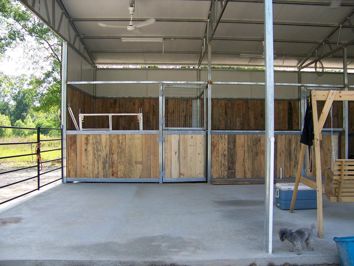

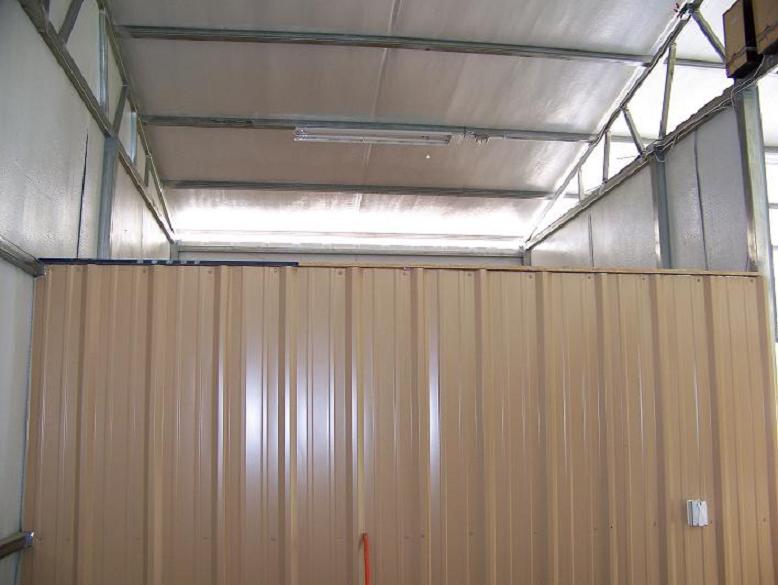

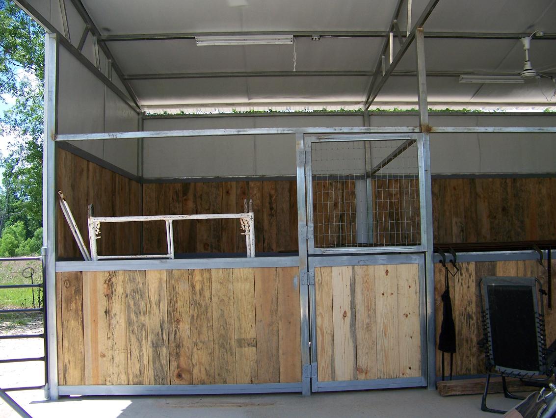

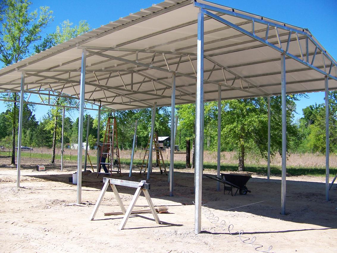

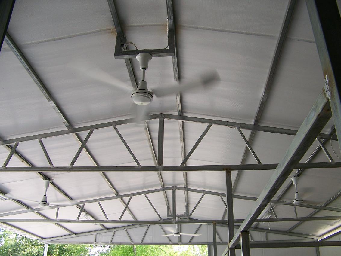

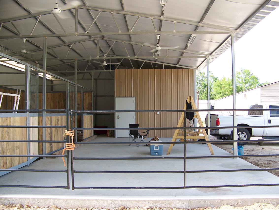

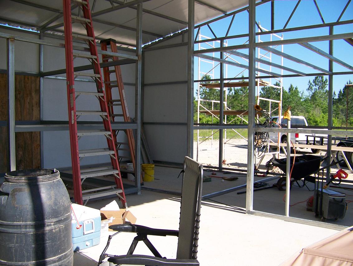

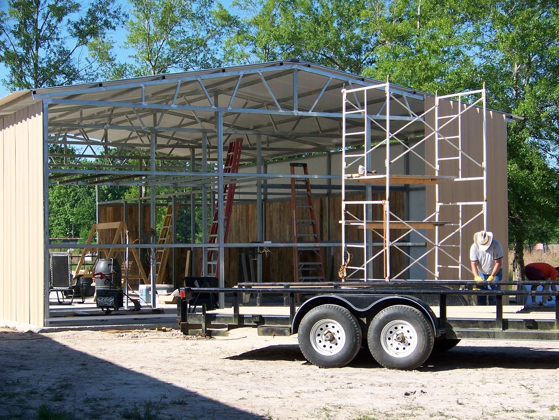

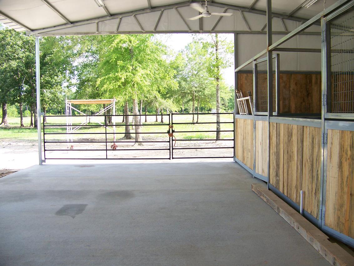

I know there are a lot of barn builds on here already. I did not want to hijack one of them with too many of my own pics. I have posted a few of them in some threads already. I figured I would start one myself. I looked at a lot of buildings to get ideas, on here and in person. I built this in my head for about 3 years before starting. I just wanted to post these for yall to see and maybe get an idea for yours. Feel free to ask any questions, I will try to answer them.:D
We built this back in the spring and still have a couple things to finish up. The structure is all galvanized tubing. I had a crew put up the outside poles, trusses, and the rest of the roof. The total dimensions are 30'x48'. I have 3 12'x12' stalls, a 12'x14' tack room with 8' ceiling, a loft on top of that, and 12'x16 area for hay storage, there is also a 18'x36' open area in front of the stalls. I had another crew finish the concrete. Everything else was done with the help of a few family members.

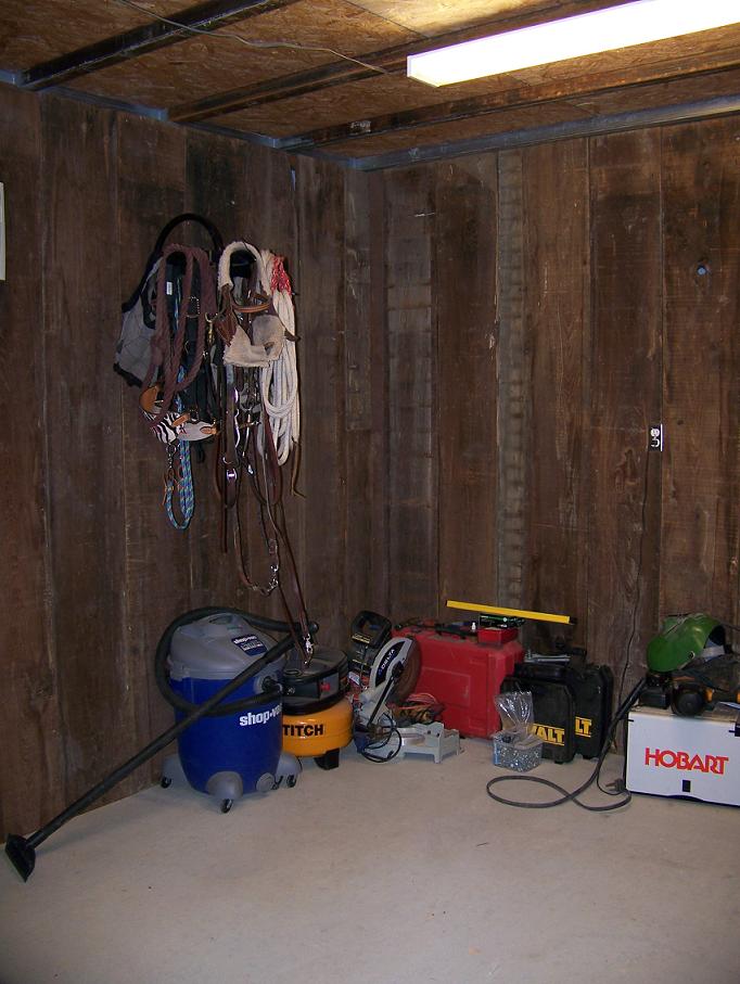

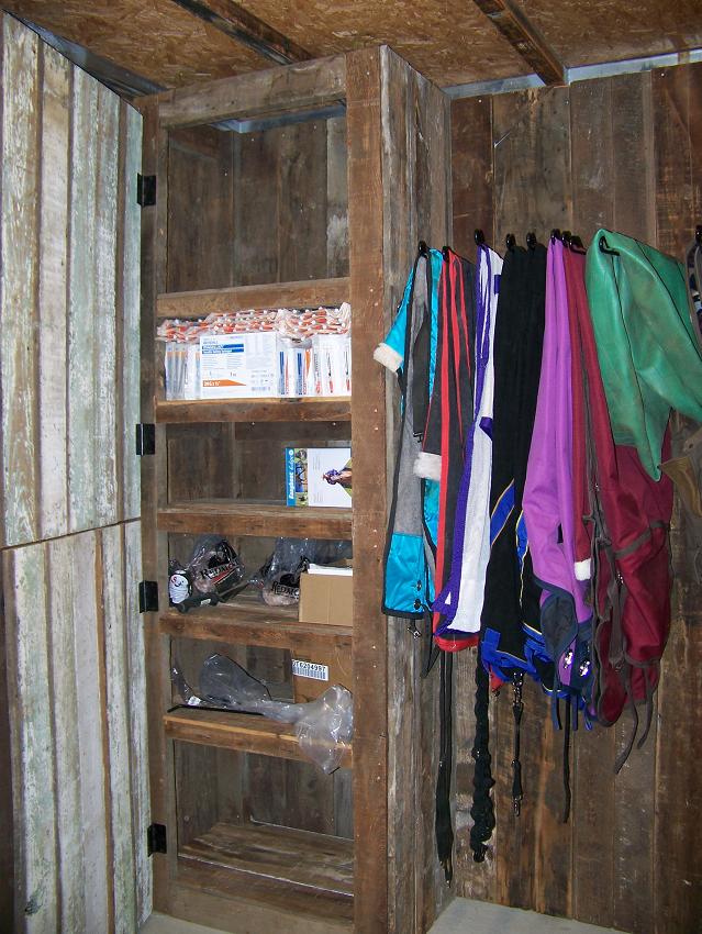

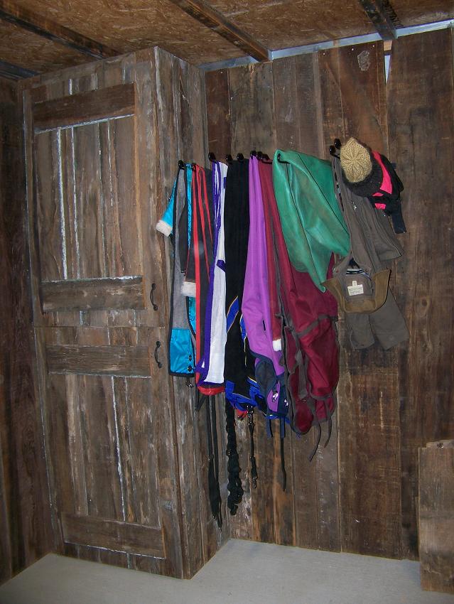

Here are a few inside the tack room as well. The ceiling is still not finished in there. We are going to tear down an old barn soon, and I will use some of the "weathered" tin from it for the ceiling.:thumbsup:

I really love the front of your stalls. These look purchased like a kit. Or did you make these?
/ And another born
Boy I really messed all this up. I was trying to see if I could change the title of the thread, but made a new one instead.:confused2: I may get fussed at. At least the new one has the correct tilte.
Anyway the stall fronts were built by a great fab outfit close by named me. The tubing is 2 1/4" with a piece of 2' flat bar welded on front and back. The lumber is 2x8 rough cut pine. I have finished them with 2'x4' galv. wire panel. I do not have any pics of them completed. I need to take some more.
