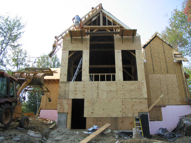

I have a cheaper aluminum ladder I bought off craig's list that has a hook mounted to it to hook onto the ridge. I put wheels on the ends of the hooks so you just roll the ladder up to the ridge and over. I also mounted 2x4 blocking every couple of feet so it holds the rungs a few inches off of the roof. I also have an old Airforce aircraft mechanic's lift. The hydraulic ram and pump were junk so I've got it fixed at it's maximum height and the loader on my backhoe with forks to pick it up. Between the loader and the lift it'll reach about 14' in the air. The great thing about the backhoe is that if the ground isn't level I can use the stabilizers to level the platform. It's real nice having a 2' by 8' platform to work off of. Since it has railings and kick plate I can put a ladder on the platform.

Standing on the ladder leaning against the chimney, or standing on the roof alone don't provide a stable enough platform. That ladder with the bottom supported by the bucket, and resting on the asphalt-grit shingles, isn't going to slide anywhere, or get kicked out from under me. Drive around New England and you'll see a lot of old places with wood burning fireplaces with wooden ladders actually attached to the roof going up to the chimney. They'd use a ladder to get on the roof, and then the roof ladder in the exact same way my temporary arrangement works.

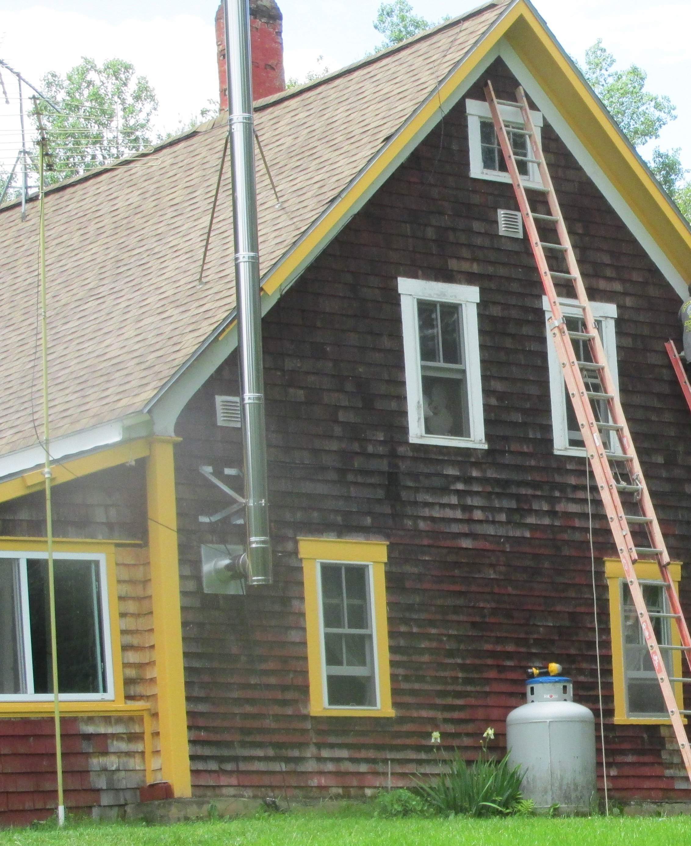

Oaktree, can you please post a picture of your chimney? Would like to see your set up. Thanks...
Here you go. Not a great picture, but you get the general idea.
I'm usually a big DIY'er, but I considered the $500 I paid for installation when I bought the stove to be money well spent. No way could I have handled that by myself. My house is plank construction, they went thru 3 batteries in their Sawzall to cut the hole in the wall for the thimble...4" thick solid walls, not sure what kind of wood it is...not as hard as maple, etc. but not a softwood either.

Dont you get very dirty cleaning it from the bottom? I've had this type of set up before, but I still cleaned from the top with a bucket underneath to catch all the junk.

Ok. I have to ask. How did you reach the top? Bucket truck?
Reason why I asked is I'm adding a wood burner to an out building this winter and my chimney will look very similar. Just not as tall. Only 21-24 feet.

Mine was inside the house, but with the "T" in the rear of the fireplace with the removable cap on the bottom, which is what I as referring to, not the same placement. I could reach it while standing on the roof. Free standing tall like that in his picture would present a problem.

My stove burns fairly clean, and I never burn green/wet/soft wood so I don't get a lot of creosote to begin with, but yeah you get a little dirty, mostly just hands and forearms. I'll just put a tarp on the ground under it to catch what comes out.
I have enough rod extensions for my cleanout brush so I can get all the way to the top. I suppose if I ever had to get at the top (say to replace the cap) I could disconnect one section and pivot the whole shebang on the roof brackets, though certainly not something I'd want to tackle myself.
When the stove shop installed it, they assembled it on the ground and hoisted it up, just 2 (very rugged) guys.
I did one time get the brush stuck and while twisting it to get it out unscrewed the coupling between 2 sections of rod. Had a helluva time getting the brush back out...ended up making a hook and using several sections of PVC pipe to push it up and hook onto the brush. After that incident always tied a rope to the brush!!
