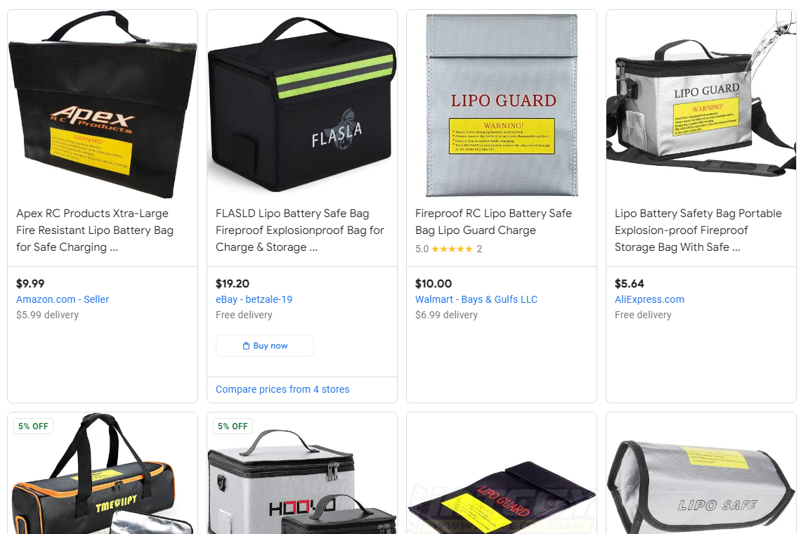

In the RC world they have things like this to store and charge the batteries in, these bags are to contain the fire.

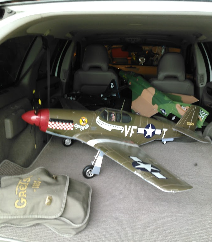

And how often here am I going to get a chance to post some pics of my planes, you can see the little Panther in the back of the pic. The Phantom will clock in at just over 90mph in level flight, and well over 100mph in a shallow dive. Checked on real cop radar gun.
