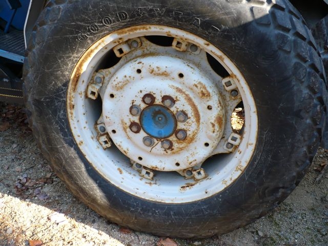

Here is a photo of my stock 28" (a bit rusty and not even calcium filled) rears. Probably the most common on the 2120 (I think), although I have seen quite a few with the sizes that smac has...

   / Another 2120 Turf to Ag switch #13
Joe, I see, you have the disc just need the rim with clips.
I plan on getting a quote next week. The last hurdle is how to cut the centers from the Kubota R4 fronts in a concentric manner. Looked at laser and plasma but I think a rotary table and 3/16 end mill will be the way.
