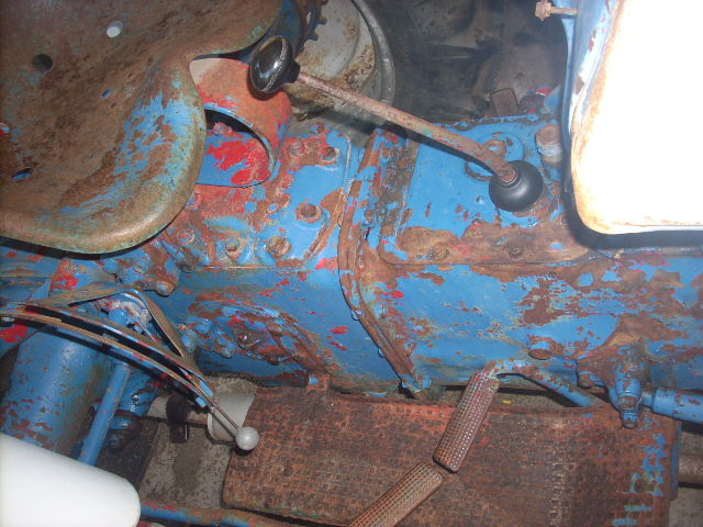

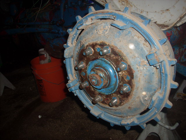

I finally got a break from the rain and mud enough to load up the 8n and get it on the carport to start my clean up, paint, repair, rewire and add a new worklight on the back.
I found...
1. the entire left side front and back lug nuts were cross threaded.:mad:
2. one nut on each fender was cross threaded.:mad:
3. the seat was not bolted down like I thought. Just rusted. No problem.
4. no rear axle nut retaining clip thingy on the left side.
5. the box leveler is rusted tight.
8. there was a gear on the left brake drum. I guess it'll go in the pile with te other ones.
tomorrow I'll drain the tank and remove the hood and get started on cleaning and priming.
Here's some pictures of the general surface condition.

if you have cross threaded lug studs on the rear.. I'd save priming till I had them fixed.. it's not a simple knock out and replace.. it's a disassemble, knockout, reassemble.. etc..

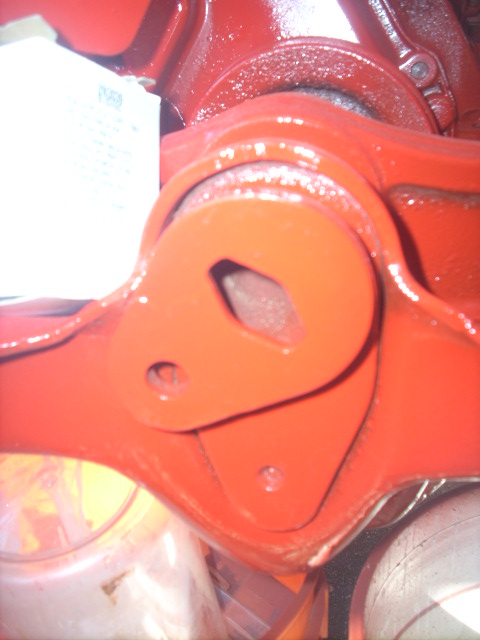

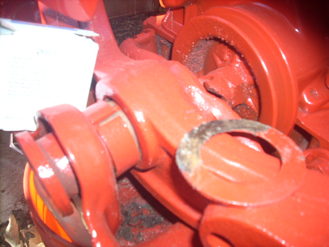

I need some advice on this one.
After I slapped paint on everything I started looking at the axle pin and saw the thing had been hanging half way out for who know how long. I bought a new bushing but I'm not sure where the washer that was sitting down below the axle pin goes nor do I quite understand how the pin stays in once I replace it.
The washer is embossed on one side to lineup with the end of the bushing but what holds the pin in place?
