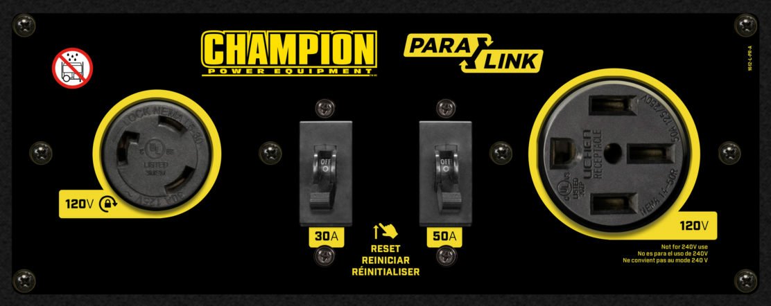

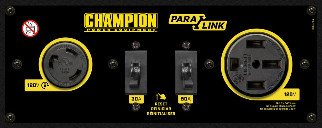

It sounds like you are saying I am expecting to get 240 volts from the two 120 volt legs of the parallel switch/kit. I AM NOT. I am only expecting to get two 120 volt legs from the parallel receptacle for a total of 50 amps service. That's what Champion says the #100319 output is.
/ ANOTHER ELECTRICAL QUESTION #62
You better look again! The parallel kit only supplies 1 leg of 120! It might be a 50 240 plug but only one leg is powered! I've been around generators and wiring quite a lot since I also deal with coastal storm and multiple day outages. The picture from Champion shows only 120 on a 240 plug!
Might not catch spell check but seem to know what I'm talking about since also sold Honda generators that offered parallel kits long before Champion ever was in business and it just double amperage not 2 120 legs at 50 amps! 100319-panel-1112x0-c-default.jpeg
/ ANOTHER ELECTRICAL QUESTION #63
Also, if it were 2 legs of 120, why is there only 1 circut breaker for 50 amps? You can't have 2 legs protected by a single 50 amp breaker, it would be 2 25 amp breakers. One for each leg. You need to heed your own advise and study before saying others need to. You should ask the question and take the advice, good and bad! Many post have spelling errors that should be looked past for content!
Might not catch spell check but seem to know what I'm talking about since also sold Honda generators that offered parallel kits long before Champion ever was in business and it just double amperage not 2 120 legs at 50 amps!View attachment 666333
I really do believe you know what you're talking about but please explain the 50 amp receptacle in the parallel kit picture you posted. Looking at the receptacle as pictured: The semi-rounded slot on the left is ground? The slot on the right is neutral? Both the top and bottom slots are 120 volts? I realize they are both on the same circuit but do not both of them provide 120 volts? Please explain. I'm listening.
