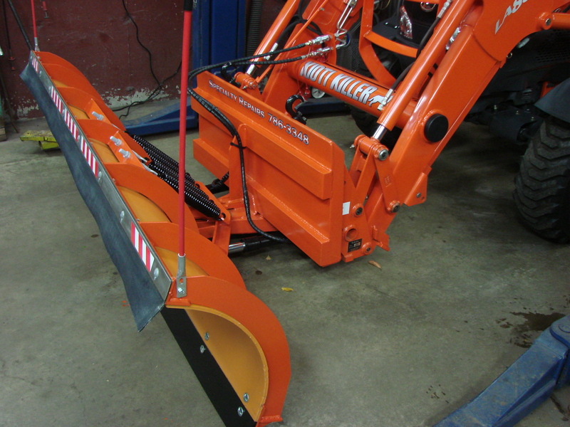

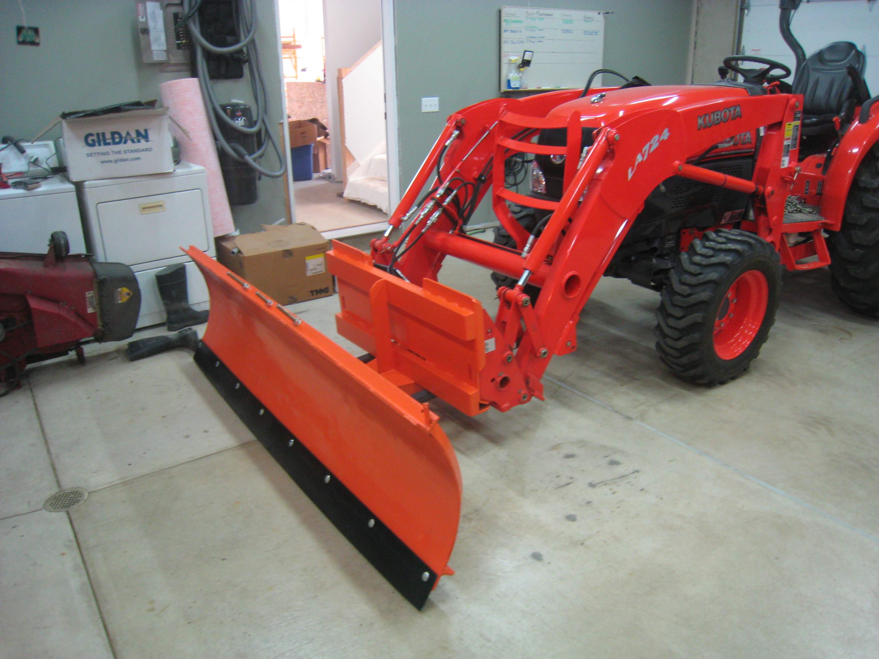

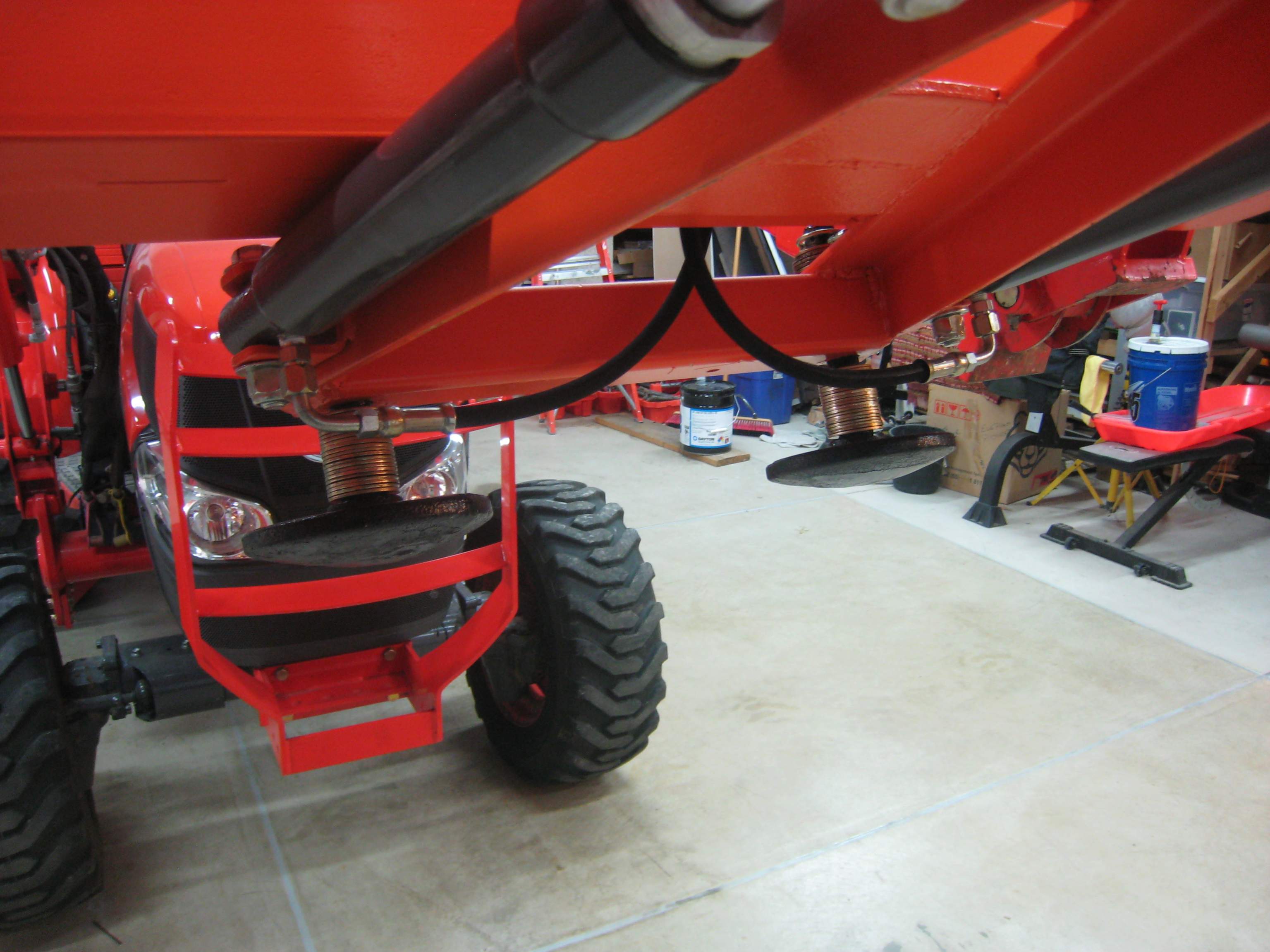

Well, here it is! I am pretty happy with how it turned out with the exception of 2 things.
1. The "Kubota Orange" paint that was used does not match my tractor. I can't completely blame the guy who sandblasted and painted it because I am pretty sure he thought he was using the correct "Kubota Orange", which I think was the old orange. The newer orange has a lot more red in it.
2. The hydraulic hoses are currently positioned underneath the A-Frame which means they could easily get snagged on something if I am not really careful. I tried putting them on the top, but it was too tight with the cross tube on the FEL arm. I am thinking through the use of some 90 degree fittings or maybe having new holes drilled through the cylinder ends to rotate them 90 degrees which will put the openings on the sides instead of the top or bottom.
Here are the before and after pictures.

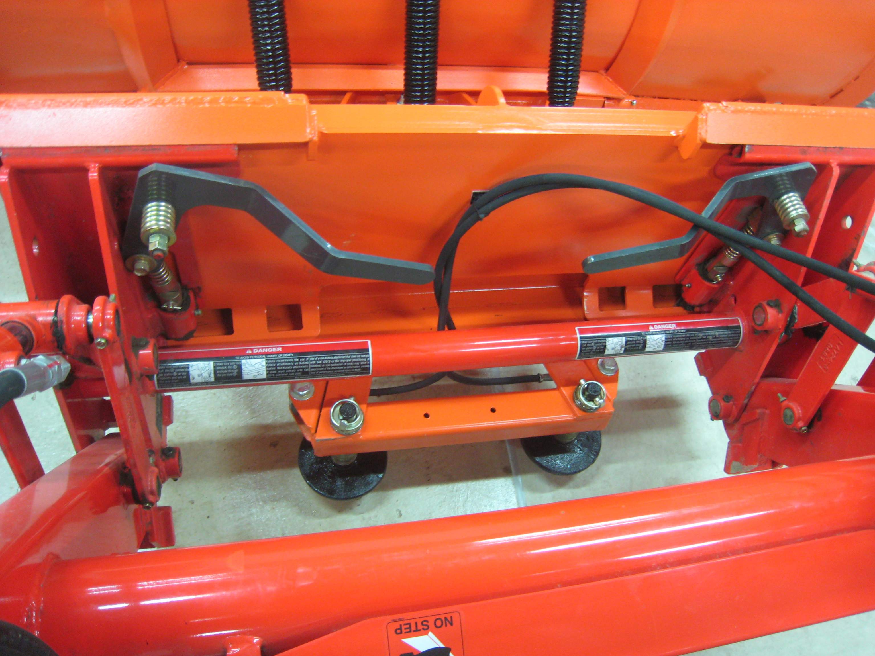

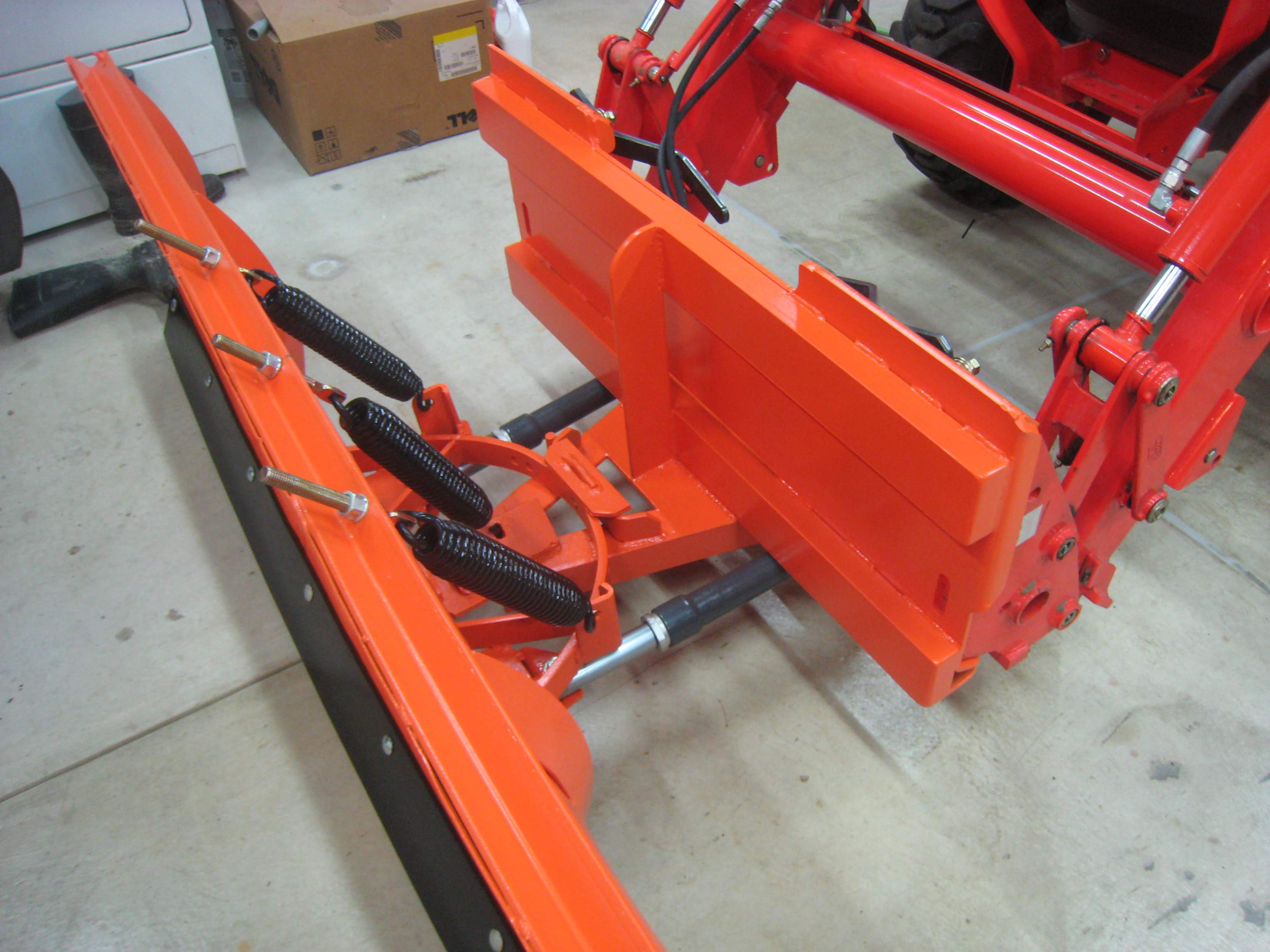

Here are some additional pictures from some different angles.
Notice the hydraulic lines under the A-Frame. They are somewhat protected by the skid shoes, but they still make me nervous.

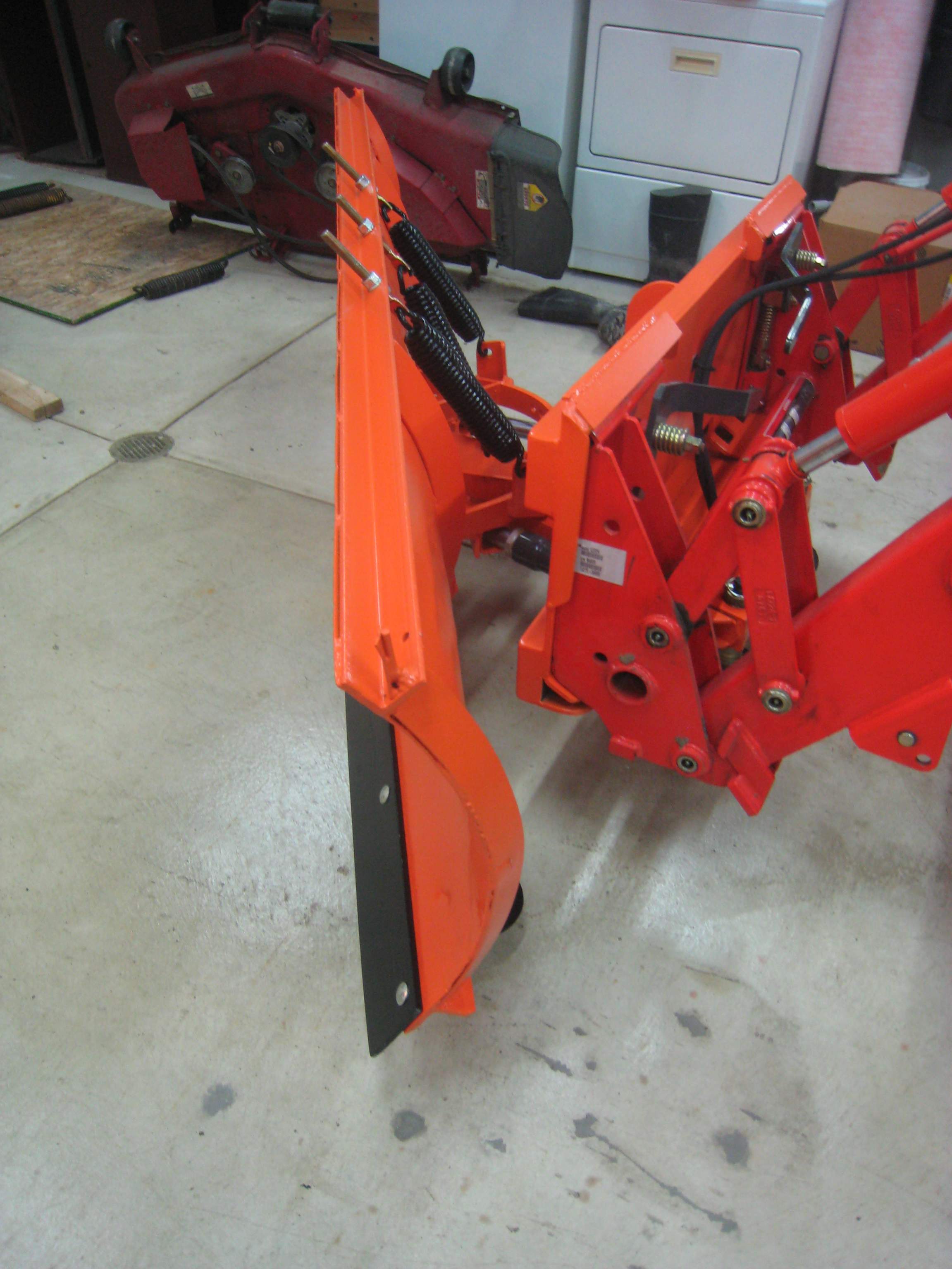

The hydraulics worked perfectly! I was a little worried about getting the hoses on the correct ports to ensure left toggle = left angle and right toggle = right angle. Guess I had a 50/50 chance and I was right on the first try!
Still have plenty of clearance even when angled all the way to the left or right - see pics below.

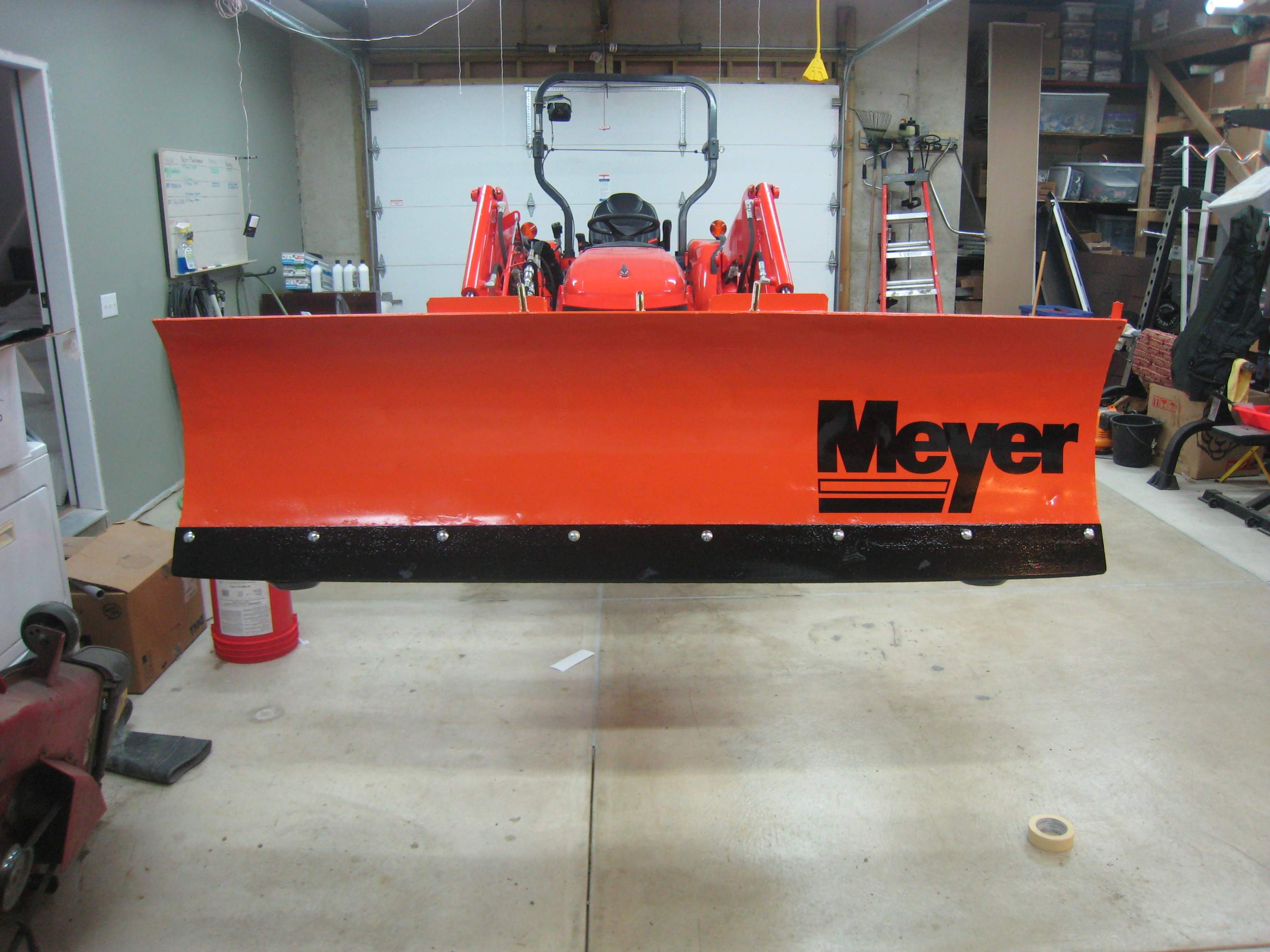

The mailman delivered my decal kit today - just had to get them on and shoot a few more pics! I think it really makes it look like a final product!

Wow great job Thomas! Get yourself a couple of blade guides and get those lines on top of the cylinders and you got it made. You might be able just to remove the rear bolt on the cylinders and rotate it 180 degrees and the lines will be on top.

Get them hoses up off the ground. when plowing you NEVER know what you are going to hit......... hanging down like that they are BEGGING to get snagged on something.
I was just about to post the same thing. No reason you shouldn't be able to rotate the cylinder 180deg after you remove the rear pivot bolt. There is no way something as simple as this uses a keyed cylinder. For some odd reason that doesn't work, you can flip the whole cyl unit, or swap them one side for the other, but they should spin just fine.
