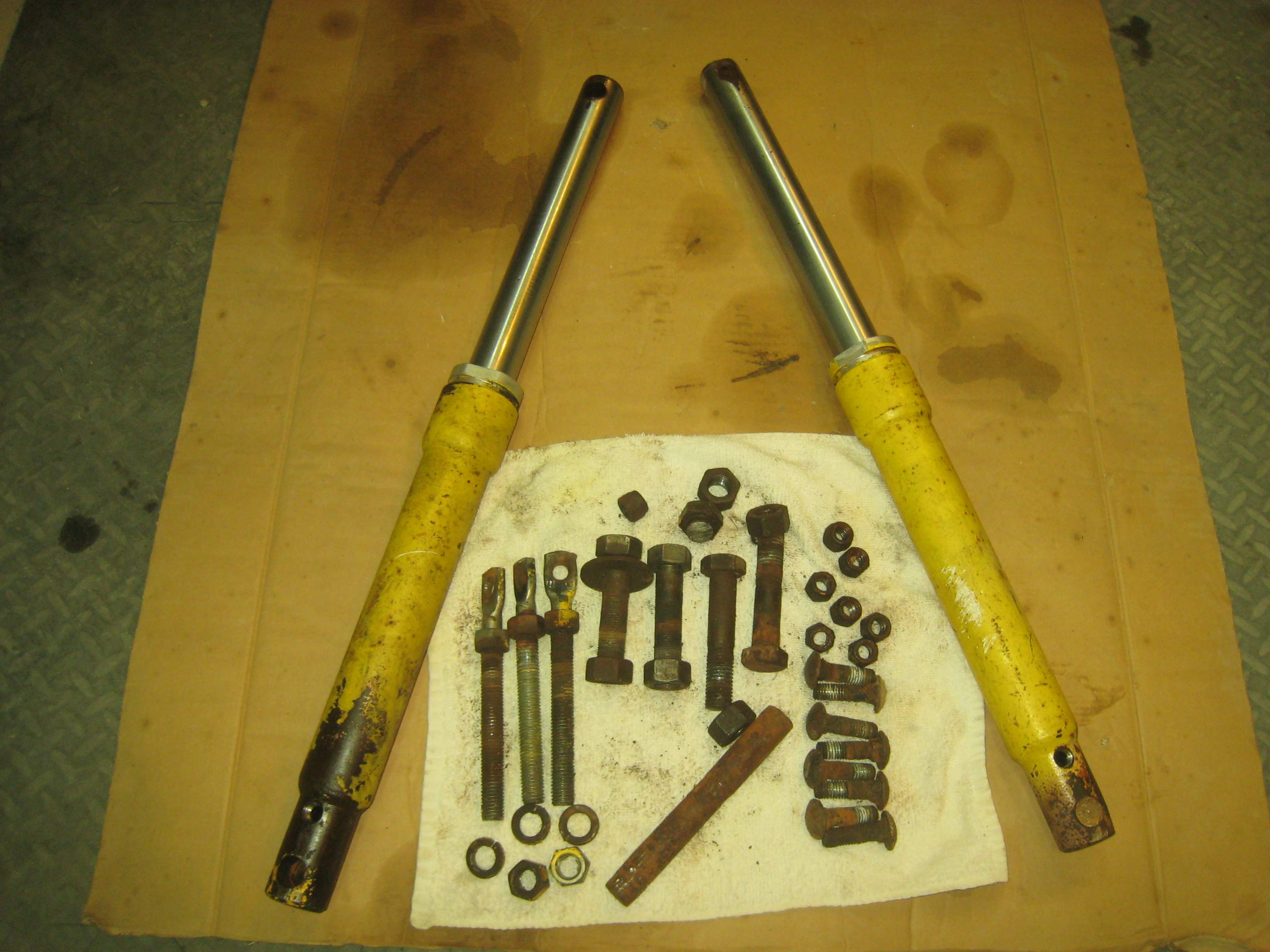

As I am waiting for the new pivot sleeves to arrive, I decided to cleanup the old cylinders and give them a new paint job!:confused2:
I sanded them down to bare metal and then applied a rust converter for the areas that were pitted. A couple of coats of primer, some sanding and then a couple of coats of Kubota ROPS Gray paint from a rattle can. I figured if I am going to keep them, I might as well get them looking decent.
The rest of the unit (moldboard, A-Frame and Sector) will be done in Kubota Orange. The goal is to make it look as close as possible that it came right from the Kubota factory!!:thumbsup: We'll see how close I come in the end!:cool:
Pictures show the contrast between before and after.

Look'en good Thomas. Very nice indeed :thumbsup:

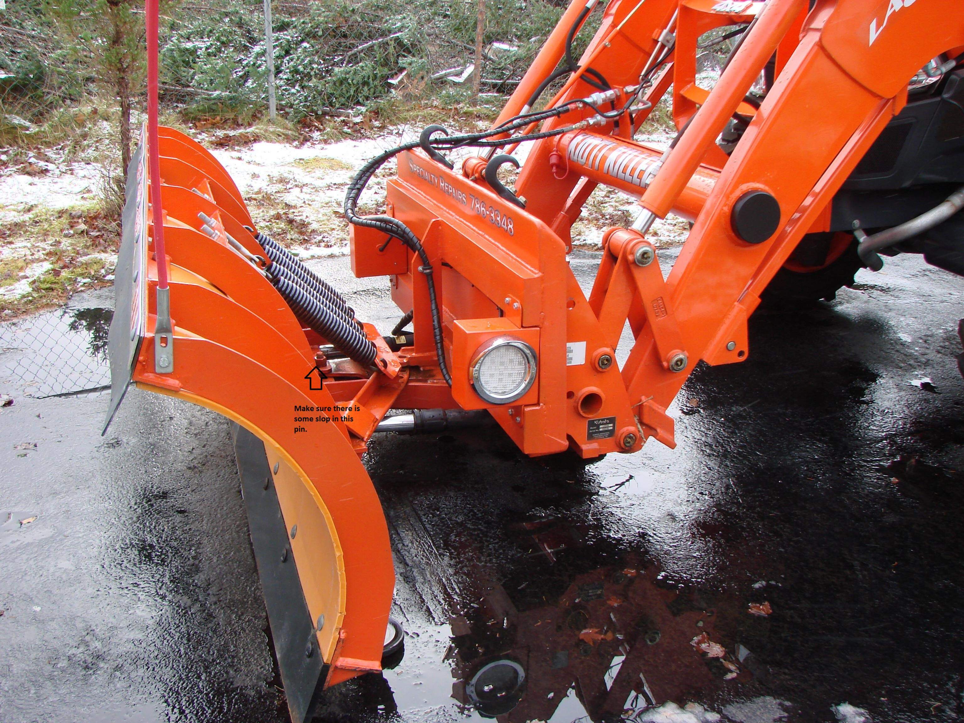

4shorts - I'm also looking into a DIY loader blade application. I enjoyed your fabrication pictures, especially your approach to reducing the overall depth of the assembly off of the loader plate.
Thank you. I'll try and answer your questions below:
1) What is the dimension from the loader plate to cutting edge of the bucket?
22 inches
2) Did this start life as a 7'6" Western blade and frame?
Nope. It started life back in 1993 as a 7'6" Arctic poly snow plow. I purchased it new and used it on my pick up until I adapted it to the kubota.
3) How rigid is this setup, does it allow for much blade oscillation for uneven paved surfaces? My application is for a paved farm lane with rolling diagonal dips to shed stormwater.
I've plowed with it commercially for two winter seasons now and it's never had an issue. Yes It's rigid, If it wasn't I would have changed the design. As for the oscillation for uneven paved surfaces. You asked a very good question and a very important one at that.
When I did this fabrication I took that into consideration and how I got around that was to actually make the center pivot point looser than normal to allow for an uneven surface. If you don't do that there will be times the blade will one cleaning have the blade due to the uneven surface. With my blade raised off the ground there is about a three inch bit of play when you grab on to the blade on one side and that's the secret to having the blade stay level on the ground even if the ground is uneven. If the center pin is to tight you will not be happy with the cleaning results of the blade. See attached photo.
i see some OEM plows for tractors and skidsteer applications design this freedom of movement into their product to account for the lack of suspension on the vehicle. Any thoughts on your setup?
Answered above.
4) Having the cylinders so close to the ground is one drawback to the short overall depth design. The extra skid shoes are a great idea. Any thoughts to a skid plate under the cylinders for further protection?
There would be nothing wrong with putting the skids under the cylinders. I chose to put them on my in the location that I did so the rear of the "A"frame would dig in to the ground if I weren't paying attention. I've never had an issue with them being close to the ground. The blade will clean the path first so if there's any obstacle in the way the cutting edge will hit it first. If I thought a skid pan would have been beneficial I would have installed one but I've never had a reason to need it.A skid pan could cause more trouble if it was there in my opinion. It could cause snow or ice to build up on the pan and possible jam the system. The way I have it now allows the cylinders to clean themselves each time I lift the FEL.
5) No provisions for a crossover relief valve?
Nope. In 20 years plowing I've never bent a cylinder and two years this has been on the tractor I've never had an issue.
6) Not that you will ever need to but ....what you do differently if you had to make another?
I would do a carbon copy of this system. I wouldn't change a thing. In my mind and considering my needs I feel I've hit a home run. It's efficient, reliable and compact. As a matter of fact most people that see it thinks It came with the machine. In the last two years I've got no less than 9 calls from all over Canada and the US asking me about it. Just the other day I received an email from a guy in the US who had just completed a build that I helped him with and he's design was very close to mine. That's what he wanted and he did a nice job I might add. Thanks for your post. Really good questions :thumbsup:

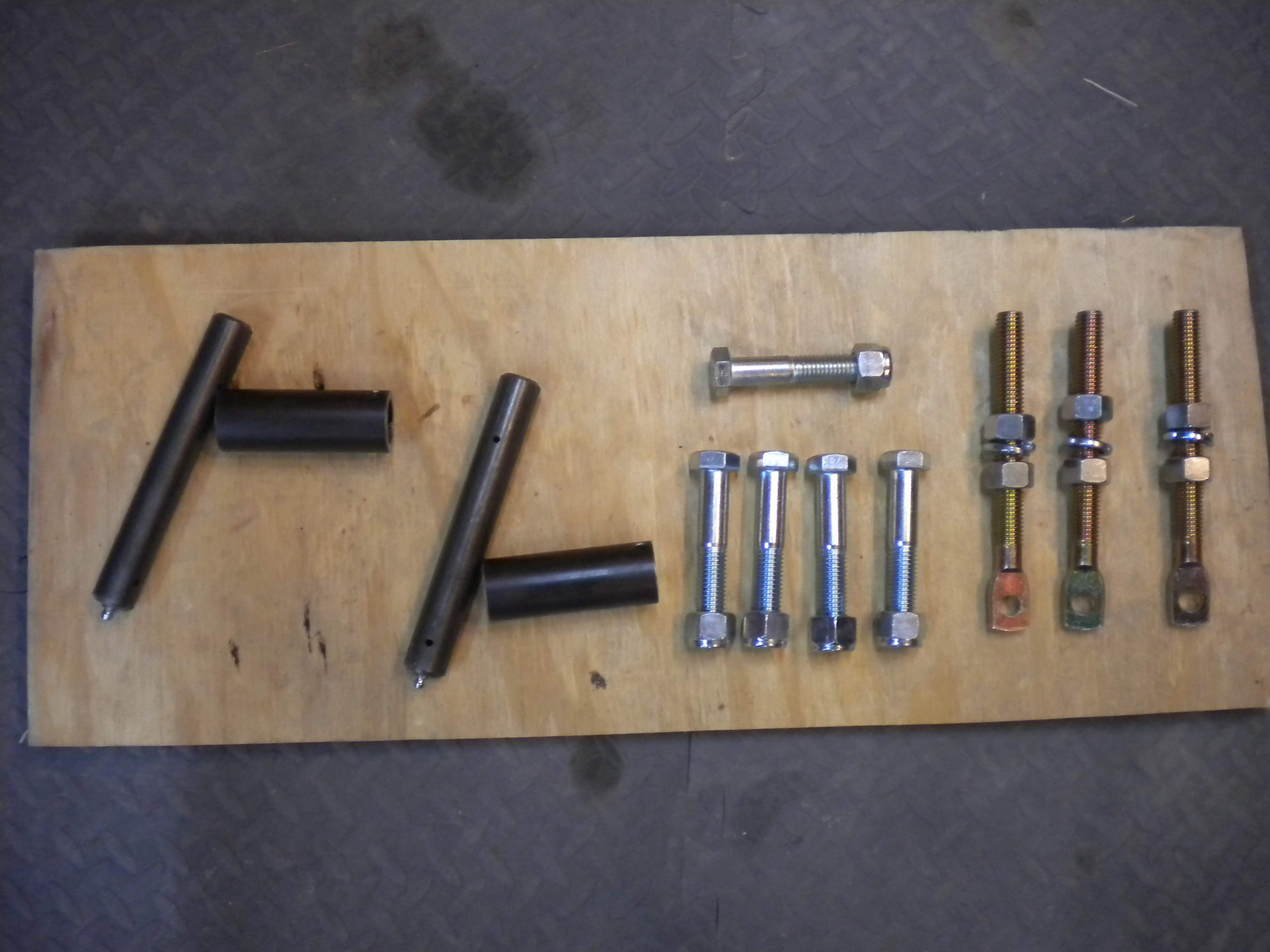

As expected, I received my new hardware package today.:)
I ordered:
angle cylinder hardware (qty = 4)
king pin (qty = 1) - 4SHORTS, thanks for the tip on keep it a little loose!
pivot sleeves (qty = 2)
pivot pins with grease fittings (qty = 2)
trip spring t-bolts (qty = 3)
Tomorrow morning I will take the pivot sleeves to my friends shop to get them welded in place. Then off to the sand blaster!:D

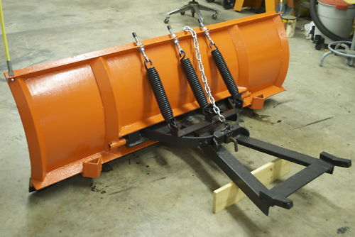

Today a shinny L3940 was finally delivered ......before our first snowfall! Thanks Neil.
I also pulled the trigger on an Ebay plow that should make a easier starting point than some of the other DIYers have had here. It's a manual angled Myers in great refurbished condition. I decided to go with a 6' width for storage constraint issues and will try to customize a pair or retractable/removable wings at some point in the future.
1) 4shorts
a) From a structure standpoint what is the cross section of the rectangular horizontal beams welded across your loader plate? Are the structural channel or formed sheet stock?
b) My final plow dimensions should be very close to yours and the 3rd function ports on the my LA724 loader are in the same location as yours. What was your final hose length, coupler type and size?
2) Can anyone direct me in the dimension details converting a Myers to a hydraulic angle?
a) Per other posters I'm looking at the Baileynet.com cylinder deals and assuming 10" stroke with 5/8" or 3/4" mounting pins....or can I get away with the throw of an 8" cylinder? Does size of the hardware matter.....perhaps for shear protection?
b) Before I start fabing brackets - Does anyone know a source for cylinder attachment brackets that can be welded on to convert my manual angle frame to a hydraulic angle?
c) Locating dimensions for the cylinder attachment brackets.
d) Source for skid shoes?
Thanks again

As far as skid shoes go, I have been looking for an extra pair as well. I will use 1 pair on the blade and then add a 2nd pair under the A-frame. The best source I have found is my local Tractor Supply. The round ones are $20, the shoe shaped ones are $30. I am planning on using the round ones - less to get hung up on!
Good luck with the snow plow mods!
