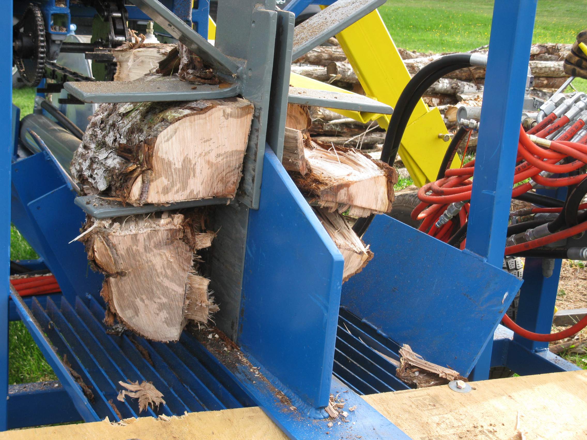

The one thing you're not taking into account is most wood will pop long before being split the full 16". I've had charlie horses and had to turn to protect the jewels (hence the charlie horses) from rounds exploding from off my splitter. So, you'll get a lot of deflection in the first couple inches of the cut, but soon the wood will open up, even if it doesn't fully split. That will lessen the amount of spread by the time you've split the round. Some wood, like hard maple, will do this much more than something like elm, but even elm will open up a little. A lot of the wood I split, I only have to move the splitter cylinder 6" - 8" to fully split rounds.
That makes sense. I have zero experience on a splitter while paying attention to HOW the wood moves rather than just keeping hands out of the way and deciding if a re-split is required.
I think if you dropped the wood tray down 3" behind the processor, you'd eliminate the lift on the 4 way.
I agree.

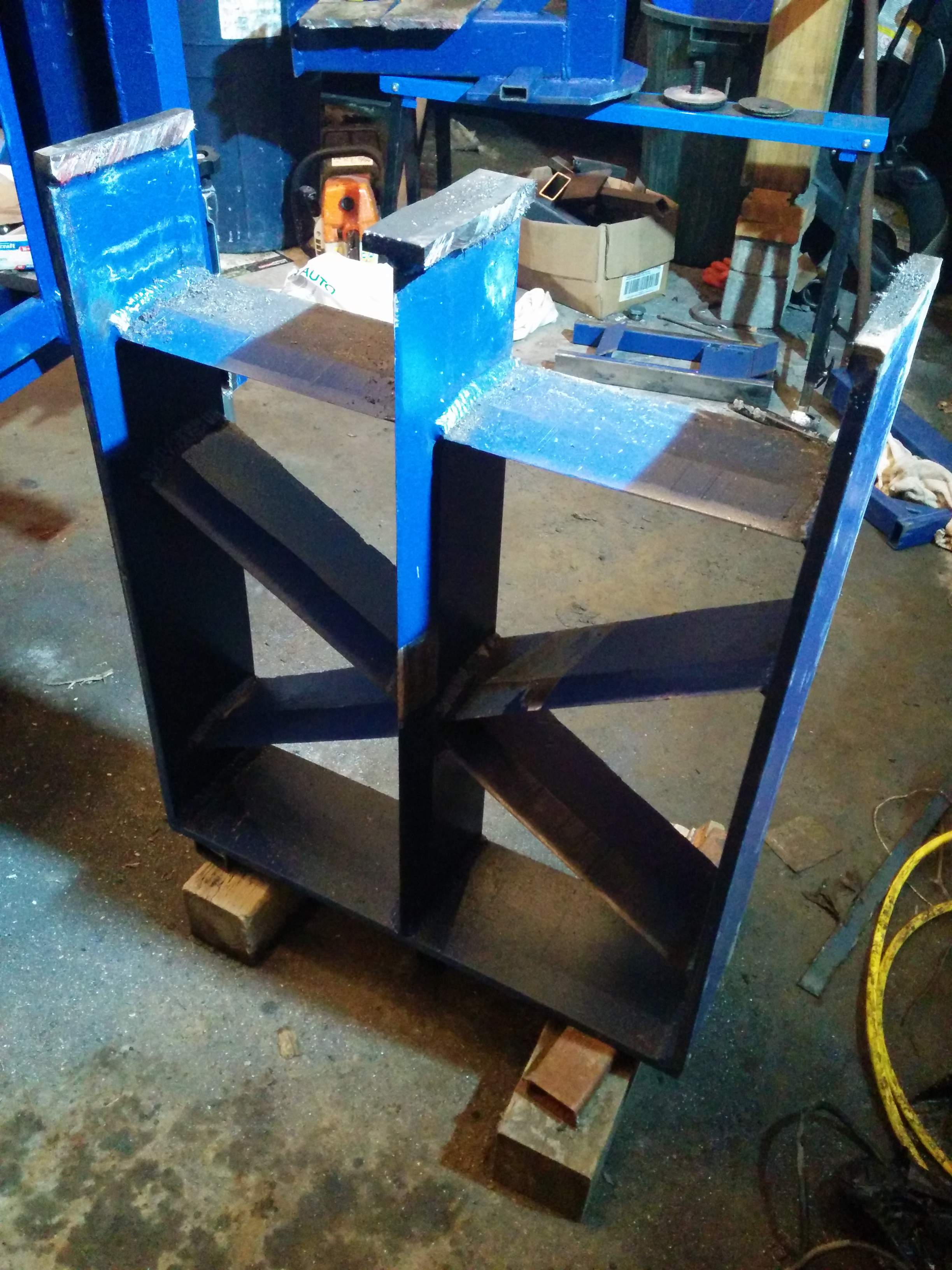

How thick are your blades going to be? I really like mine at 1", but 1/2" might have worked much better.
The center wedge is 1", the all multi-wedges and the box are 1/2"
The main wedge is 6" deep and the same is true of the box. The supports on the back side of the box add another 2" to the depth. Those box supports could easily be narrowed up.

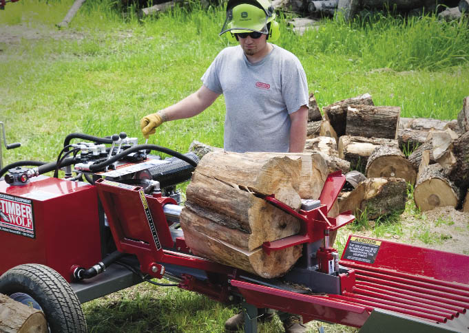

Many of the Timberwolf splitters have little wings on the wedges. Is this to keep the wood from spreading out or is it to assist in the splitting?

I believe those wings are to spread the wood and help with the split. They're basically trying to get the wood to pop.

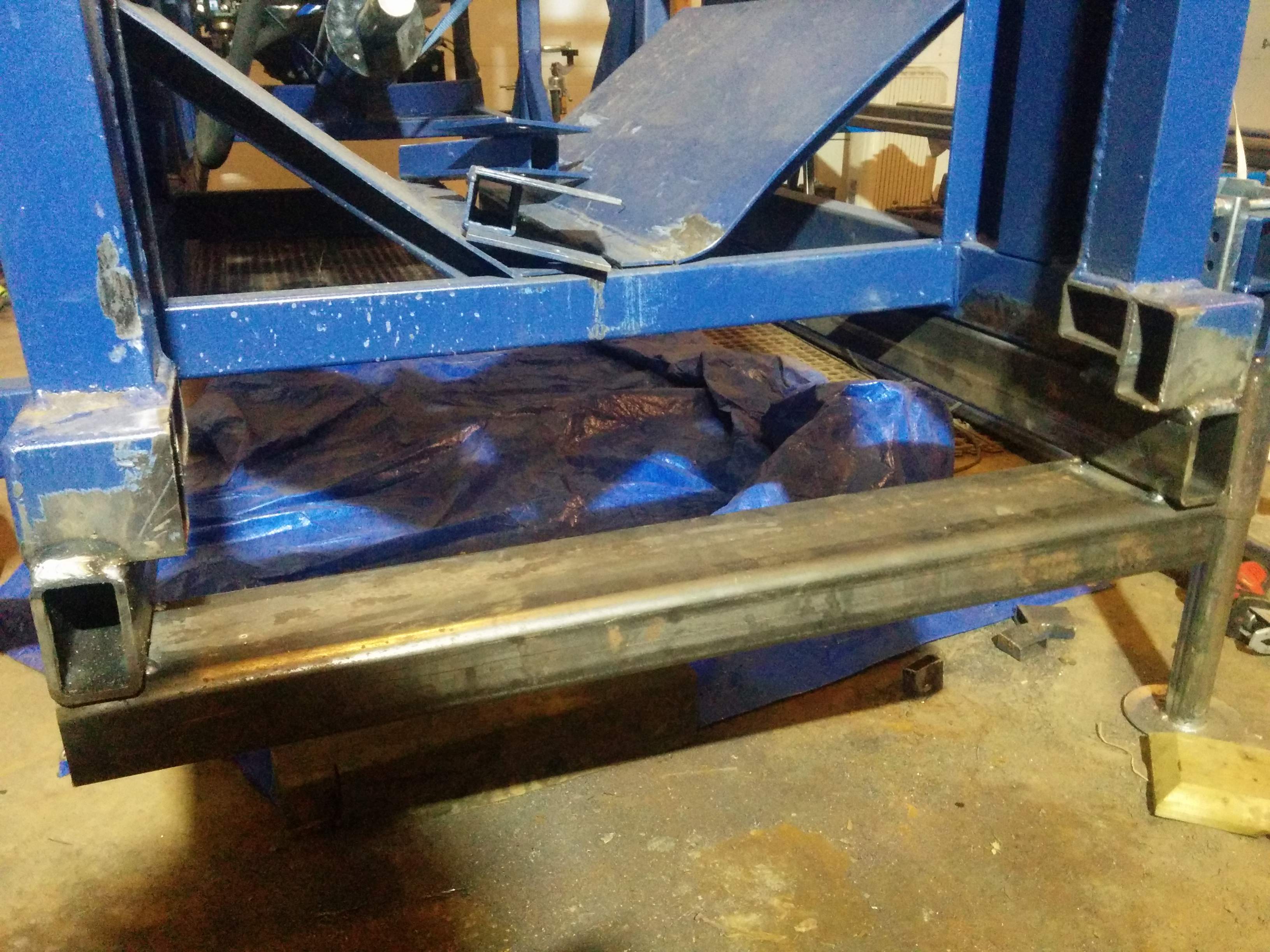

Not much on the design unfortunately. I've been away the last 2 weekends and will be away again this weekend.
The other guys in the crew welded up the infeed rack and the framing for the trough while I was away.
I'm hoping to get into the splitter and splitter trough re-designed some night soon.
