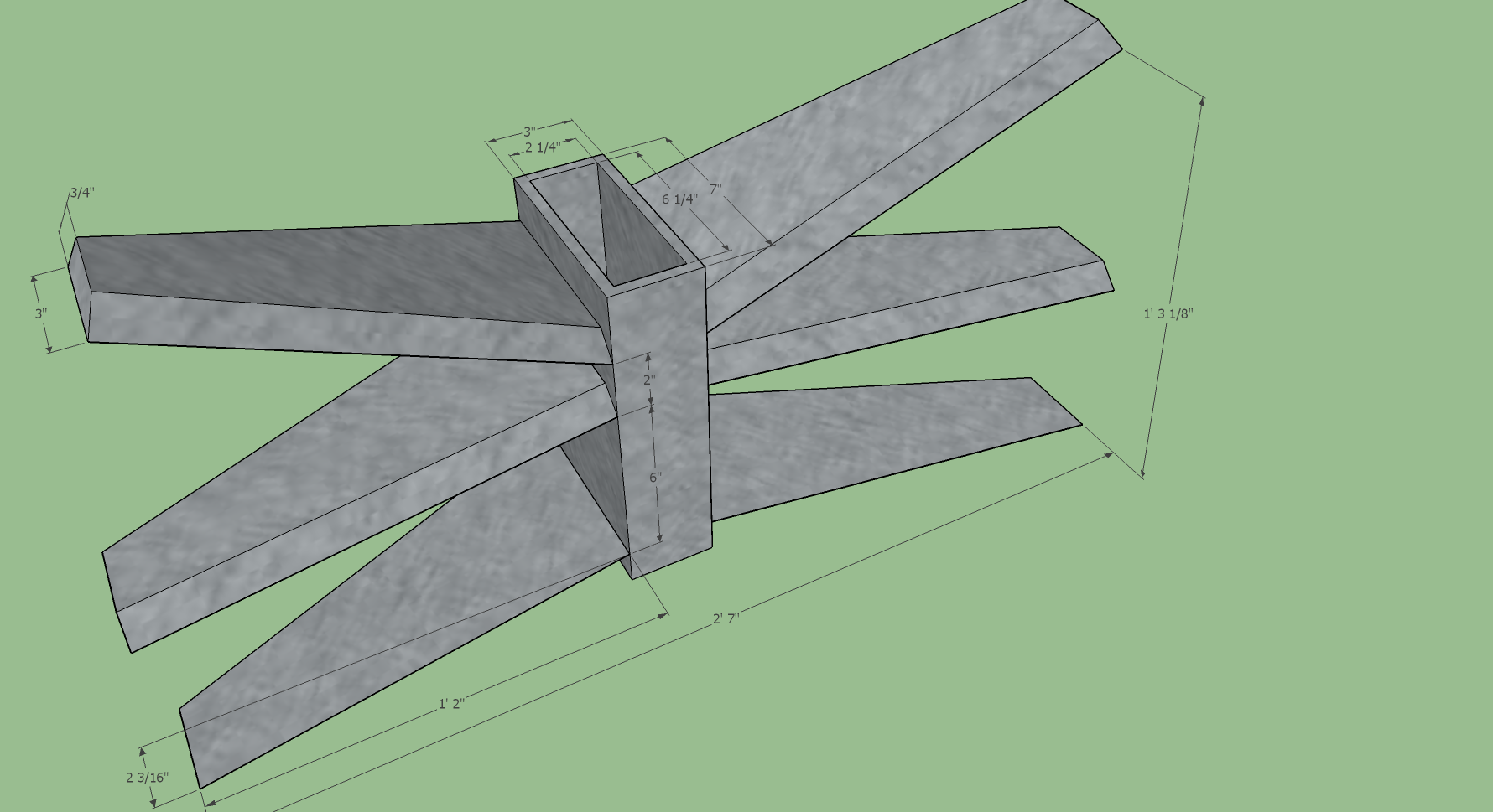

The two 50 lts/min (13.2GPM) and 66 lts/min (17.4 GPM) gear pumps exceed 5000 PSI (!!!!) and still not achieve the 10 cm (3.9" that should develop 30.4 tons @ 5000 PSI) diameter piston to split eucalyptus with a 400 mm (15.75") diameter into my 8 edges knife ..can anyone help me with this? :) (a picture of the splitter cylinder and wedge would be helpful)

I made notes in red. Changed units for those of us not used to metric. I would say that we really need information about how the two pumps are used to split. We need pictures of the wedge to see how the log will spread out as it is split. Is the wood green or is it dried out? I read that eucalyptus is more difficult to split when dry.
Off hand I would think the splitter would work at 30 tons but it all might depend on the wedge design. Also if there is anything binding in the splitter travel.

If the knife edges are not staggered, I would not be surprised if there was difficulty in splitting. And just because the pumps are rated for 5000 psi does not mean that is the pressure they are generating. There could be a bypass at a lower pressure than that.

You may have already posted this but if you did I missed it but what are the sizes of the pieces you used to make up that wedge? What is the overall height and width of the finished wedge?

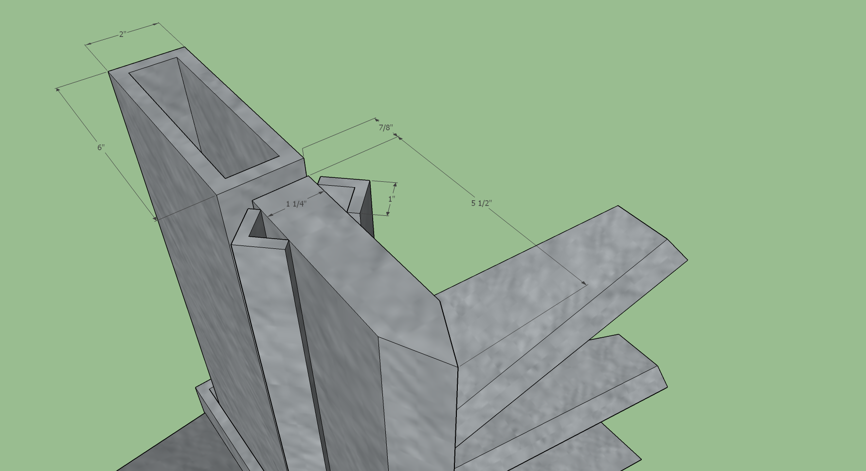

I don't know that I've really spelled out what we did since the design change moving away from the box.
Dimensioned images of the wedges are attached. The main wedge is 28" tall.

Thanks that is very helpful. I'm still gathering pieces and parts but I would like to start work on some of the parts that I have pieces for like the wedge, hydraulic tank, fuel cell, along with some other stuff like brackets for the pumps and motors. I got rained out the other day and I decided to start working on the wedge. I have a piece of plate that is 24" long by 18" wide and 1 1/4" thick that I was going to cut up and make the main piece out of but decided to wait until I could check some other wedge designs to get some measurements off of before I cut up this nice piece of plate. I'm planing on hopefully being able to get two out of it and maybe playing around with another configuration to see what else I could come up with.
I wonder how this design will work out with larger wood.....say like 36" or more? Most of the wood I have is 18" to 26" or so but I do have some really big stuff on the ground and I also have several really large oaks that are dying and will have to be cut down soon.
Sorry for the late reply, Are you asking about our exact size and design or the design principal beefed up and made larger? We are already a bit scared as to what this thing might do to the beam with the wedge sitting 24+ inches above the beam. It is one big lever! I would not want to put anything larger on ours unless we boxed in the beam on both sides. Maybe also having a solid attachment point above the wedge that really helps to distribute the load.
Note: We haven't run the machine yet. Maybe I'm overly cautious, I have not had any structural calculations run on the frame. Just asked some people that said, "Yeah that should be good"
