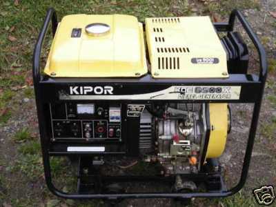

The well is on a "big" breaker that was 20 Amps. I *** THINK *** the well breaker is on 220v. The generator is on a 30 Amp "big" breaker as well. From the talk with the electrician he setup the generator plug to supply 220v.
The generator is rated at 30Amps at 250 VAC so I think I am ok.
