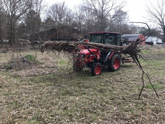

I am getting a branson 4820HC. Heavy for its class and lift capacity of 2700. Dealer is trying to sell me a 66 inch wr long grapple. It weighs about 670 pounds. Grapple will be for clearing brush and lifting logs for a mill I have. Too heavy? I'm struggling to decide. Dealer says I will want the heft as he sees lighter 300 to 400 lbs grapples get bent.

Yes. 2700 at the pins. Will be running fluid in the tired and 900 lbs at the back for additional ballast. I would keep logs to 10 feet long and perhaps 18 to 24 inches

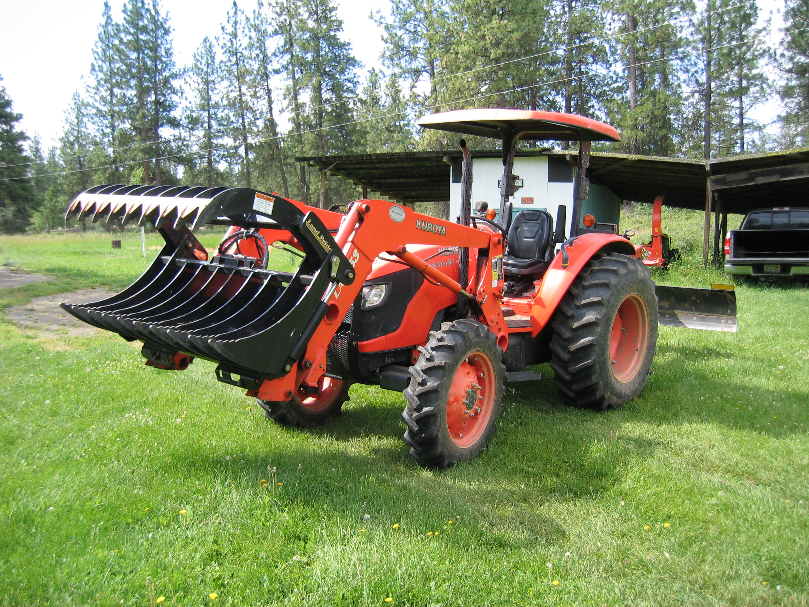

I have a Land Pride SGC1560 on my Kubota M6040. It VERY HD - made with AR400 steel and weighs 820#. A couple reasons I chose this grapple. It's not going to crumple up when I use it. Soo... Buy once/cry once. It WAS an expensive grapple along with the WR Long 3rd function valve. And - it was available thru the local Kubota dealership. Any after sale service is an important factor to me.
I DO NOT lift heavy "things" up high. So...... this means I can lift a 3000# rock or chunk of tree trunk just off the ground and move it. At this weight I can lift to a height of around 30". As with all lifting - the higher you lift - the less you can lift.
I've had this grapple for seven years. Only "damage" - the paint keeps wearing off the tips of the teeth.
If I were to do it again - I'd buy the same grapple and 3rd function valve.

I have the W.R. Long open bottom, 2 clamshell grapple on my MX5200. I have never tried to lift something that wouldn't go, and the times I did it was ballast limited not loader capacity. It has been a great grapple. Great for brush. The longer tines on the bottom let you dump the bucket down and come down and in on a pile to let you rake it up as you go.

Well for what its worth I have had a 48" Wildkat Economy grapple. I got in on ground floor 9 years ago and paid 700 bucks delivered to Mass. Only issue I ever had was I was trying to "hog out" a buried bolder by opening all the way and digging with teeth while trying to roll back with grapple locked onforward edge of rock I cracked the welds where cylinder is attached to box beam. Cut a couple of 1/4" thick wedges and welded on-end of problem. As my avatar shows you can get a lot of firewood on it Like you, I use it for clearing brush as well as bucking logs. I'll take the weight savings (350lbs) any day vs lost payload with a heavier, wider grapple.

I recommend a Hound Dog Grapple from MIE. I ordered a 48" in custom color to save weight and I appreciate the lack of width more than I feared it wouldn't be enough. IMO it's not gonna break if it hasn't after 5 years of tractor tipping use.
That said I rarely move 10" logs >16' long or way-thicker ones much > than 6-8'. My loader is weak for size, but I can curl to get heavy rocks just up enough to skid them. Most anything I can lift at all I can lift to near full height, always enough to load on a trailer or into a truck. (Not my job to unload)
Note that the cyl base pin and lid pivot shaft are anchored to extensions of the teeth vs to welded-on brackets. I have a hanging scale and can weight it off the pallet next time I hook it up. It tends to stay on my #1 tractor for the Summer, switched only for the other grapple. (tree Puller)
