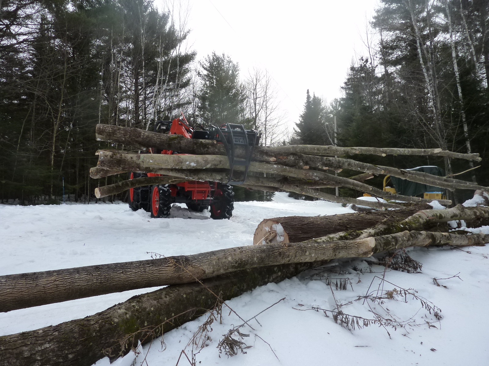

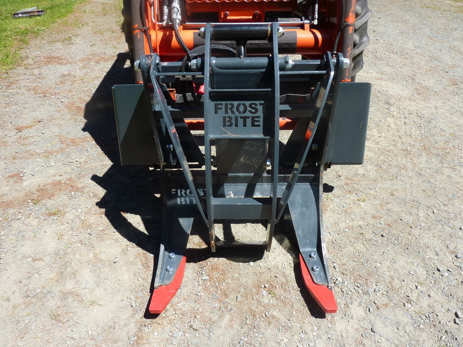

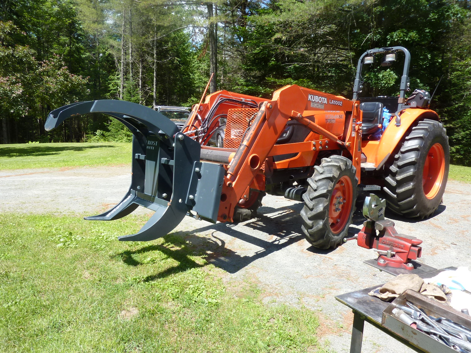

I'll second what Gordon said. Clamshell grapples get a lot of love here, for good reason. But, that often causes individuals to just buy what everyone else has, without considering their specific uses.
I almost went down that path, until my dealer suggested a Frost Bite style grapple (I got one made by Sundown). I was looking to move logs, and rocks. I am SO glad I got the style I did.
It's less than 1/2 the price of a clamshell type, and weighs about 1/2 as much (preserving your lift capacity).
As Gordon mentioned, maneuverability is key. Unless your log sits on a flat open space that is at least as wide as your grapple, you're going to have a hard time picking it up. You'll catch the edges of the grapple on high spots on the ground, rocks, or other logs. Or, you'll be forced to pick up the log using only one end of the grapple, risking torquing it.
When moving rocks (a major use of mine) the ground has so many rocks that I would never be able to get under one, without the edge of the grapple hitting, and getting hung up, on another one.
If you have wide open woods, this is likely not a problem. If you're like me and have dense, tight woods, with rocks everywhere, it will be a major headache.

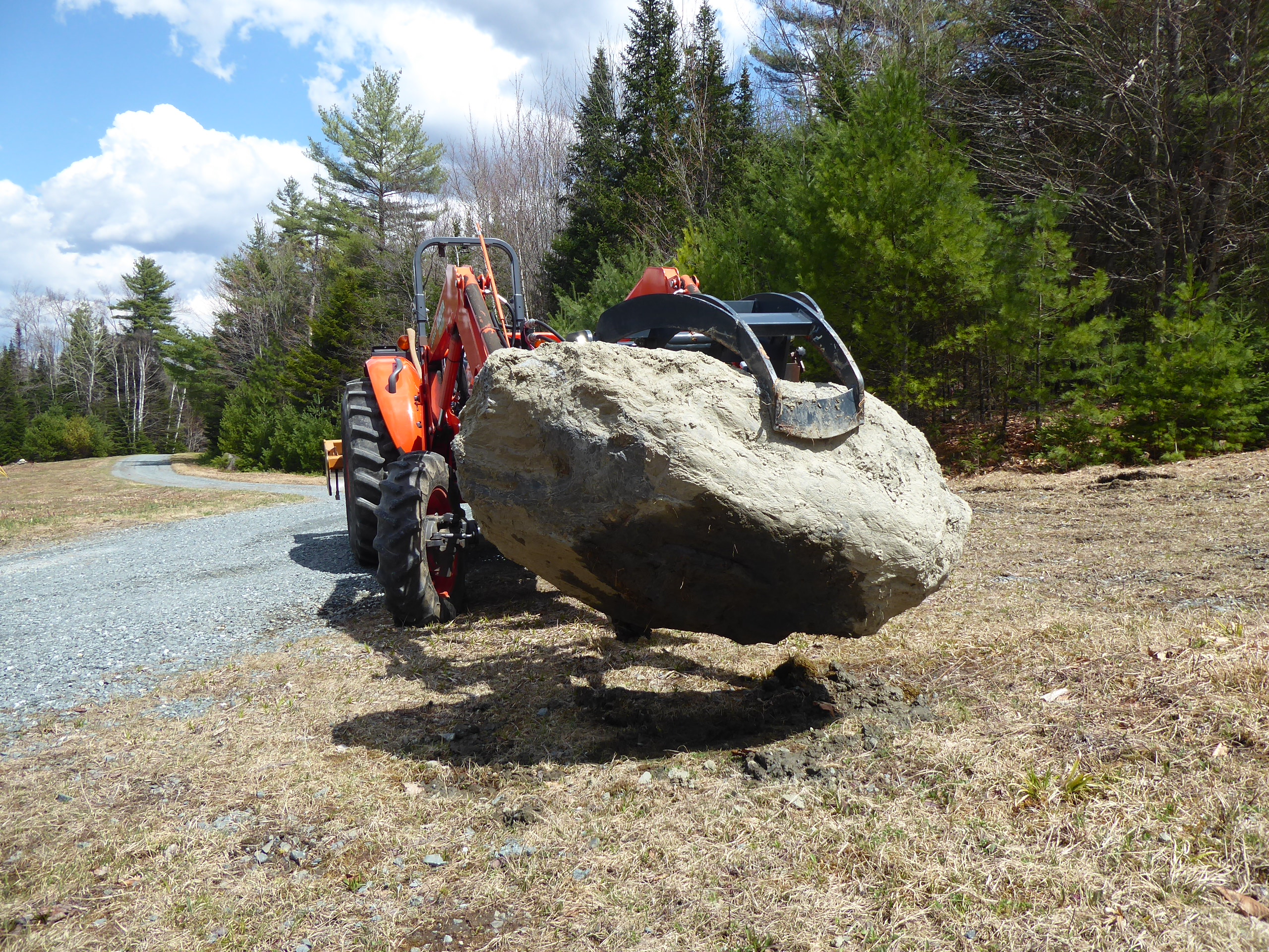

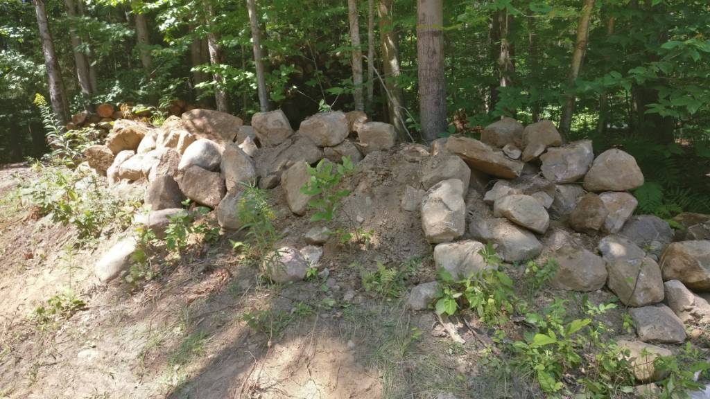

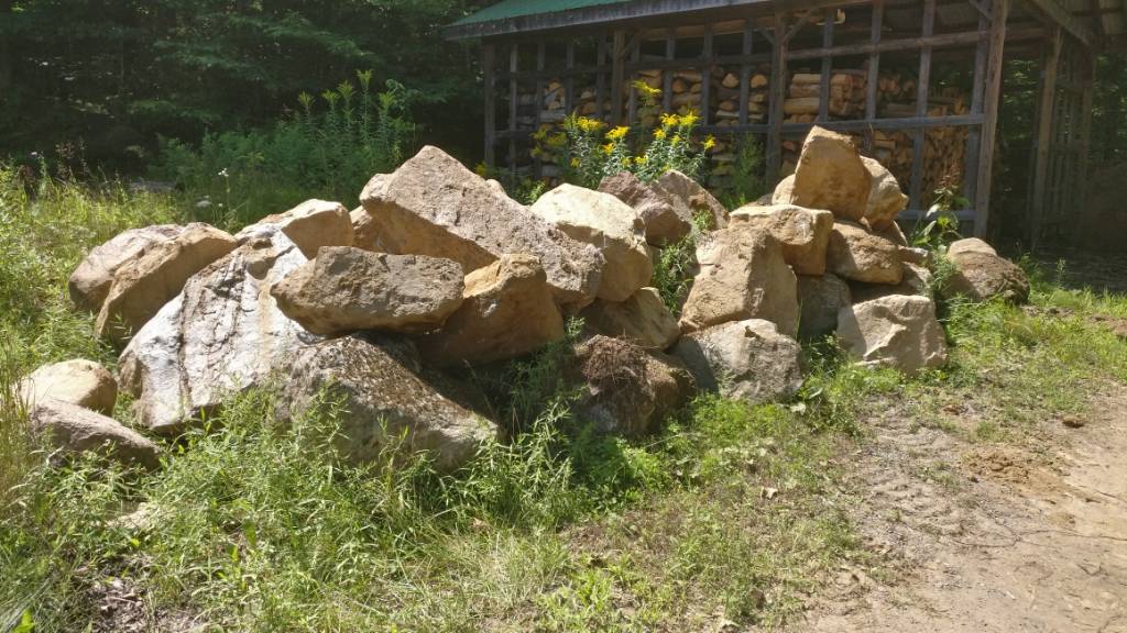

   / Grapple for Working in the Woods #16
Here's an example of what a frost-bite style grapple can do. These two piles of rocks were dug up out of an area measuring about 50 ft x 20 ft.IMG_20200824_172129.jpgIMG_20200808_130039.jpgIMG_20200808_130051.jpg
After seeing the suggestion about the Frost Bite style grapple, I did a little looking at how it works and decided for my application, I think the grapple rake would be a better option mainly for the "raking" of small brush and roots. I do have lots of tree and smaller rock that the Frost Bite would work well on but I lose the other capabilities.
I do appreciate the suggestion though and getting to see other options is a very good thing.
   / Grapple for Working in the Woods #18
America...the land of choice!
Lots of good grapple designs out there.
It's been said that some on TBN are EA bigots. Before joining TBN, I couldn't even spell EA - now I are one.
EA being 12 weeks out for delivery might be a subtle indication about the demand for their product. And it's not just TBN'ers creating that backlog!
Likely you will end up using it for a large percentage of your time, so no matter what brand or size you buy - get quality.
Just a few thoughts related to size and wider vs narrower grapple.
The following is simply just another view of this wonderful world.
When picking up a 16 foot log, the wider the platform I have, the more stable the load will be.
As an extreme example, imagine trying to find the balance point on a 16 foot log using a forklift - where the forks are set 12 inches apart.
Then imagine carrying that 16 foot log on the 12 inch platform without the ends of the log teeter-tottering wildly up and down.
Then imagine the same activity with forks set 5 feet apart...it's far easier to find balance and stability when using the forks set wide.
Sure a grapple has a top to hold a load on, but personally, I still want a wide, stable platform to make finding the exact balance point on every log less critical and to limit end bounce during transit.
And when cleaning up slash, again just personally, I want the widest - biggest bite of limbs I can carry. Many times, I can quickly pick up and stack two or three smaller piles together and then get a bite of the whole bunch to carry off to the slash pile.
Much of the work is limited more by size of the bite, rather than exceeding weight limits of the FEL system.
One last point, again, just personal. I will purposely not overload or try to max my FEL weight limits just to move logs.
I am not operating a dedicated - built for purpose log skidder...it's really just an ol' Kubota field tractor. I will pick up nearly any reasonable sized log, and often 2 or maybe even 3 at a time if they are 12 or 16 inch diameter logs and not too long.
I don't have a need to move 36 inch x 16 foot freshly cut oak logs for a mill.
Others on TBN do mill and are cutting down 80 and 100' trees for lumber, so they have different demands than I have.
I just cut my big stuff in half and make two trips!
My objectives are clearing overgrown pasture, cleaning up and gathering firewood from the wood lot - and making my tractor last until 2056. I'll be 100 then, and maybe won't need it for gathering firewood any more.
So I'm conservative on not overloading the FEL with excessive log weight...but I DO want to pick up and handle the most brush and slash that I can at any one time.
The majority of my work is more limited by size of the grapple bite, not weight limits of the FEL.
Bigger is gooder in my book!

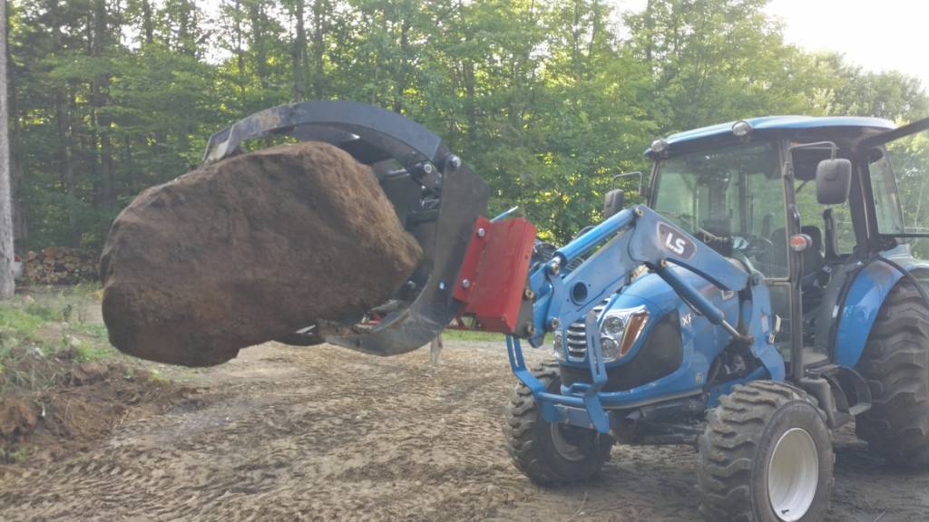

   / Grapple for Working in the Woods #19
Here's a nice thread on the subject... Which Grapple? A Guide
Another discussion, with quite a few guys chiming in.. Which Wicked Grapple?
I will say that the 240 pound Wicked 55 is the most popular, compact tractor maximizing grapple EVERY created!!
I'm glad to chat about it on the phone anytime, to help you or anyone else choose the best grapple for your tractor and application. 828-464-1200
Travis

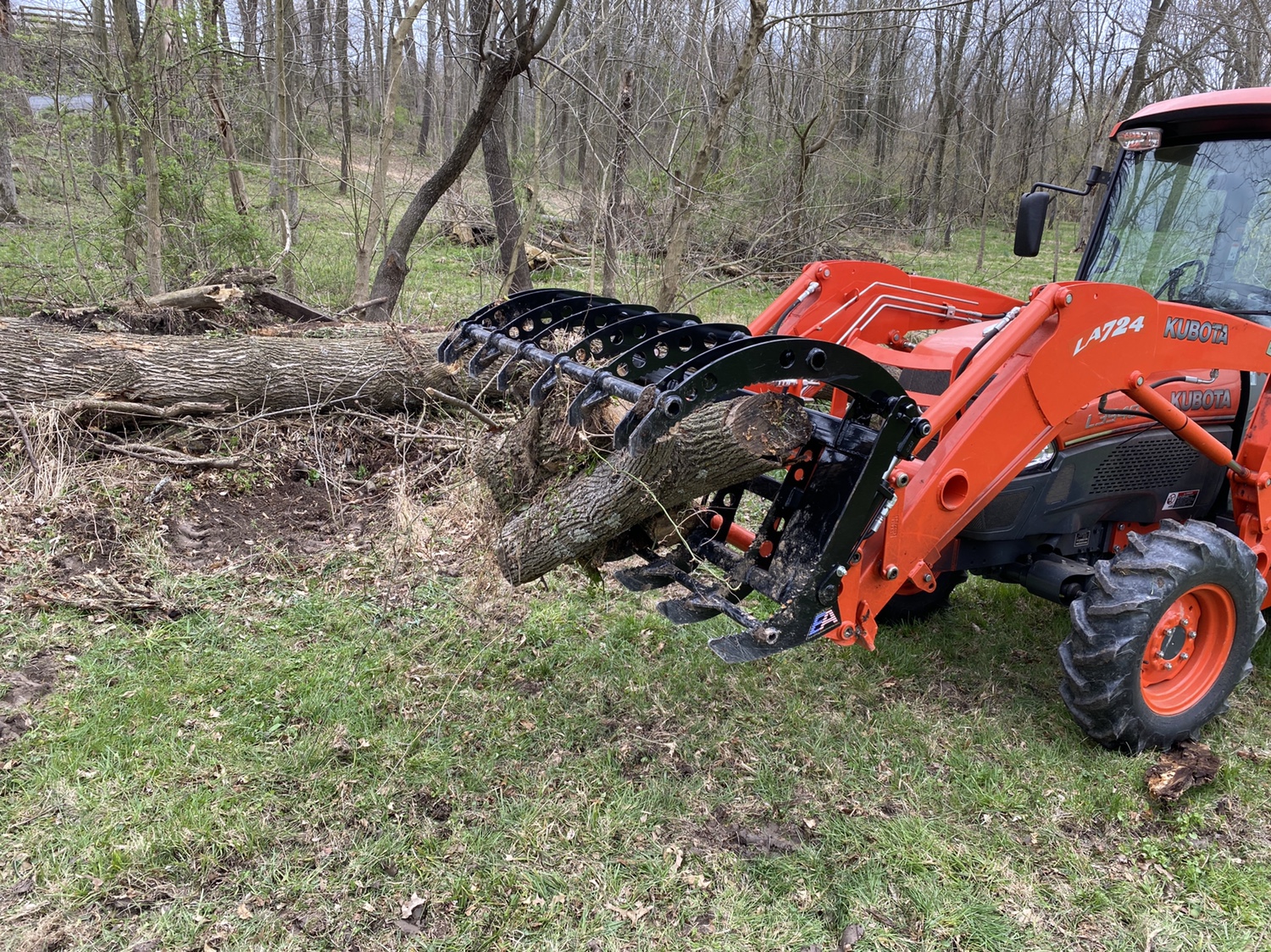

I respectively disagree with your physics. If you pick up a log off center the width of your grapple has no effect on the stability of the load. At least that is the case if the grapple actually grabs the log and it is not just laying in there rattling around. It is not like a set of forks where an unbalanced load will tip up on one end. With a grapple the log is pinched tight and acts like a solid part part of the grapple. The unbalance and torque on the loader arms will be the same weather the grapple is 6' wide or 2' wide it just depends on the log. If you have a strong tractor you can handle a lot of imbalance.
All I am trying to say to the OP is if you want to handle logs easily and efficiently you can't beat a log grapple. And a FrostBite is not a wimpy unit.
And as RSR says it is great on rocks too
