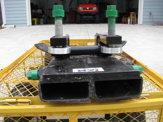

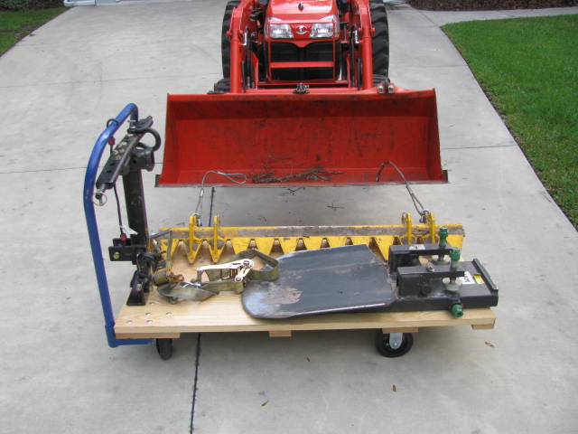

I have a $400 Bucket Spade. Mounted on the bucket of the Deere 4320 Bucket Spade will accomplish 40% of Backhoe tasks.
Do you have enough work to justify an $8,000 Backhoe rather than a $400 Bucket Spade?
You need to remove the Backhoe to access tractor Three Point Hitch.
LINK: Tractor and Skidsteer bucket spade shovel

4. Your idea of the Bucket Spade is amazing. Big thanks! I've never even heard of it. That would absolutely be plenty for the beginning and would likely allow me to put off the backhoe purchase, probably indefinitely. Were I to have a very large job, probably should just go back and rent a mini-ex.
BTW, the post & tree puller is also impressive and further shows I don't need a backhoe:
Tractor Forks, Bucket Forks, Loader Forks

4. Your idea of the Bucket Spade is amazing. Big thanks! I've never even heard of it. That would absolutely be plenty for the beginning and would allow me to put off the backhoe purchase.
VIDEO: tractor bucket spade attachment - YouTube
The other wonderful bucket attachment for woods work, light grading and opening a small garden is a Ratchet Rake, which can be purchased "drop ship" through the T-B-N store, button at top of this page.
~~You may want a Backhoe....eventually.
VIDEO: ratchet rake - YouTube
LINK: Ratchet Rake site:tractorbynet.com - Google Search

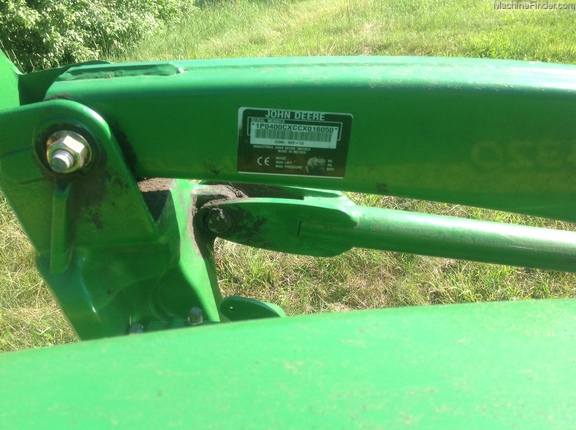

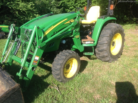

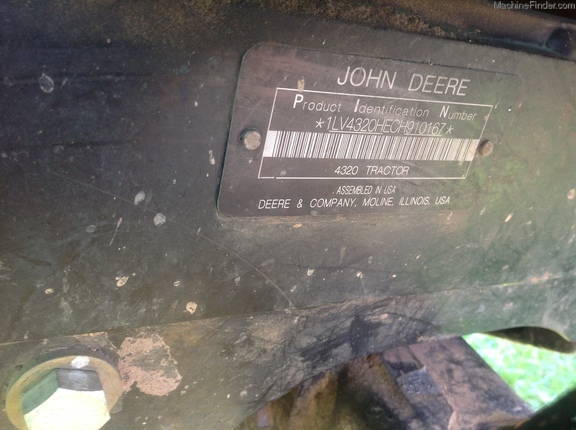

The JD4320 is from 2012. I'm attaching images from the sale site on the off chance there's any other useful information there.

That's a self leveling loader on the Deere. Very cool. It keeps the bucket at the same angle as you raise and lower the loader. Few CUTS have it. Without it you need to pay attention to the angle of the bucket and move it as you raise and lower it.
For example when using the bucket to rounds of wood into a trailer I have to tilt the bucket down as I raise the loader so the wood doesn't roll backwards out of the bucket and land on the tractor hood or the operator.
There's more points to grease with that mechanical self leveller and more to check for wear but I'd gladly take that to get the feature. The capacity may be less than a regular loader, you'll want to make sure it's got the capacity for your needs.

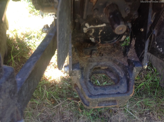

ERICM979: Is that a pintle hitch in OP's Photo #3?
On my Kubota the rear/center drawbar is in that position.

yea it is a pintle hitch. Not clear from the pic if it's removable. The drawbar on my Branson is removable and can be set in a couple different positions. When I am pulling with it I set it so its extended, to reduce the lift the front and roll over effect. Not that I've gotten close to lifting the front but having seen the videos and met a paraplegic from a tractor rollover I'm being cautious.

Looks like SSQA bucket on the JD. Hard to tell for sure. That, to me, is preferable to the JD proprietary version. That 4320 looks like an honest tractor, meaning the appearance is appropriate for the hours. Nice grille guard, self leveling loader, overall decent shape - those are good signs of careful ownership. How much are they asking?
If it checks out, I'd buy that machine for the same money as a new L3901 ALL...DAY...LONG.
It was interesting reading posts about using Rimguard (sugar beet byproduct) vs antifreeze/water vs RV water antifreeze vs windshield washer fluid vs axle weights. Will need to look into this, but not a deal breaker on used vs new if it's not in the JD4320, as it certainly isn't in the L3301 new. Funny thing is I'm seeing posts from some saying manufacturers don't recommend filling tires and also posts talking about maintenance on filled tires being problematic. I have no data either way, but random internet information can be as confusing as it is helpful. It seems the majority of posts favor using filled tires and I even found reference to tools that would let me fill tires myself, albeit losing some of the density provided by Rimguard.
Got sucked into reading about tire filling and the tangent took me into a realm I'd never thought about -- rear ballast. I do plan to do heavy lifting with the FEL, so I'm glad I read more about the need for ballast. Some folks have been pretty creative when coming up with ballast, so it's great to see ideas. I have welding equipment, so may be able to MacGyver something for the job.
For good or bad, my land has little in the way of slopes. There are a few areas of 20-30 foot elevation change, but that's an exception and most trails cross areas of 2-4 foot change.
In the third picture that looks like a drawbar holder between the 3PH lift arms (a bit weird looking) but the drawbar is missing. Make sure the dealer includes the drawbar and pin to hold it on if you go with that tractor. You will need that lower drawbar for pulling stumps, a trailer etc. Never hook up to the lift arms to pull a stump or other heavy load as you could easily flip the tractor over backwards.
