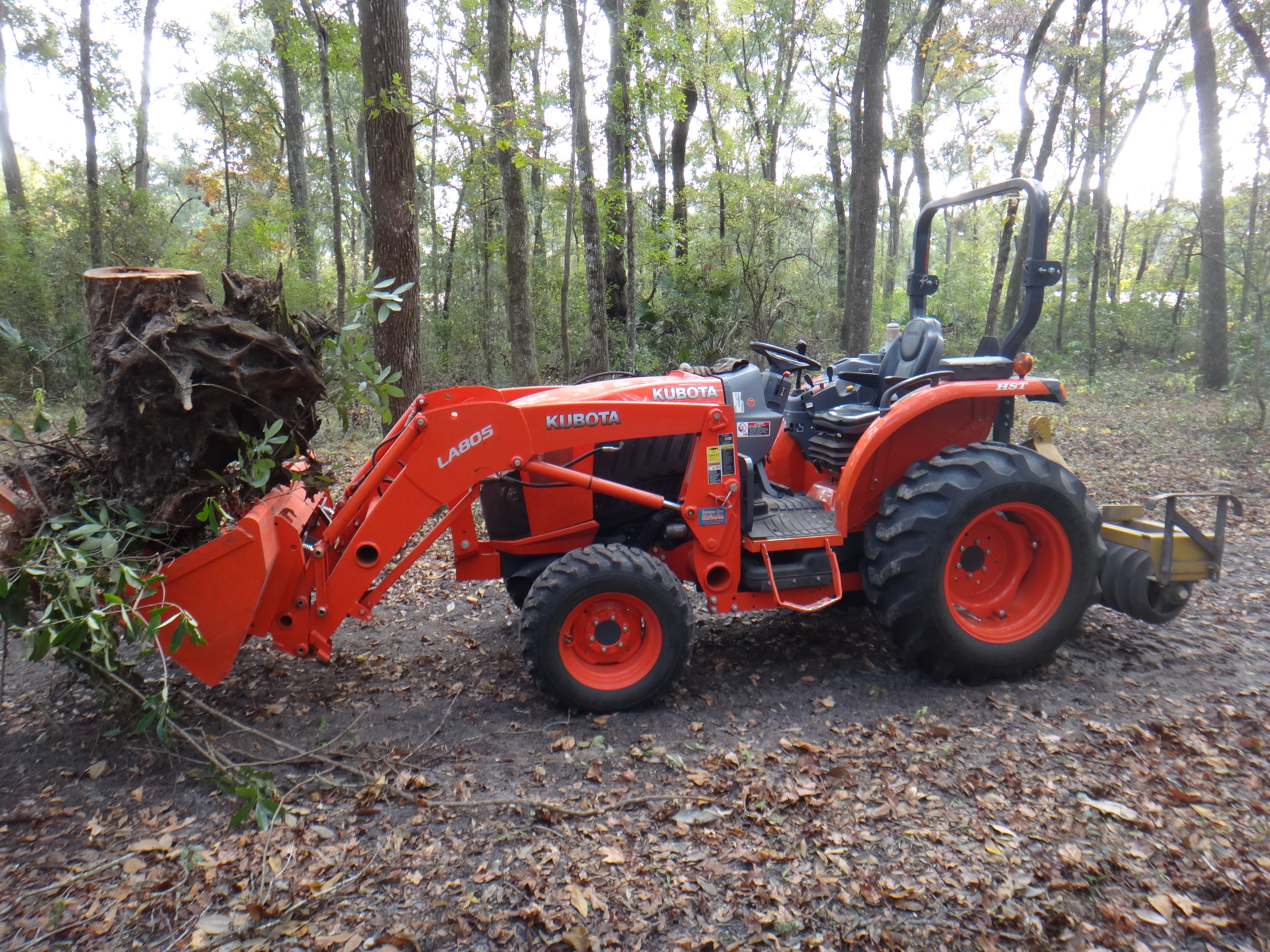

I keep a 600 pound Cultipacker on the Three Point Hitch most of the time. Cultipacker is my usual choice because it is compact. When I need to lift heavy FEL loads I mount 600 pound Box Blade, which protrudes further to the rear,
or 950 pound Disc Harrow which protrudes way.......back there, reducing maneuverability but permits 1,600 pound lifts my FEL is capable of.

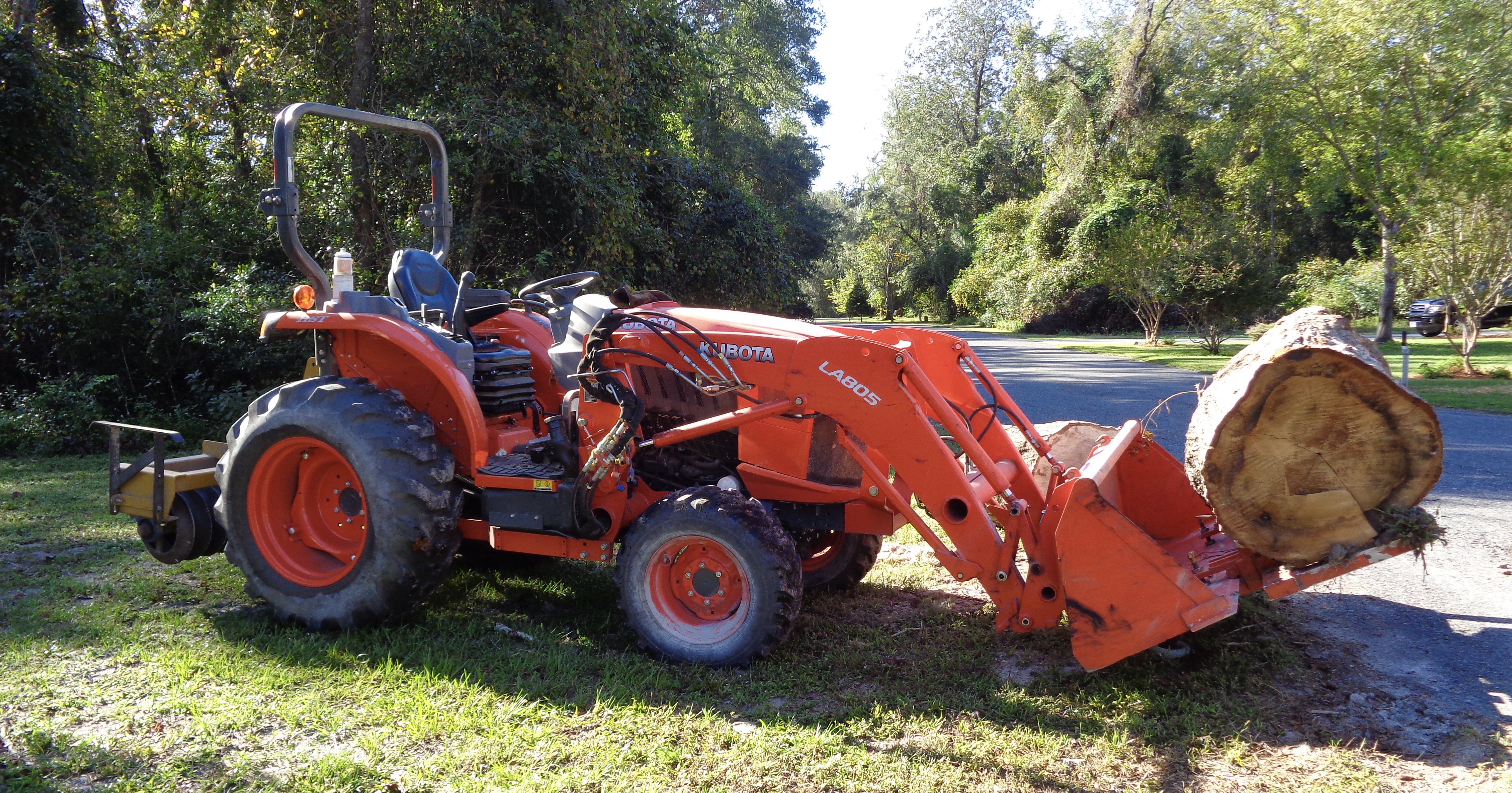

Photo #5 is around 1,600 pound lift. Rear wheels may have had 200 pounds ground contact.
Tractor reliability is primarily a factor of prudence and experience of the operator. I operate my FEL at no more than 60% of capacity most of the time. You read here often: BUY ENOUGH TRACTOR. Buy enough tractor so you operate at no more than 60% of capacity most of the time, 100% only occasionally.

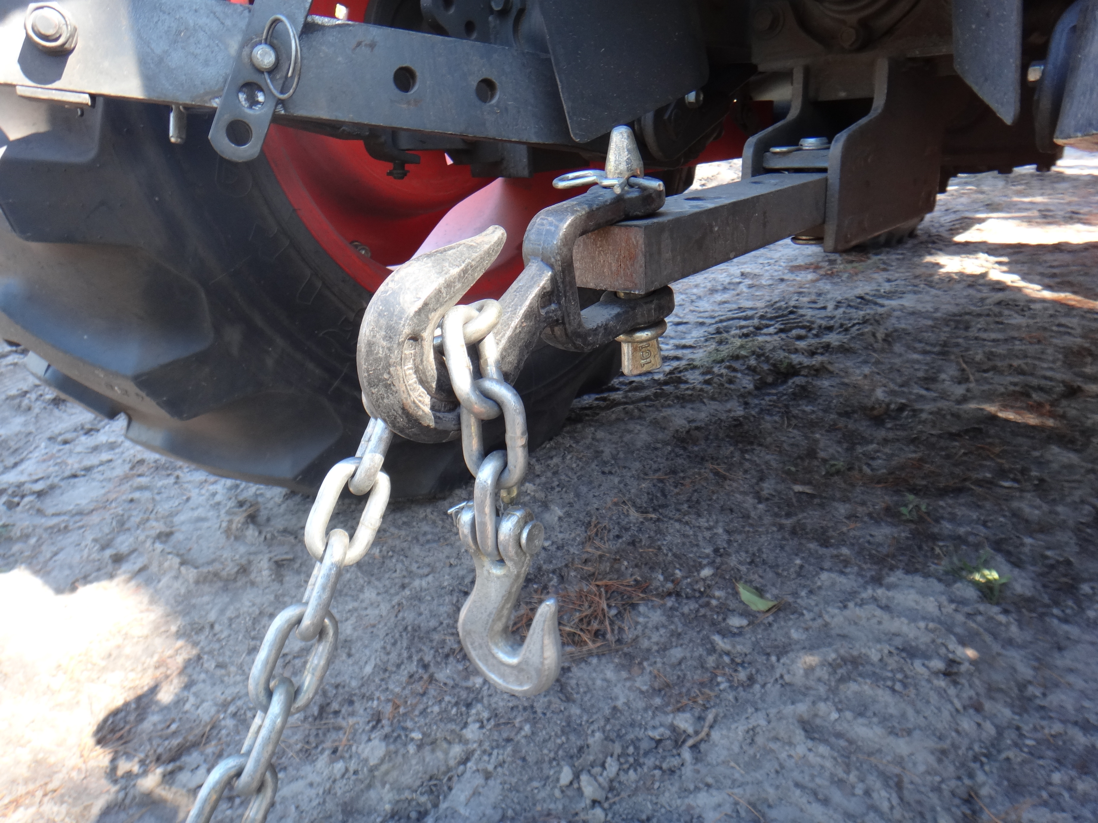

ERICM979: Is that a pintle hitch in OP's Photo #3?
On my Kubota the rear/center drawbar is in that position.

yea it is a pintle hitch. Not clear from the pic if it's removable. The drawbar on my Branson is removable and can be set in a couple different positions. When I am pulling with it I set it so its extended, to reduce the lift the front and roll over effect. Not that I've gotten close to lifting the front but having seen the videos and met a paraplegic from a tractor rollover I'm being cautious.
